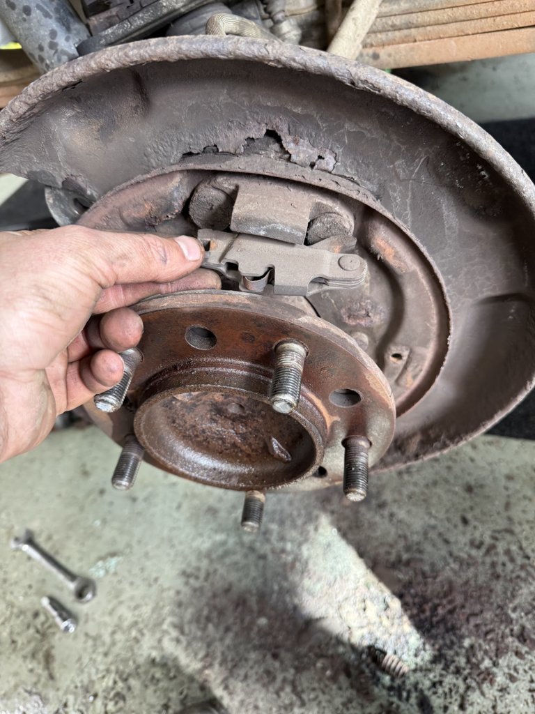

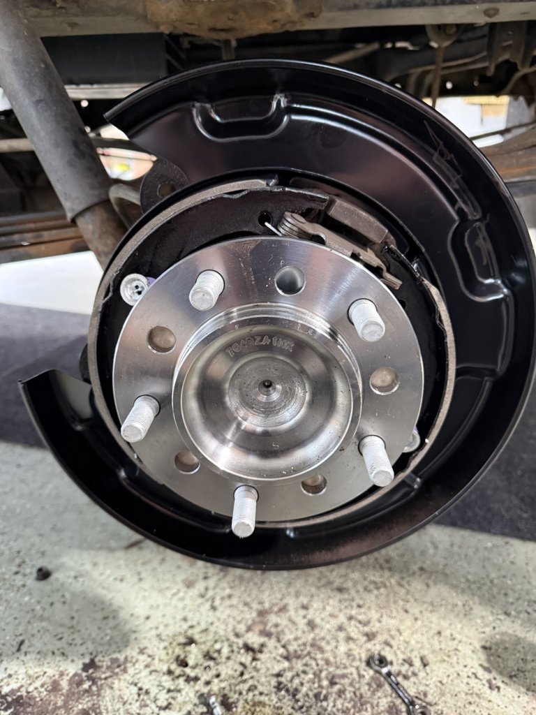

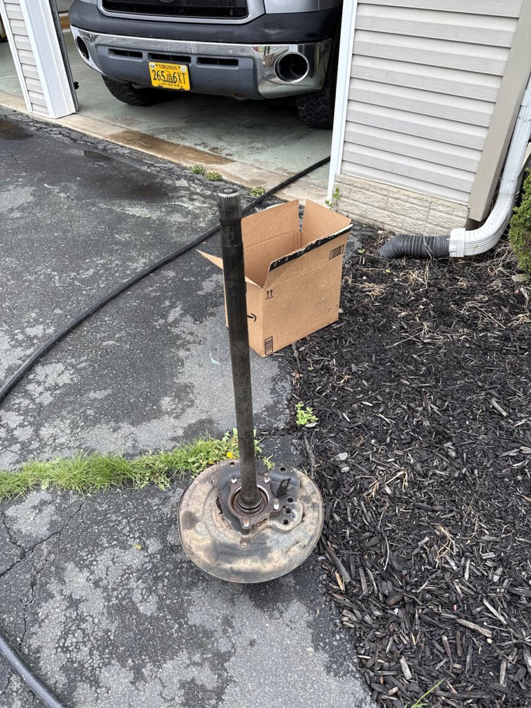

    I just did the Dormans on mine.
    I've used their pre pressed axle before on a GX470 and they held up for years with no issue. A local shop also uses them and claims to not have ever had one come back.
    My rear shields had rusted away and were causing grinding. I also had at least one bad bearing. All fixed now.
