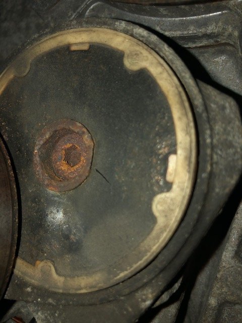

    Update..
    Took off the old belt, surprisingly didn't have any cracking the ribs, bought a new tensioner but could not remove the old one, the 6mm allen would not budge and I didn't want to risk breaking it. The old tensioner seemed fine and spun very smoothly.
    Ended up replacing the belt with the Dayco belt, it was tight but seemed fine and is nice quiet.
    Here is a picture of the 6mm bolt I could not remove.
