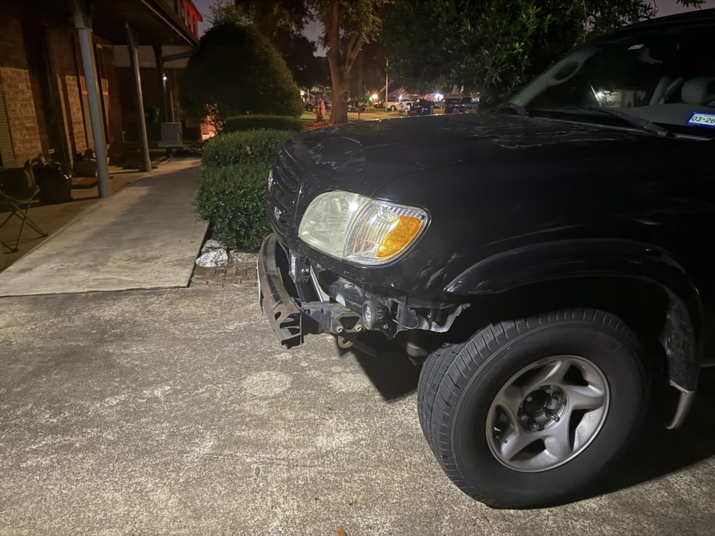

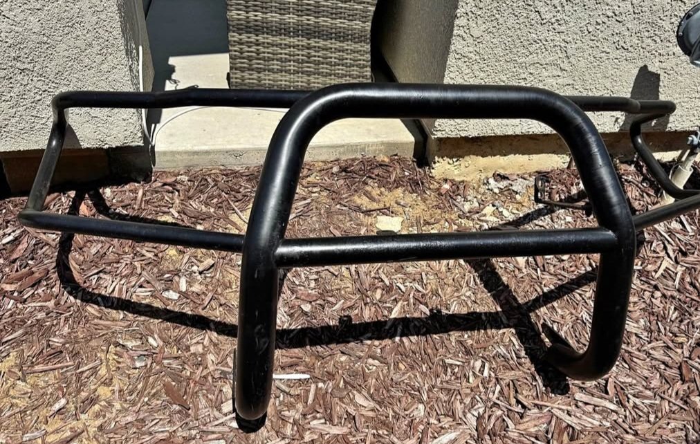

    Hi! This is my first post. I am about to buy a a 2005 Tundra. Will a grill guard from a 2002 Sequoia fit?Screenshot_20250611_211150_Facebook.jpg

    Unless it's free, you might be putting the cart before the horse there guy. I'm 100% certain that 2005 is going to need things more important than a grille damage multiplier.

    This isn't a direct answer to your question, but it is probably some useful information.
    Brush guards are used for helping moving brush out of the way and to protect against low-speed impacts. There is a wide range misconception that they are good for accidents, which is incorrect. I will list out the reasons below:
    1) During a high-speed / high-impact accident the crash energy is no longer transferred around the vehicle in the crumble zones. Instead, the crash energy is isolated to the brush guard. This is bad news for the Tundra as the brush guard mounts to the frame. If the crash energy is no longer traveling through the designed crush zones then the only place that the majority of it has to go is to the frame directly. The frame will be bent and will require replacement. This equals to the Tundra becoming a total loss through insurance and sometimes it could have been prevented by not having a brush guard.
    *Frames can only be repaired by cold-straightening. Heat is not allowed to repair frames as this causes the ultra-high strength steel to become brittle and promotes corrosion.
    2) The energy transfer bypass that occurs on your vehicle also affects the vehicle that you hit. Instead of the panels that are designed to crush to help absorb kinetic energy, you now have a steel javelin strapped to the front of the Truck. This can cause a lot more damage and injury than a normal accident.
    If you're traveling off road trails often then it may be worth your while, but if it's a pavement princess (like mine) then I would pass up on it.
