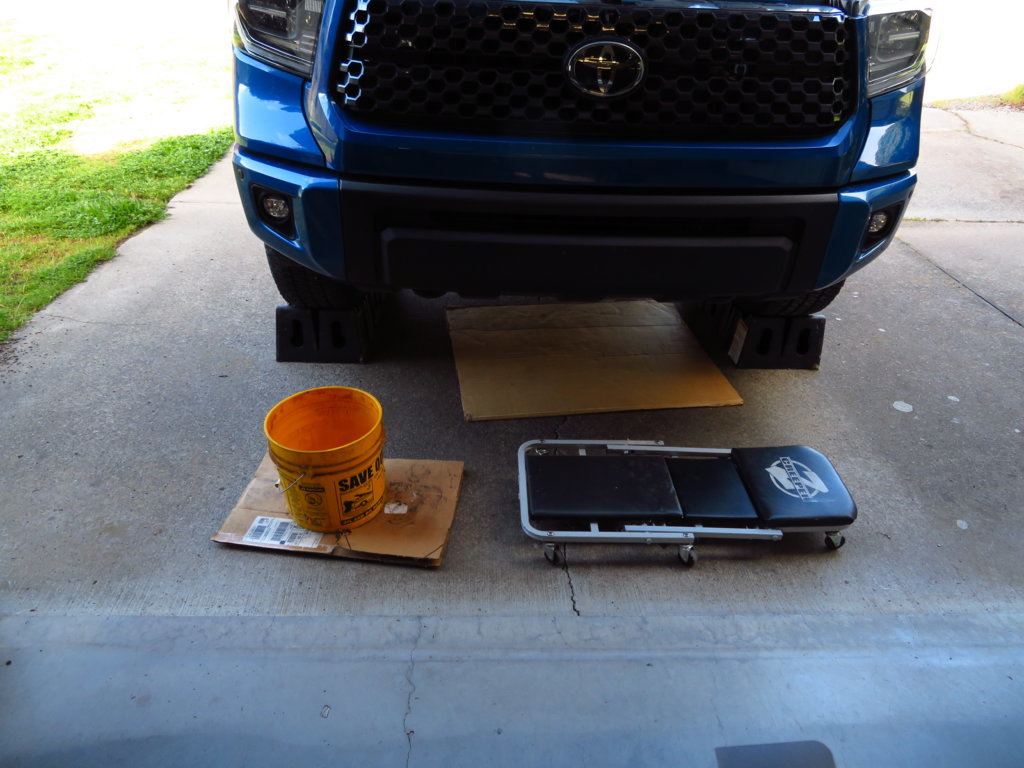

    I use ramps to make it a lot easier to slide underneath on a creeper. At 75 y.o. it makes it pretty easy.
