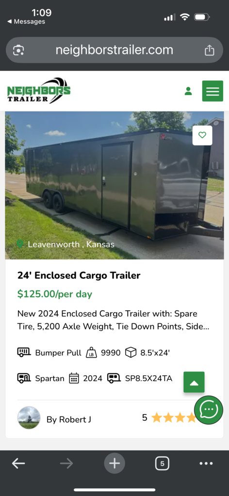

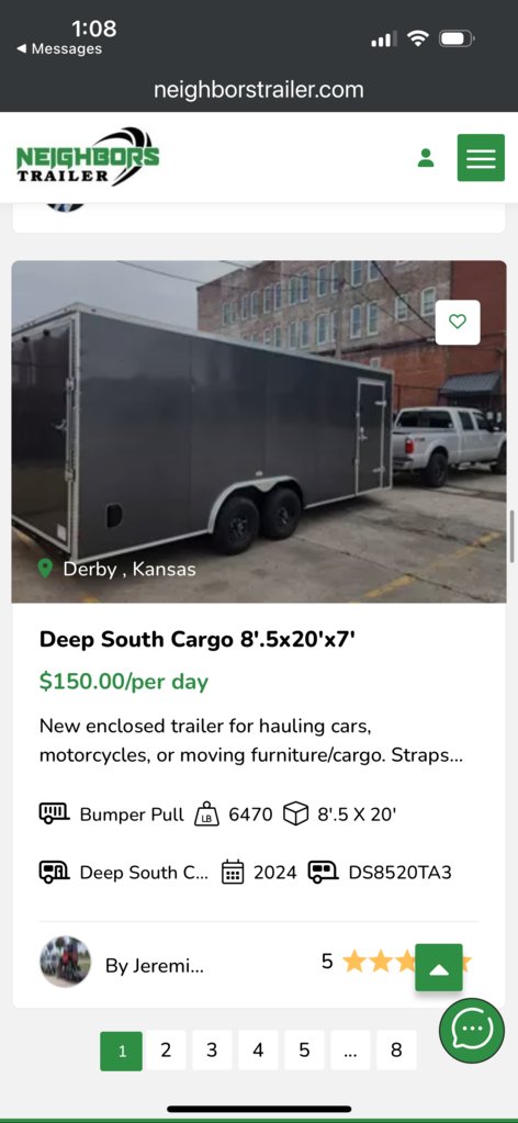

    Not sure where you are in Nebraska, but just a quick search on that linked site:
    These two are in Kansas. Might be some more local rental places. The other enclosed trailers in Nebraska are 16'.
