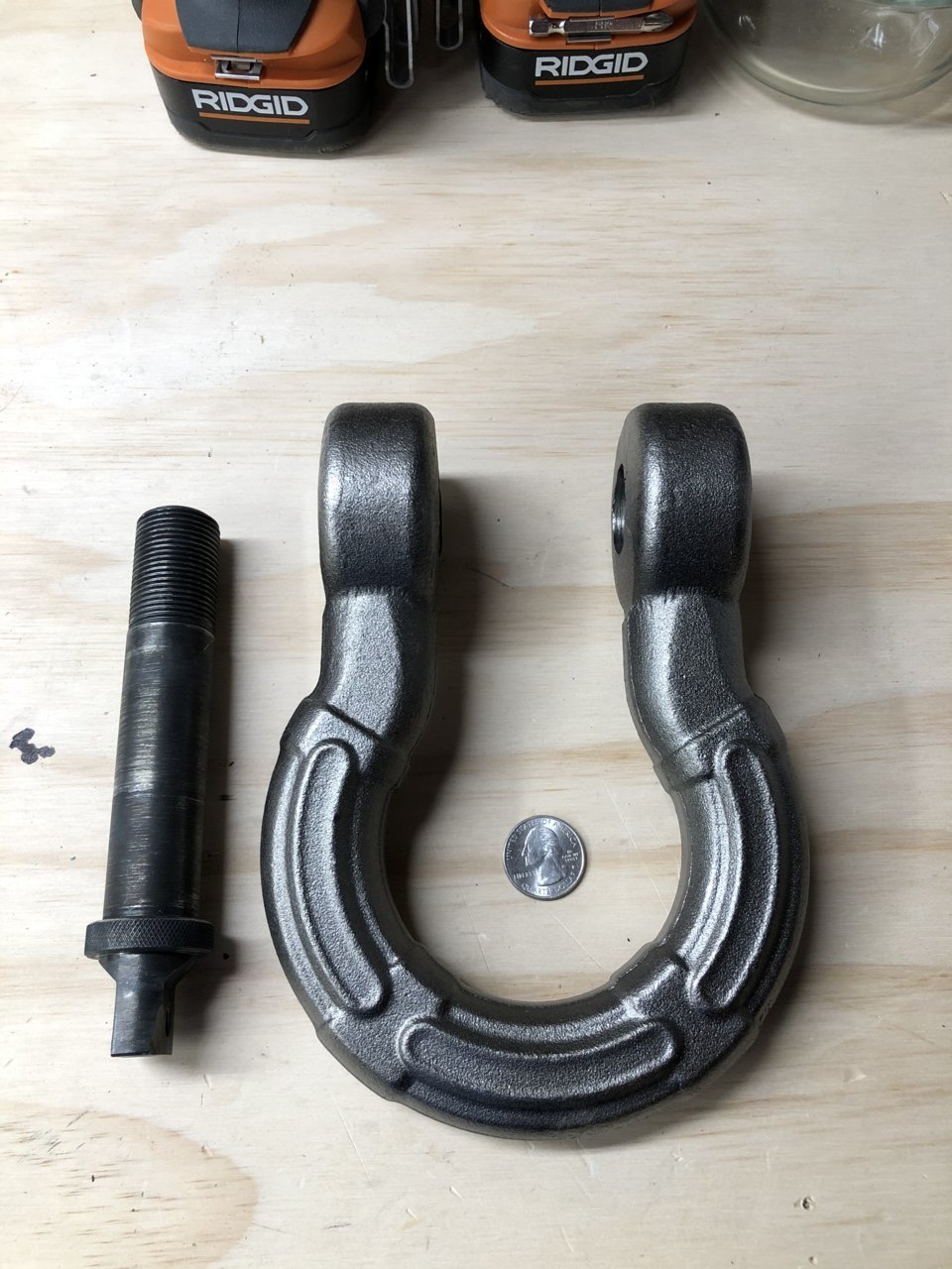

    Besides a lock, you could jam-nut the piss out of it. Don't tighten the nut against the receiver, just snug. That way the jam-nut will still spin the bolt and they'll need at least 2 pairs of pliers to get them off. A lock is always better but I used this on equipment all around my grandpa's farm growing up. Locks didn't always fit everything but 3/4 threaded rod and some nuts were plentiful and could secure just about any piece of equipment/gate/door out there

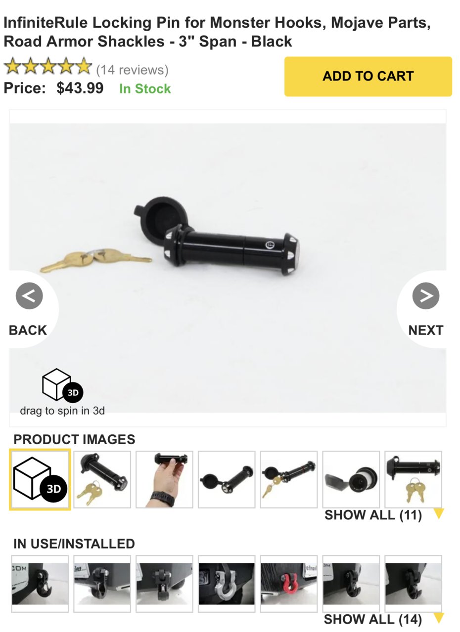

    I would be concerned using a locking pin. Has it been load rated?
    The one shown above has the joint in the middle, which is the worst possible location.
    For the shackle you show, the threads look like they were cut into the pin, meaning the mating bores on the shackle are different sizes between the smooth bore and thread bore.
    This would create looseness if a common diameter through pin.
    300BLK and Tundyfundy like this.

    That would be fun to remove when you need it the most...and quickly.

    Wow almost a hundred dollars for 2 pins?! I think I paid like 26 dollars for both my shackles. I’d hate remove and reinstall when I need them because they are a really tight fit with the rubber isolating washers that Came with them.

    Terrible idea. Bow shackles need to me removed in various recovery situations to attach other recovery gear, like a bridle for example. Store them in a recovery bag with the rest of your recovery equipment in the truck. If you don't have other recovery equipment then why are you attaching bow shackles?
    You should also consider soft shackles instead of bow shackles. Much safer than bow shackles because they have very little kinetic energy in the event of a failure.
