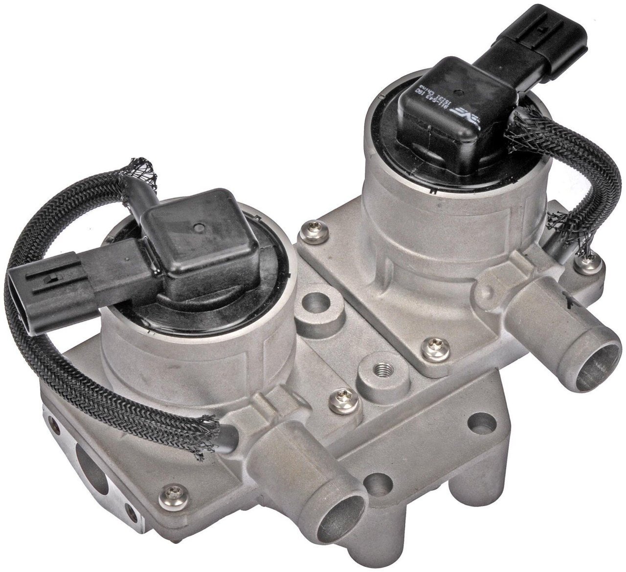

    Inside the Secondary Air Injection Valves, there are Reed Valves that often go bad. I have replaced two Reed Valves already. However, in order to replace them, it seems that I must purchase the entire valve assembly, which is expensive. The housing never seems to be damaged, just the Reed Valves. Can I simply purchase 2 or 4 Reed Valves? The Secondary Air Injection Valve requires two Reed Valves. But I cannot seem to locate them for sale. Thanks.

    I bought it at the dealer weeks later I found it on ali express for a 4th of the stealership price
    They only come as a complete set

    I was able to find the unit on Ali-Express by going directly to the site and entering the part number. Good prices: $90-$115. If I can't find the Reed Valves, I will purchase a unit from them. Thanks.

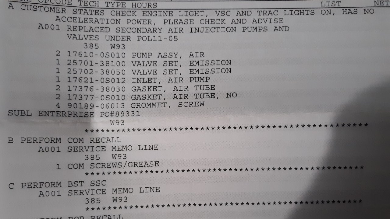

    Well, they will have a suggestion one way or the other. It'll be a few thousand dollars worth.
    :spending:
    I dread the day my recalled pumps break again. They were changed once already.

    Anyways, I just looked them up and my tears!! There are a lot of options and dongles to choose from. If/when mine fail, it'll be interesting to do the research. Needless to say, mine is now seven years since the recall repair and so far, no troubles.
    Here's what they did,
