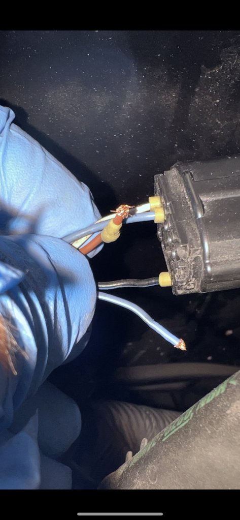

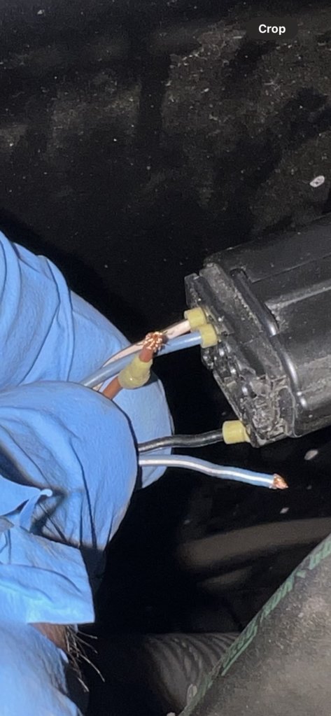

    I'm new to this site, but really hoping someone can help with this. My '07 Tundra 4.7 - I paid a mechanic to change the spark plugs. I believe it is the air injection pump wiring that is in the way of one or two plugs. I read you are suppose to remove the pump to get at the plugs. Instead, the "mechanic" pulled the wire harness away by hand. Well, the wires pulled out of the connector that clips the harness to the pump. He sort of shrugged his shoulders, and taped them back into the connector. That did not fix the broken connection and the check engine light is on, running rough. He is being useless, suggesting I cut the connector off a used engine and splice it onto the harness. Cannot find a used engine for this and dealer wants to replace the entire engine harness. "In short", does anyone sell the connector at the end of the wiring harness, that connects to the air pump? I am so at a loss. Thanks in advance for any help.

    I can get the connector and pigtail wires that go into it. Take a picture up close of the connector looking into the pins, so I can get you the right one.
    Take a picture like this looking directly into the pins:

    Hey, Thanks everybody for all the help. This is really a great site. My "mechanic" found a used connector in an out of state junkyard and they are suppose to be overnighting it. He will hopefully fix things in a day or two (seriously, what a nightmare). If things don't work out, I will definitely get ahold of you Roman, or check out the link sent by Primo. Thanks again for the help!
