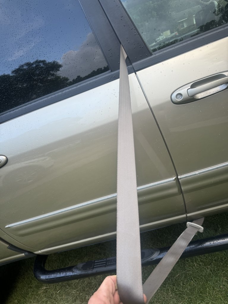

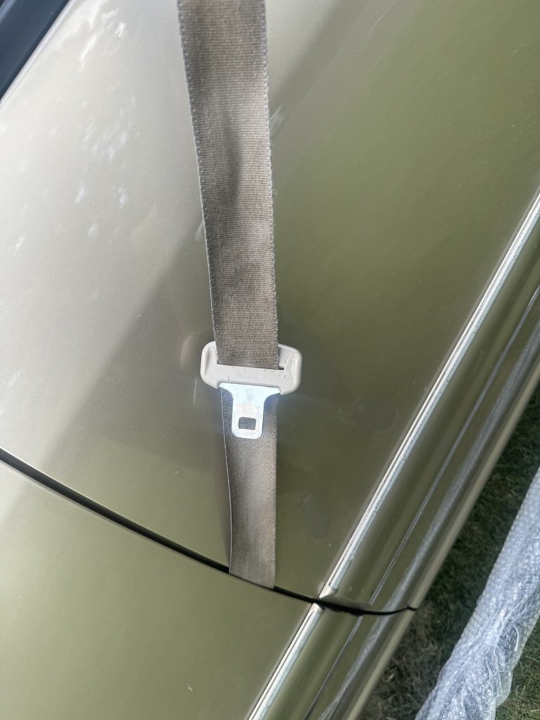

    easiest thing to do is pull the belts as far as you can outside the truck and then close the door on them. Then pressure wash them

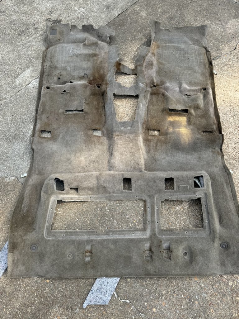

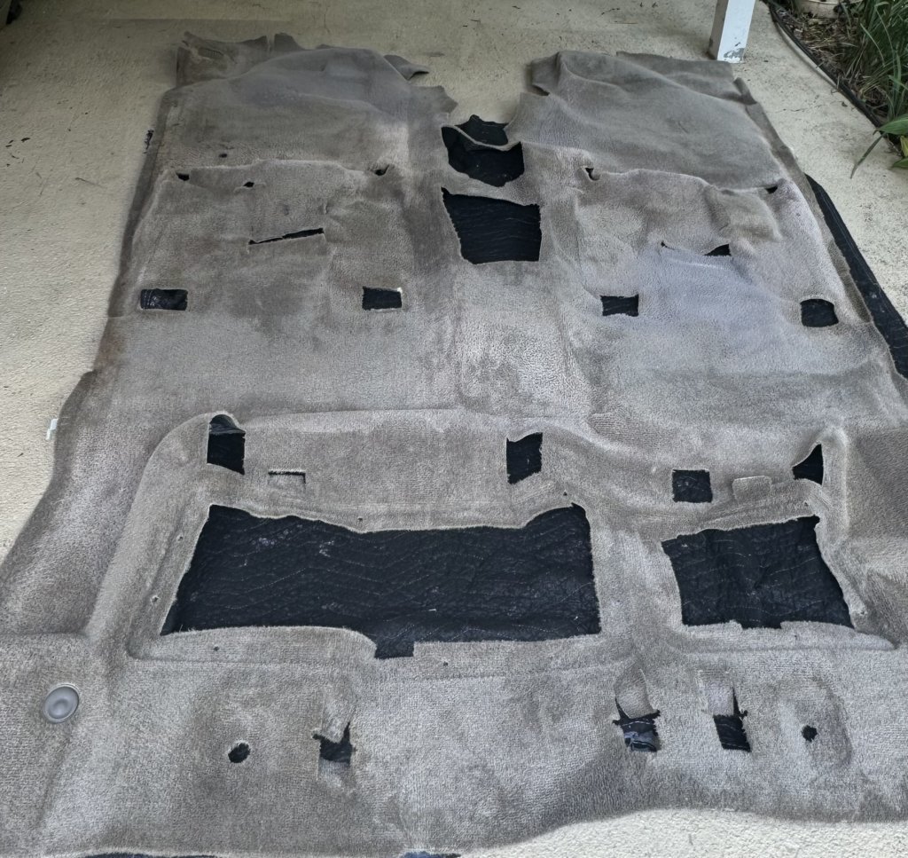

    my before and after, now they work like new:
    You can also take years of abuse off your carpet by removing and pressure washing. In this case I did scrub with diluted Simple Green before pressure washing

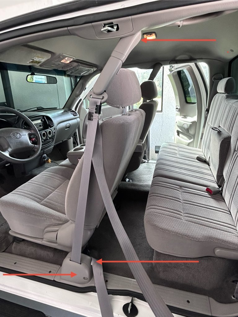

    I cleaned and siliconed the belts, no real improvement. If the belt does not have to pass through the upper loop it retracts fine. Passing through the loop seems to create more resistance than the retractor can overcome.
    If I need to send them in to be rebuilt do I only need to remove the three bolts shown in the attached photo to remove the entire belt assembly? Is there anything else to it that I’m missing?

    Seriously doubt they need to be rebuilt. Many people have luck with the cleaning and silicone spray so I'd suggesting searching that method. Otherwise, there are also videos online showing how/where to sand. You're correct, it's that upper guide that's the "sticking" point. Which is why sanding that opening a little larger is one fix.

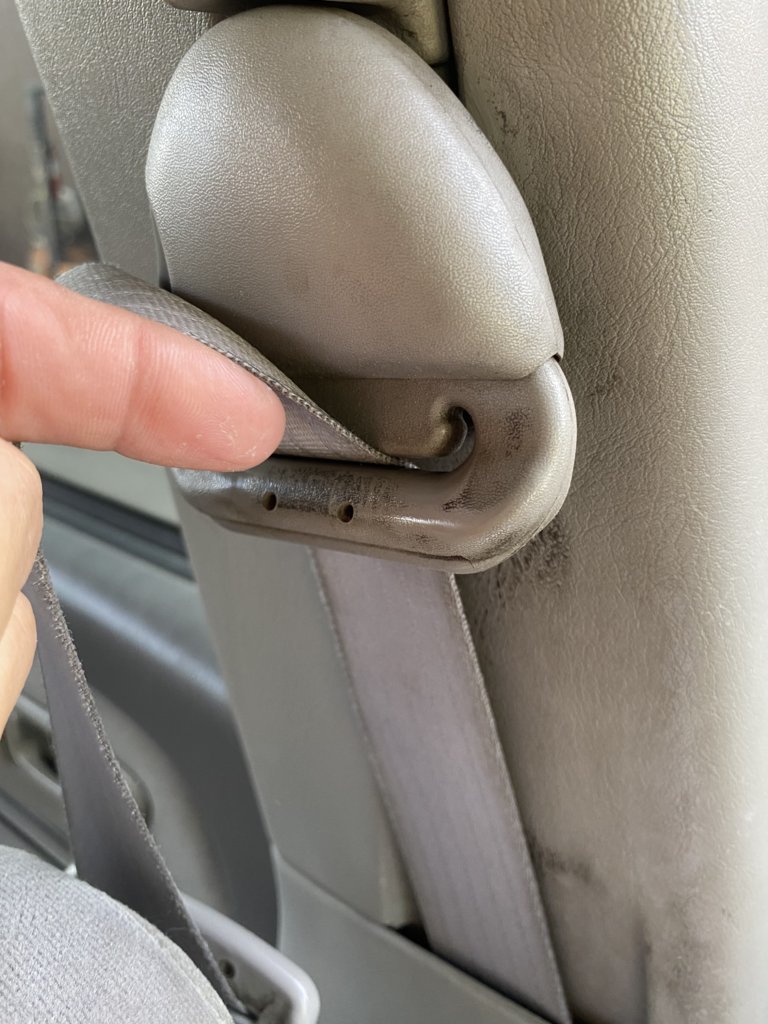

    My 2001 since new have always been lazy to retract, and as I drive they tighten up and try to strangle me. A clothes-pin on the belt right before the upper guide solves the strangulation issue, but I live with the lazy retracting and help it back in manually.

    Put some light sand paper between the belt and the guide right where I'm pointing and go back a fourth. Wipe clean. It took me all of 1-2mins of sanding and my belt fully retracts without any help "guiding" it back into place.

    If you take rubbing alcohol (IPA) to that plastic, it'll clean up all that dead-skin-funk on there, and it'll also run smoother after. In a pinch, lens cleaning wipes that come in a wet-nap style packet contain a fair amount of IPA and will do the job nicely. This is what I'd have our guys use at work to get all the dead skin from hardware people returned cleaned up again. As much as I wanted to burn it with fire.

    Yup. Just unbolt those three points and "Bobs your uncle". Who is Bob anyway?

    I cleaned and silicone sprayed mine with only slight improvement as well
    but pressure washing? Now they act like new again. Just my humble opinion, but if you don't pressure wash them, you aren't doing a deep clean on them which is what they need at this age
