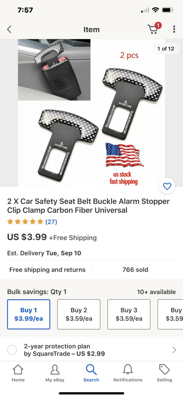

    I picked up a couple gadgets off eBay for a couple $$'s each. Look like the seat belt buckle with a flat handle. When I want the chime to stay off, I just put in the fake belt. Works great when I have a bunch of junk in the passenger seat.
