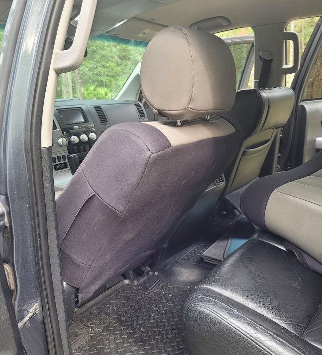

    I noticed today that I had my Wet Okole seat covers installed on the wrong seat backs. This is important because on the drivers/passenger seats there are integrated side airbags (see pictures below). The Wet Okole, and any other covers designed with this in mind, will have a slit or opening to allow the airbag to deploy.
    I had mine on the wrong seats so the opening was on the center console side. (I thought they were for non-existent armrests for some reason.) If the airbags needed to deploy the cover would have held them in.
    I did a quick search and could not find anything altering user to this on the wet okole website. It may be there, but if you're anything like me you're not reading the instructions on how to put on some seat covers.
    Just an FYI, be safe out there.
