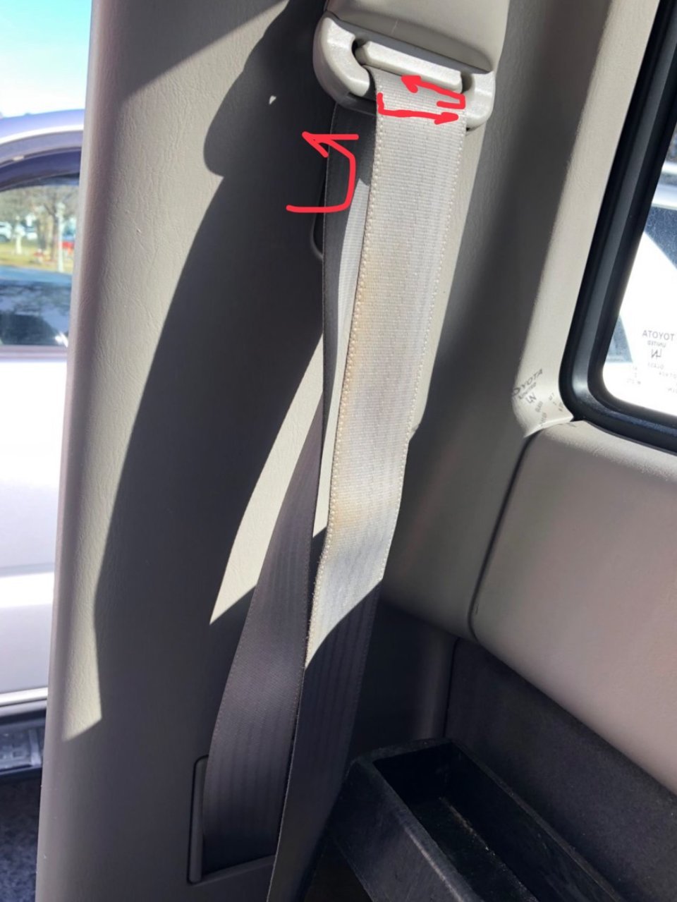

    Have a problem on my passenger side seat belt. Tries the cleaning and lube which helped just a little.
    But looks like maybe it has been worked on before. On the passenger side the belt looks like it is twisted. Belt does not lay flat like the drivers side. Is this normal?
    Will post a pic but maybe hard to see what I am saying. Passenger side does not get used much so did not notice before.

    Looks like it's just got twisted through the top. You should be able to fold it towards the correct way and pull it through to fix it.
    I have no idea how this happens but my daughter is a master at twisting seatbelts.

    Clean it with soap and water after fixing the orientation. There was a suggestion a member on here had about applying some silicon type spray once it's clean. I'm sure he'll chime in later. I haven't tried it myself, but I've had the seat belt replaced 3 times under warranty, so just a bad design I believe.
    Also, not something you want to do yourself as there's a propellant charge built into it to make it work correctly. Don't need that going off in your hand/face if you're unsure of how to do it correctly.
    Maybe the repair manual provides some detail? I'm not sure.

    Tried that but not enough room to do that. And then would have to do 2 of them. The top hanger and then the latch part. I guess I could sand out the gaps to do so. But that is a separate issue from the spring issuse. So if I have to replace anyway not sure worth the time. Just does not make sense.
    The twist is odd on that one side. But I can pull out the belt before the twist and still have the problem with it retracting.

    Needs a fold over and slide flipping. Both belt flaps should lay flat. No twist as you have now.

    Was able to sand the top holder and get the belt straight. But still can get the last 12" of belt to retract. And dealer said a new part is discontinued.
    Anyone actually replaced one. Or is this something a dealer should do. If I could myself. It would be worth it for me to try a used one off ebay for about 100.00.
    Otherwise may not be worth paying dealer for install since that one may also not last.
    Could not find any instructions on actual replacement.

    It’ll last if you keep it clean and always keep it from kinking when you release it. It will slow down retracting with time but it won’t stop altogether if you take care of it.

    Arkansas
