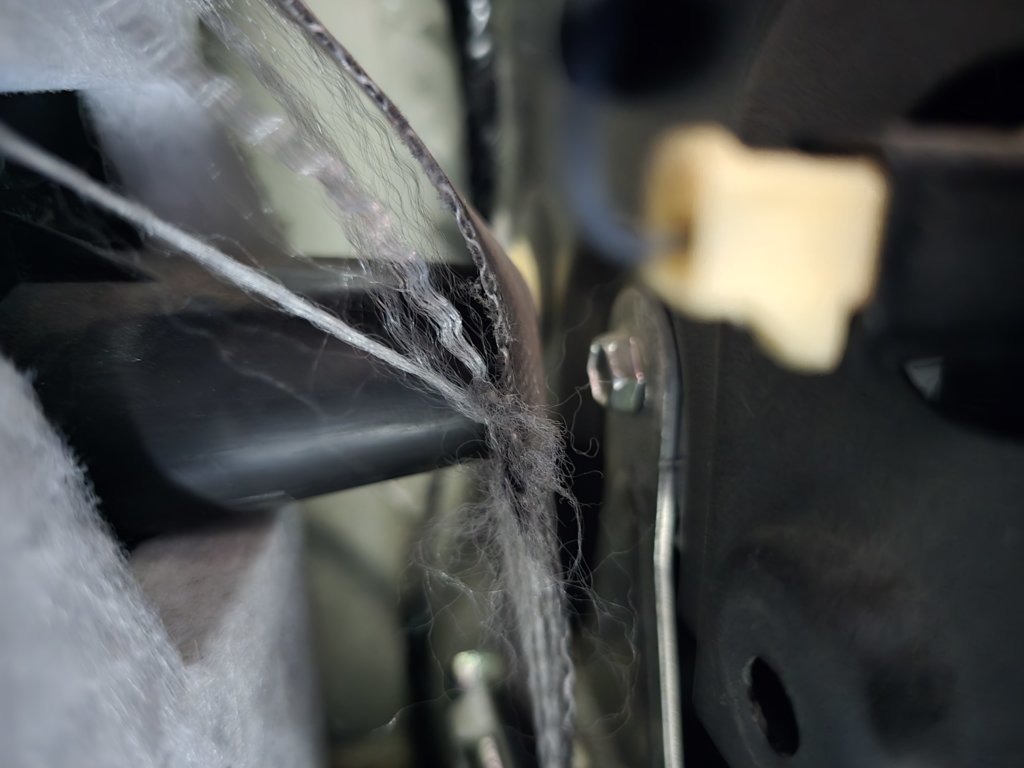

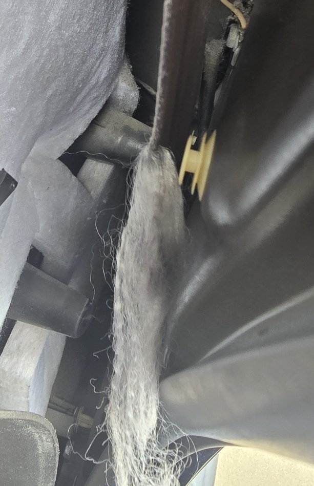

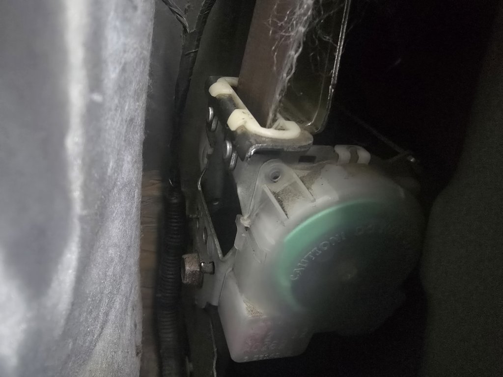

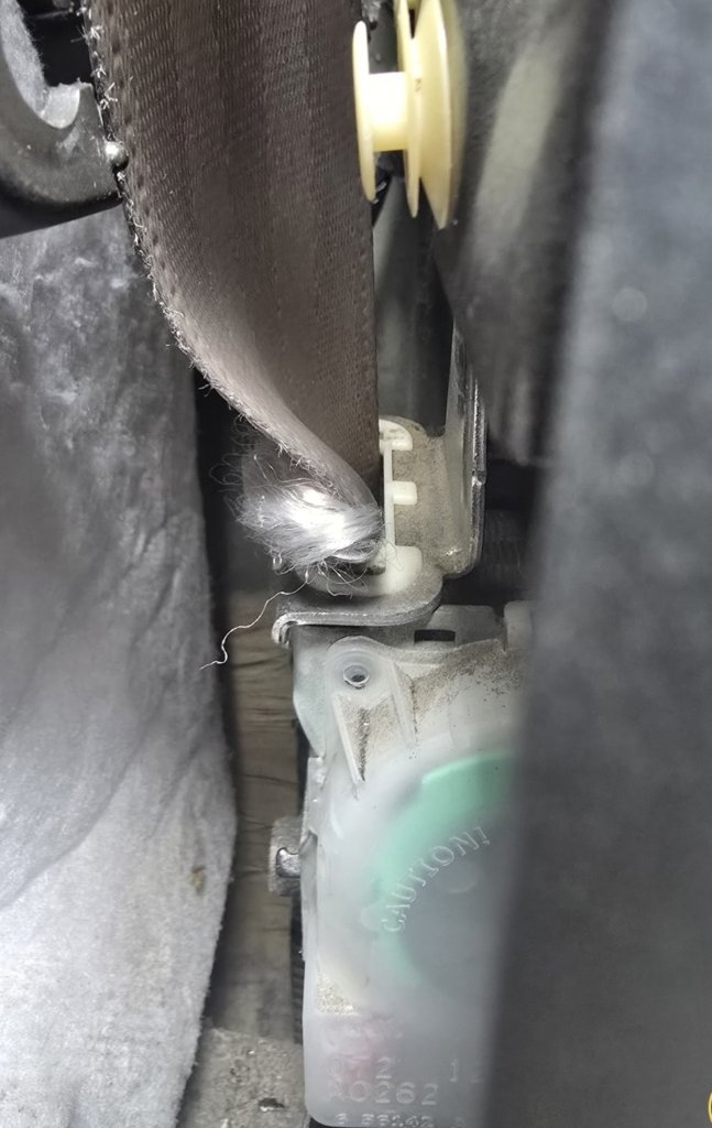

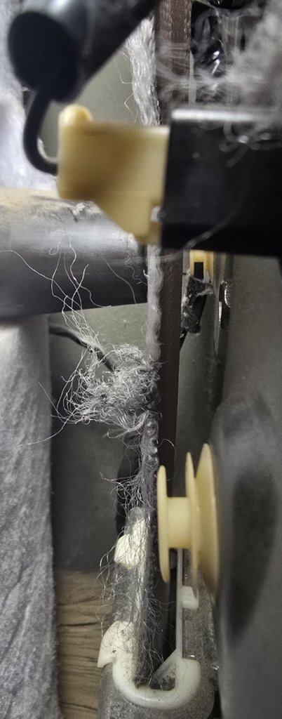

    Welp, I may have found the problem... got home from and decided to tackle this.. good news, I unbolted the rear seats, honestly I probably don't need to. I managed to get some WD40 and after some work it came loose, then got caught again. Problem is not the locking mechanism... it's all frayed, probably tangled in the inner workings. I ordered a new one along with a thermostat for my SC.

    Oh damn that things shredded

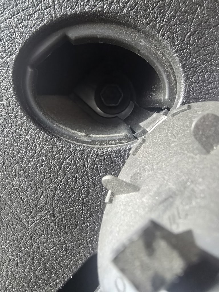

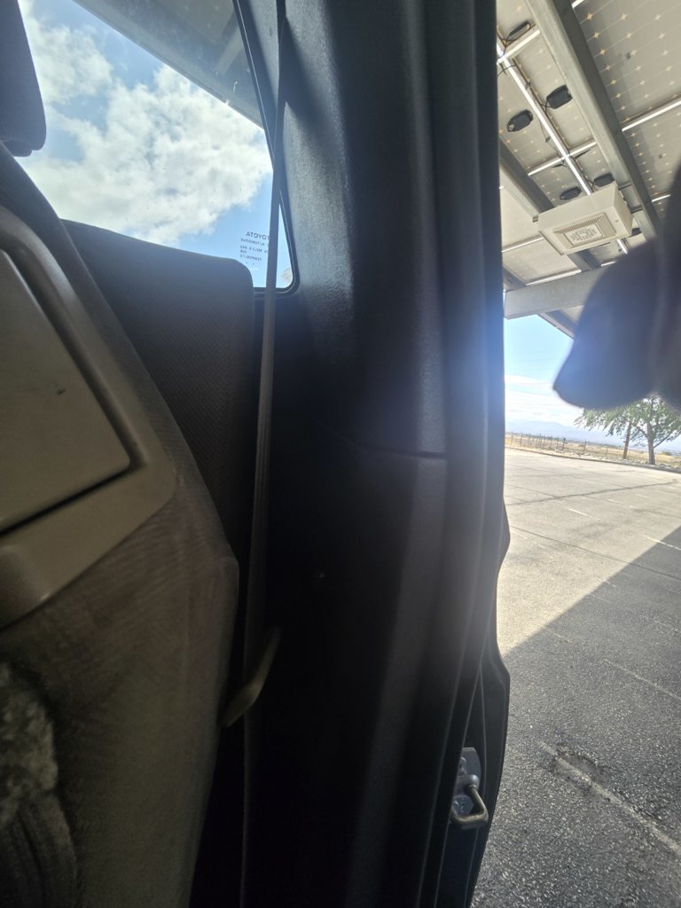

    Ok, seatbelt has been successfully replaced
    Seats don't gotta come out. You will lose some clips though.
    Will need a pick, a deep 10mm a shallow 12 and 14mm sockets or a gear wrench may help, definitely a long 10mm with 3in extension.
    That SRS tab, gotta come out, pull from the window side of the tab. Use that 10mm with extension to pull that bad boy out. After that drop them into the center console so it doesn't grow feet and dip.

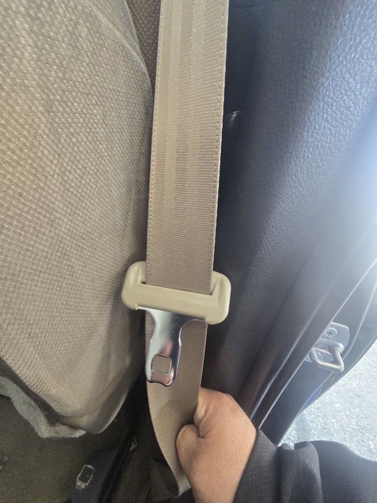

    It's pretty straight forward, except for the buckle and the top exit point that have to slide put with the thickest part towards the rear and tabs towards the door.

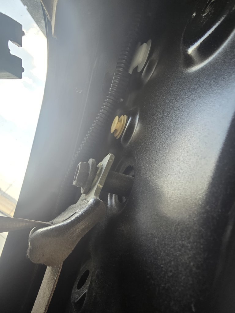

    14 bottom and 12mm top on this bad boy
    14mm for this one too
    I didn't take a picture of the removal, but that bottom thick portion gets pointer towards the window and drops out. There is a riveted plastic tab that I didn't want to mess with so I slid this bad boy down as well as the buckle. New one goes in the same way.

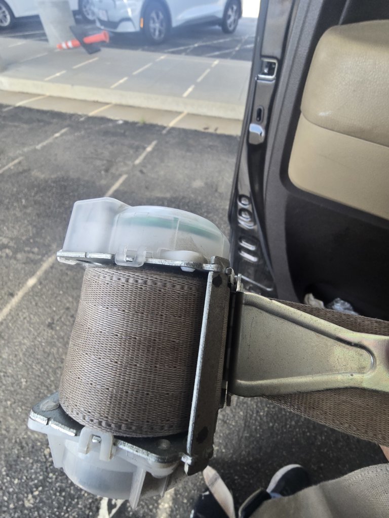

    Here is the old one... only change is the black button vs tan.
