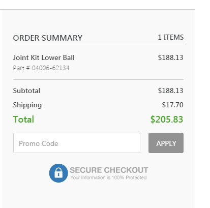

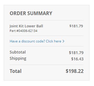

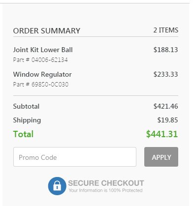

    In my experience with shipping factored in, they are cheaper on everything. Not a huge difference, but some. I have ordered from both. My general rule of thumb is if I found some good info on this site posted by Roman for something I'm ordering, I order from Cool Springs (support people who support us), but if it's all down to my own research, then I go with cheapest that I think is reliable. The below is an example. I ordered the window regulator from CS for my 2005, but I ordered the LBJ kit from McGeorge.
