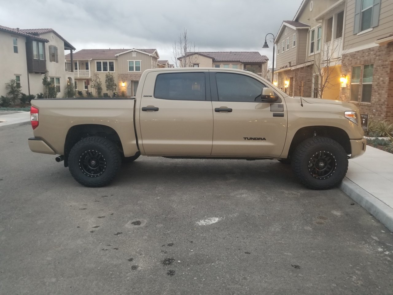

    Some updates!
    Icon stage 3 suspension lift
    (0-3" Lift) 2.5" IFP Coilover Kit
    (0-1.5”) Rear Expansion Pack
    2.5 Series Smooth Body Rear Shock Kit
    Icon Tubular Delta Joint Control Arms
    Icon Allow Six Speed Wheels - 17 x 8.5 5x150 5.75" offset
    BFGoodrich AT KO2s - 35"
    Grabbin Ass Grab Handles
    Paint match and black out - South County Auto Body
    Tactilian flags
    Hollowpoint gear caps
    Thinkware F800 Pro Dashcam
    Toyota console safe

    Did you have to do body mount chops to fit those 35's? And did it rub on the front bumper as well?
  9. Jun 13, 2019 at 10:06 AM
    schaderaide
    schaderaide [OP] New Member
    Oct 20, 2018
    #20776
    69
    Ryan
    Orange County, CA
    Only rubbed on the front, so had to do some trimming on the skid plate and front bumper

    another question. What is the difference between the tubular control arms and the most expensive ones that Icon makes? Just weight? Any difference on tire clearence between the two?
  16. Jun 14, 2019 at 11:40 AM
    schaderaide
    Oct 20, 2018
    #20776
    69
    Ryan
    Orange County, CA
    A lot depends on what you are doing and if you need the ability to adjust rod ends and then the joint types. Tubular uses the Delta joints which dont need much maintenance (if any), the billet use heim joints and tend to need more maintenance. Billet are adjustable, tubular arent.
    If its just a daily driver that sees dirt here and there, Tubular are great. Hell, even if you are beating it up, tubular are still good.
    I was talked out of billet FWIW. I think billet look better, but not $500+ better.

    also debating going with Nitto Ridge Grapplers but the 35's run a little bigger then the Ko2's. Kind of worried about fitting them. How much room do you have (besides the front bumper) with the K02's? Could you fit more tire. Like .3 of an inch?

    Shouldnt be an issue, but talk to whatever shop you are thinking of going through to get their opinion.

    I hear you,t hat was my biggest worry too. THere is enough going on that will hinder warranties and I didnt want to do anymore than I had to.
    From what I can see on my setup, .3in wouldnt be an issue. I would still call a couple offroad shops that specialize with Yotas and get their 2 cents.

    Think I might go with 305 70 17. Just to be totally sure and also to maybe save on gas a little bit. Did your MPG change a lot?
  24. Jun 15, 2019 at 11:12 PM
    #24
    schaderaide
    Oct 20, 2018
    #20776
    69
    Ryan
    Orange County, CA
    went down by like 2 mpg, nothing crazy
