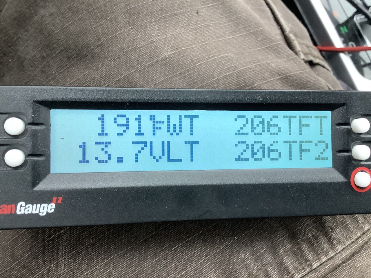

    So I set up my scanguage yesterday. The codes I used were from scanguage website. I could only get two of the codes to work. Seems to work fine but I am not sure if I am reading temps from the pan and torq ...or just one place. The temps are almost exactly the same. One will change ...then the other a second or two behind it. I was not towing anything and our high today was 28F. Is it normal for the pan and torq temps to be almost exactly the same...or am I reading the same temp location...just a second or two later?

    Yes, they do read the same unless the torque converter i s being worked, like shifting in town, then the torque converter will be the higher one.

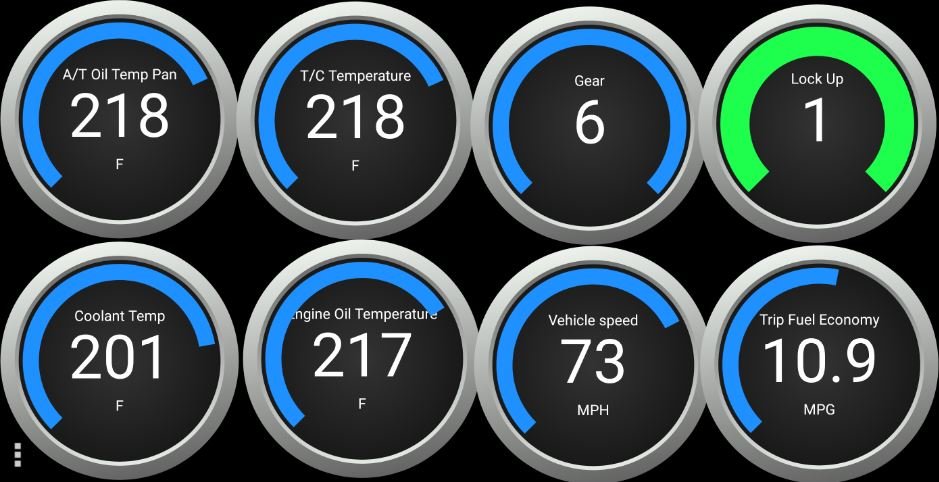

    You'll find they also follow the oil temps. Towing a boat in "drive" temps.
