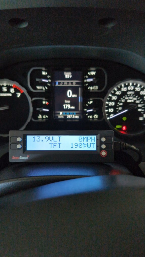

    I know, I know, don't hit me.... I bite the bullet and got SG II on the cheap (Advanced Auto had a discount of 20% capped at $50 so why not, SG III would get the full $50 off) but now am unable to get the transmission temps to show.

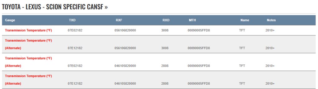

    According to SG website, here's the code, I tried the top two but still no dice.
    Has anyone set this up before? Idea? Thanks.

    I did end up figuring it out, line 3 was the golden ticket.
