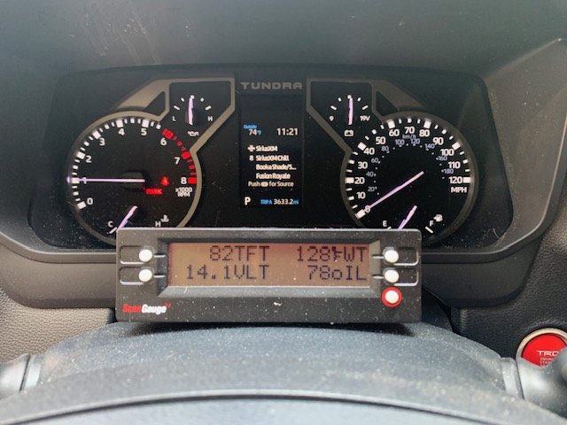

    Here is a photo of my SG2 mounted on steering column. I also looked for a Boost gauge in there and there was none in the native gauge offerings and the Boost xgauge I programmed using this » Boost Pressure (PSI) (scangauge.com) didn't work.

    I mounted mine in the same spot but, I used magnets glued to the Sacn gauge and then glued magnets under the column from the inside. I can remove it whenever I want without marks.

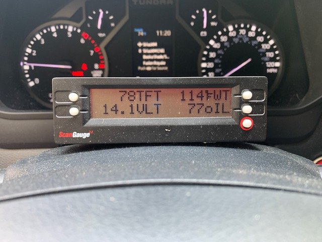

    Here is how I have mine set up. I used a small "o" for the oIL temp text name field since a big O would have looked too much like zero.

    got my sgii back with upgrade 4.53.
    all good now with 2016+ 3.5L Equipped Toyota/Lexus X-Gauges
    https://www.scangauge.com/support/x-gauge-commands/toyota-lexus-scion/
    i tested a few of them. may try some more to confirm, but i am running like @raylo. vlt, tft, eot, °wt
    these work:
    Transmission Fluid Temp 1 (°F) 0701221AAA C462051A36AA 3008 00090005FFD8 TFT
    Engine Oil Temperature (°F) 07002210F6 C32400000000 2008 00090005FFD8 EOT
    Battery Temperature (°F) 07002238D5 C462053836D5 3010 00090032FFD8 BAT
    Alternator Output Duty Cycle (%) 07002238D7 C462053836D7 3010 000100A40000 ALT
    not working (no result) Transmission Fluid Temp 2
    not working (odd result -71°F) Front Differential Temperature
    water temperature and voltage are default, no x-gauge req'd
