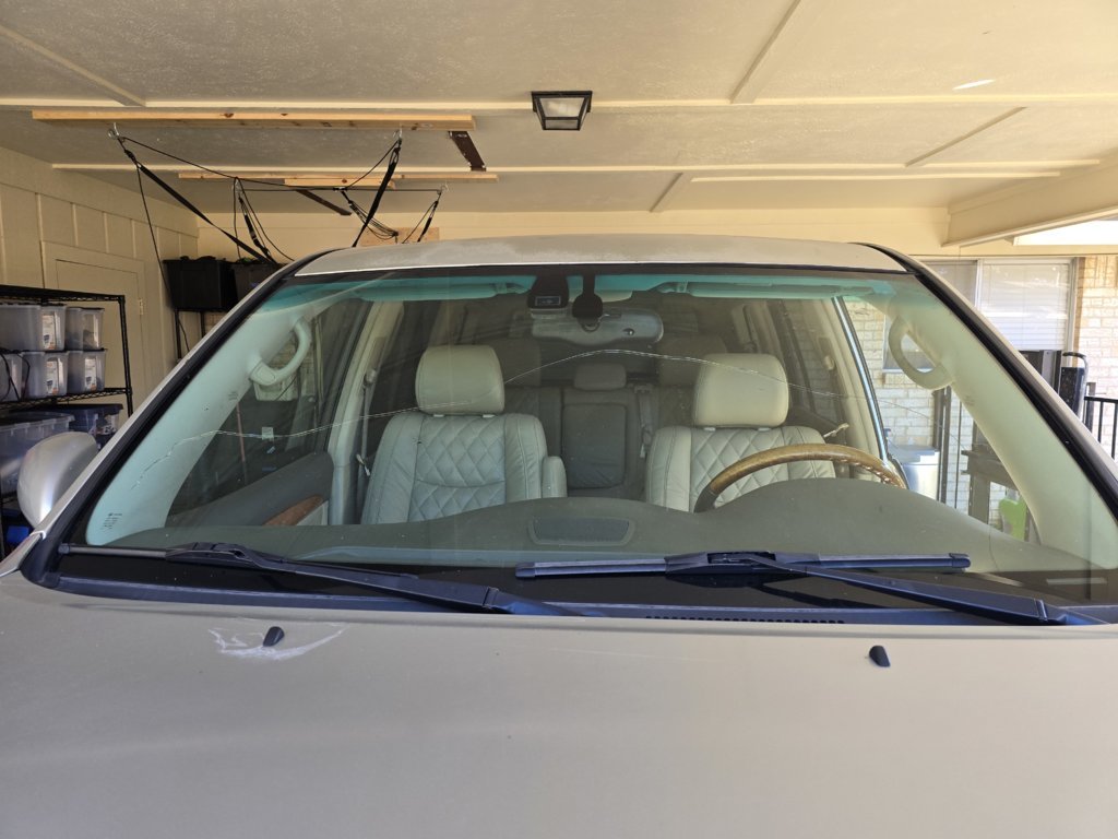

    just scheduled a windshield replacement for next Friday. Through Safelite. I was gonna do OEM but it was twice the cost.

    New windshield!

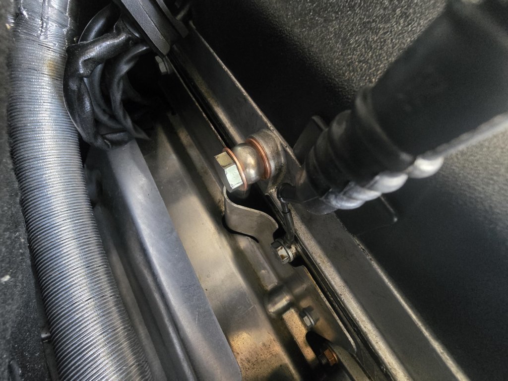

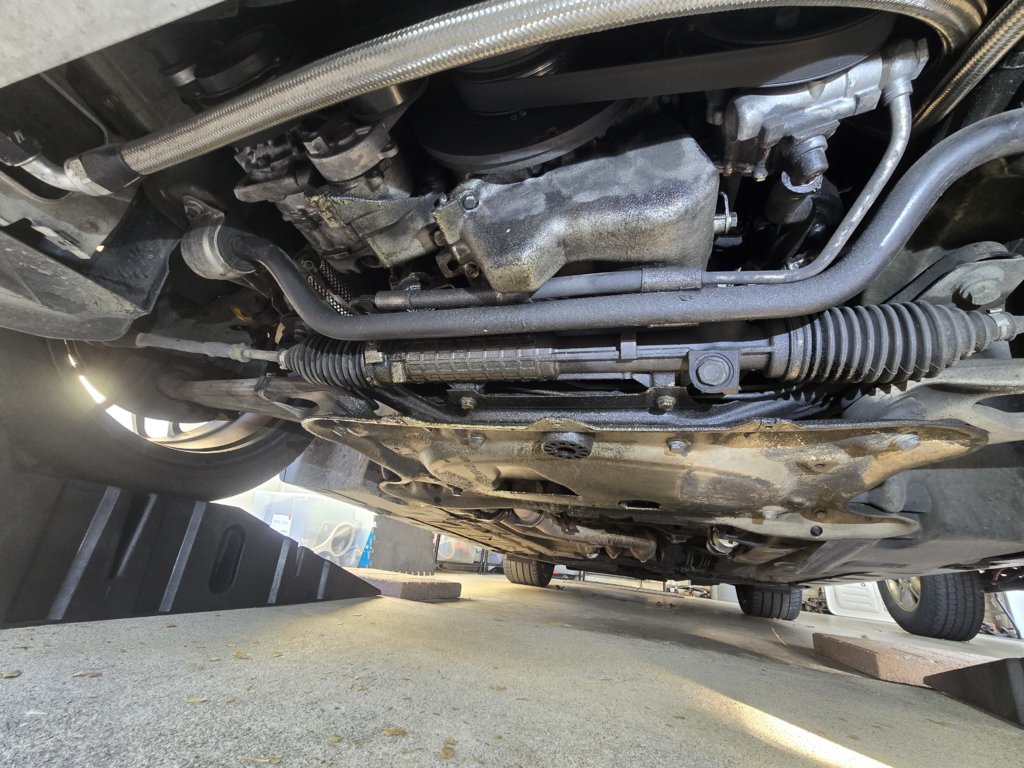

    2005 GX470

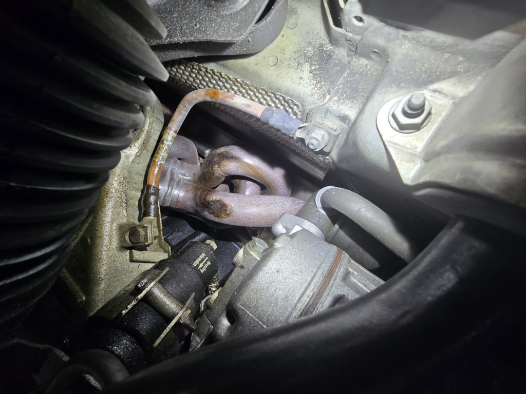

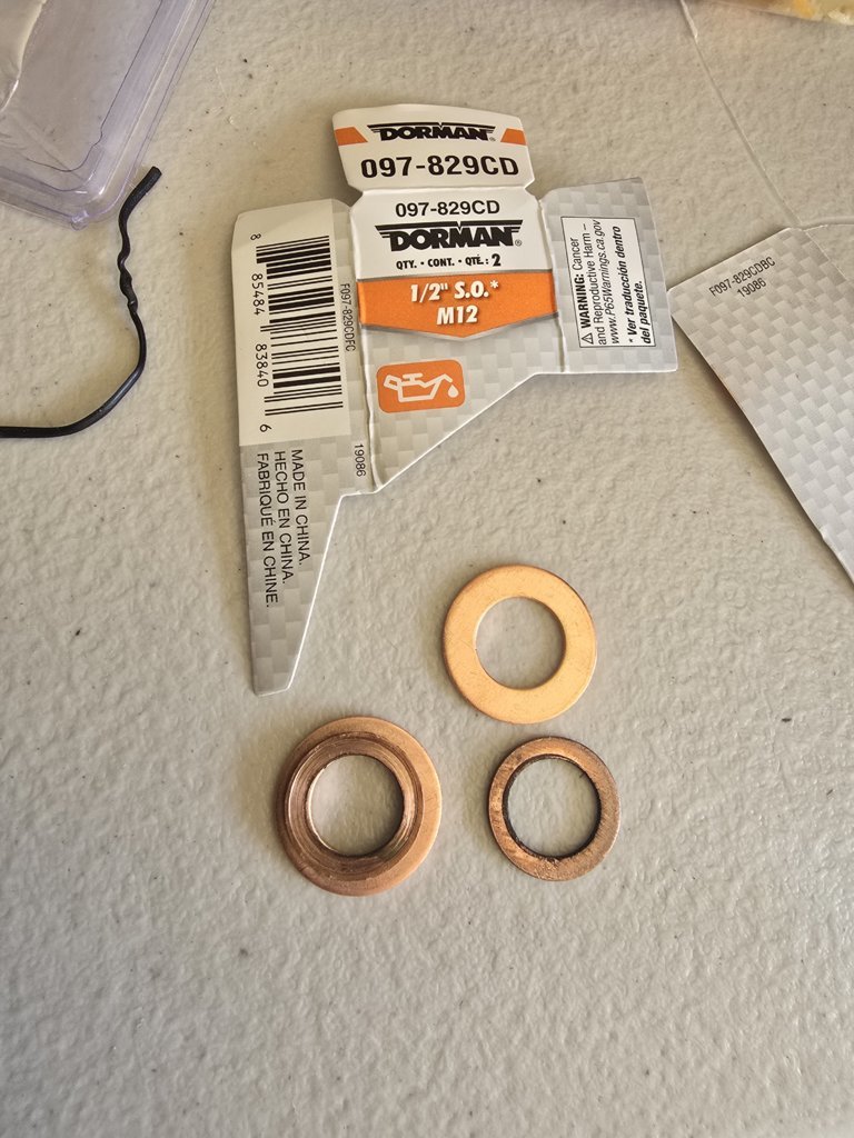

    FINALLY fixing an oil leak on the M3 (one of the many). Probably been this way for a year but it's been getting worse lately. I had done a valve cover gasket replacement at some point, and didn't realize I needed extra crush washers for a banjo bolt. So I reused the old ones. No Bueno. Been causing a slow leak right on top of the exhaust manifold heat shield. So rolling up to a stop light after a while cruising, smoke could be seen slowly coming out of the passenger side...
    Just went to Orielys and got some generic crush washers. Should work. Same inner diameter but larger outter...
    + $3.50

    Unfortunately I still have to replace the crankcase position sensor gasket also. That's a huge PIA to get to, being at the far backside of the engine. I'm probably gonna work up a list of things wrong and hand it over to a local BMW shop. Hand them the keys and warranty information, and my list of issues. Tell em fix whatever warranty will cover even if it's not on the list. Go to town on em lol

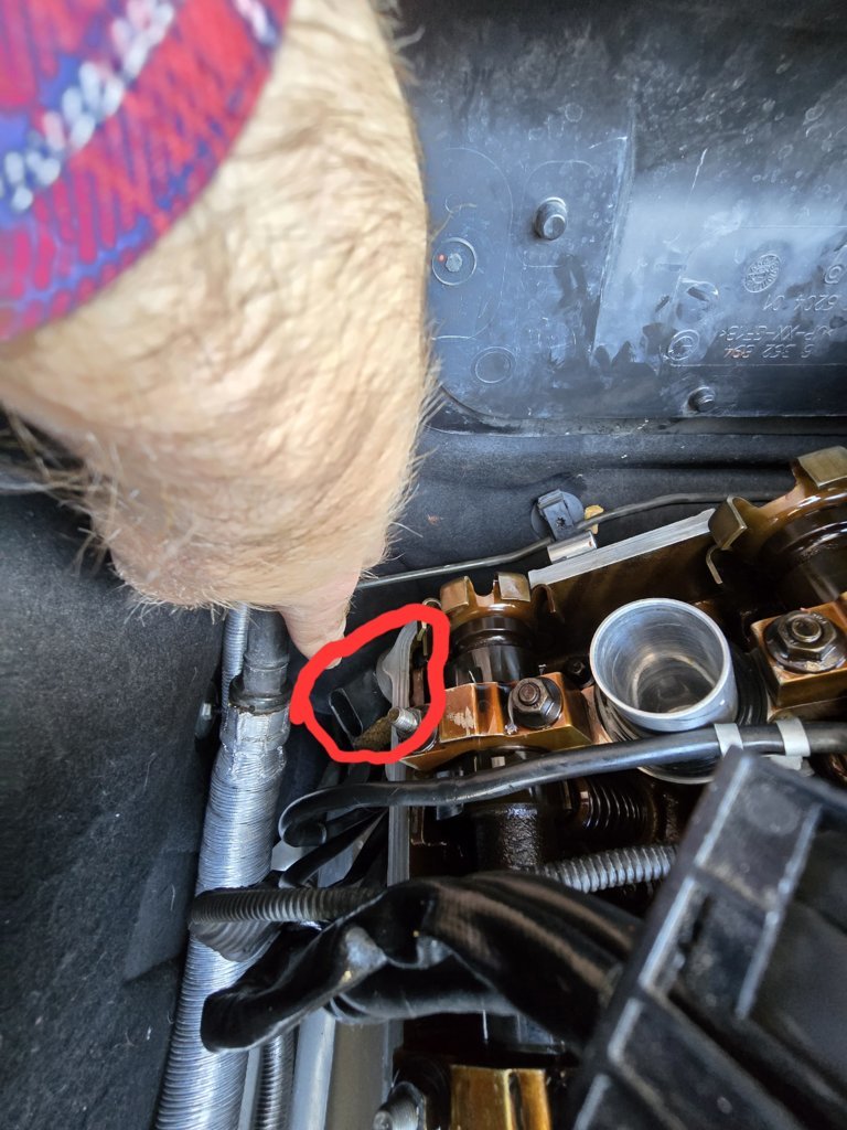

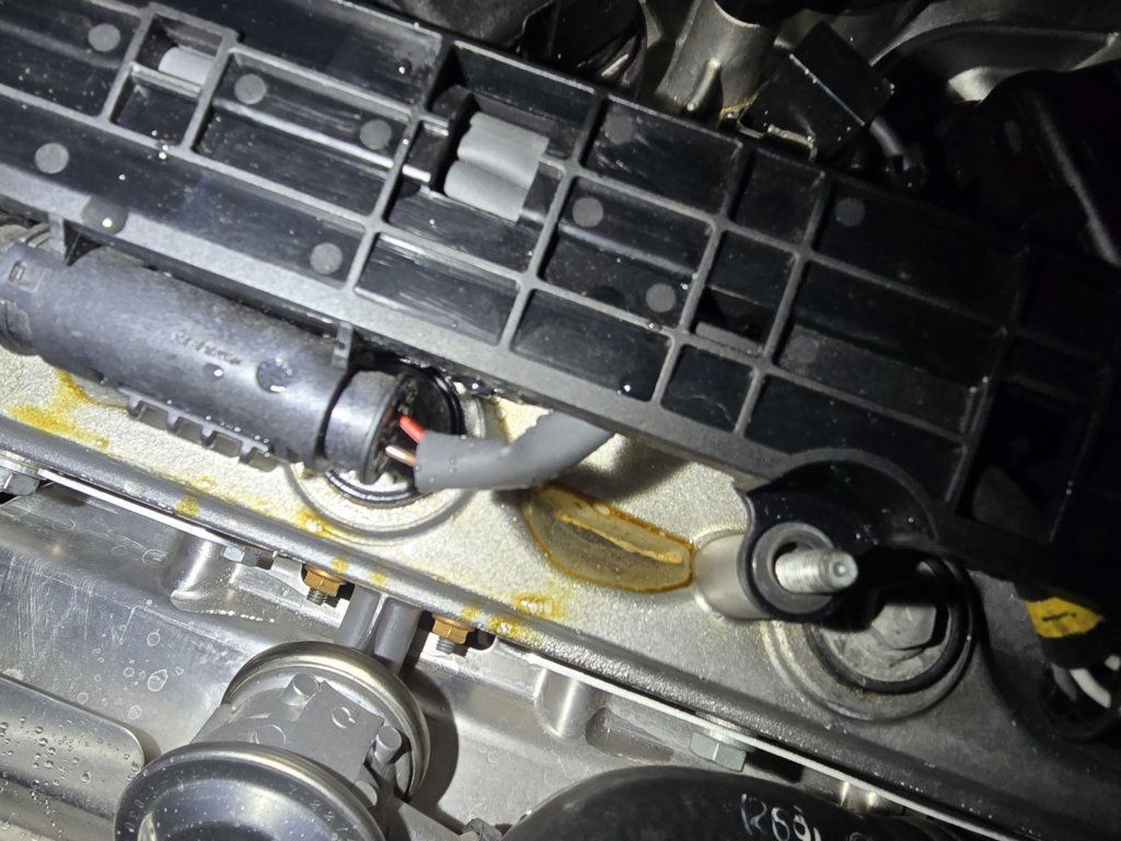

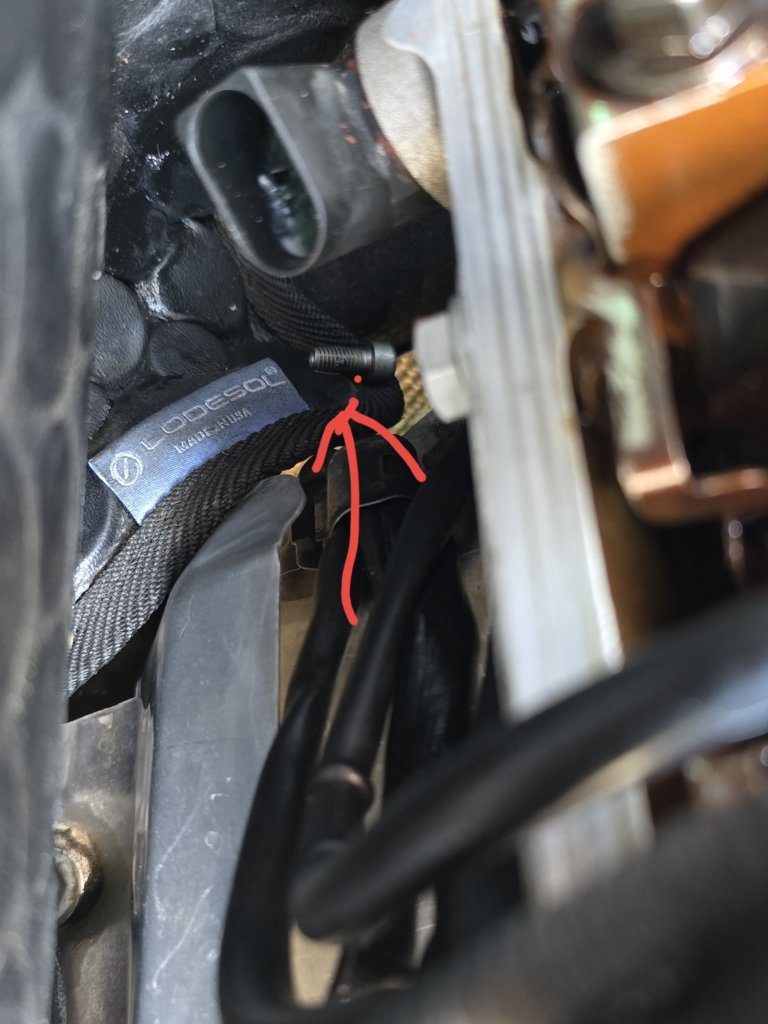

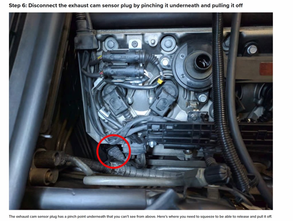

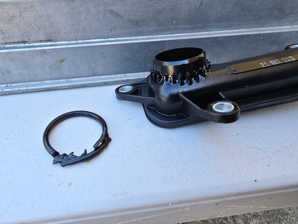

    Hmm, few things with the M3. I was feeling around the wires in the back and...wth...I guess I forgot to plug the cam sensor back in the last time...

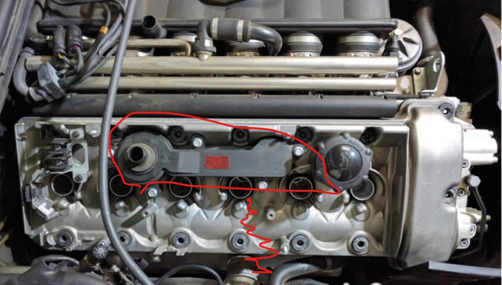

    And it seems the leak is coming from either one of the new valve cover bolt gaskets, or this part that I replaced. forget it's name but has a red circle on it

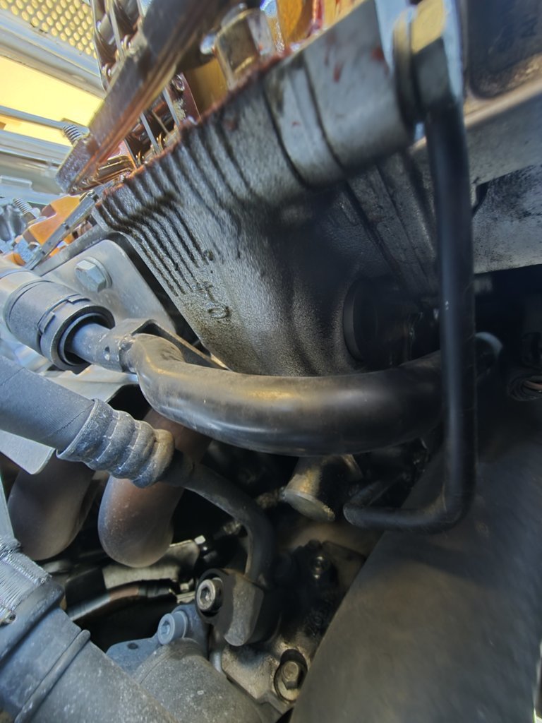

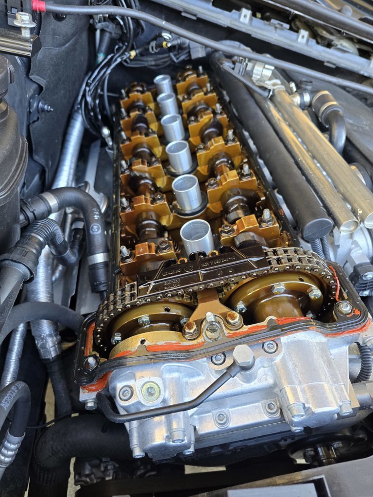

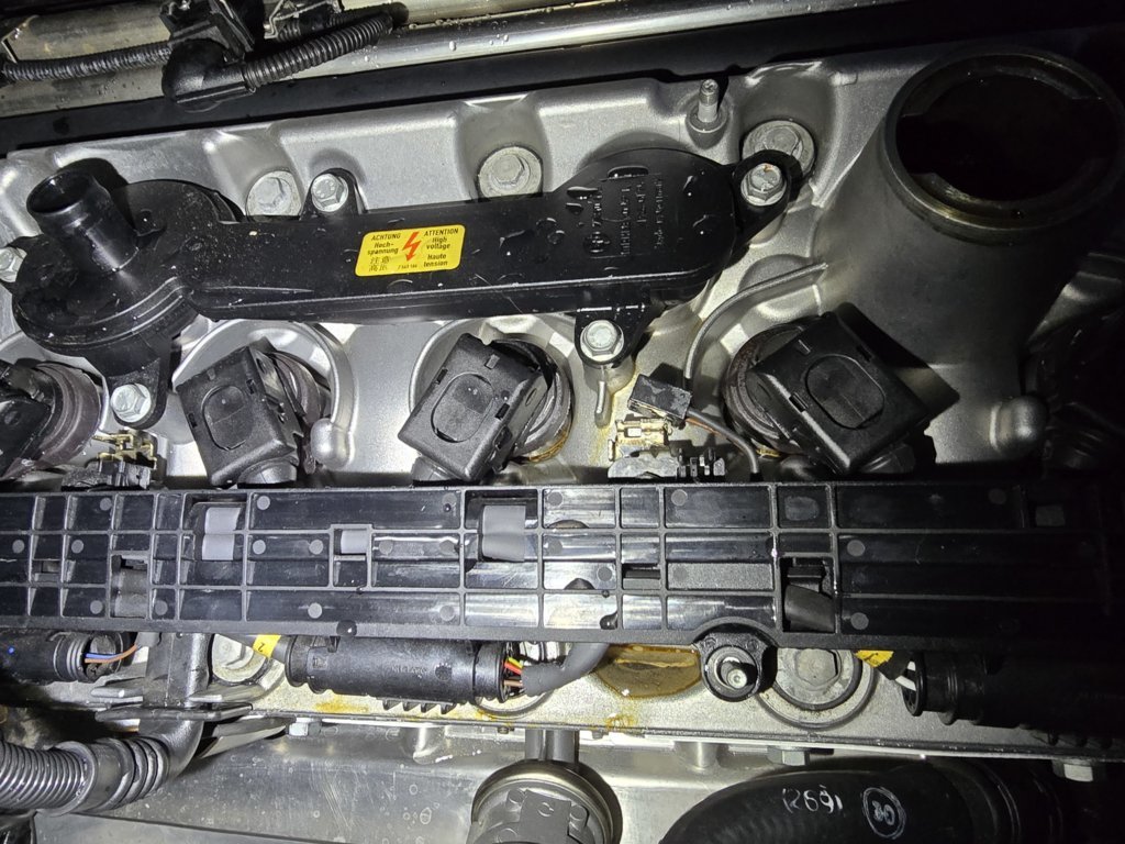

    Found a few more oil leaks. From the front vanos side of the valve cover gasket, the rtv failed. And the crankcase vent that I had replaced last time, it's gasket also failed. And these are just the top passenger side oil leaks! I have bottom drivers side oil leaks too...

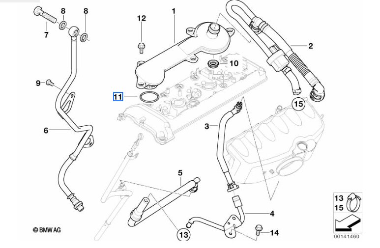

    Ordered 2 crush washers, #8, and one o ring, #11.

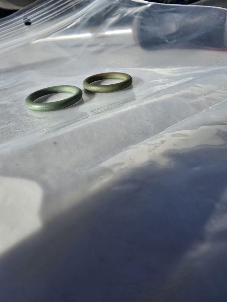

    2005 GX470
    Aaand while I'm here, ordered the crankcase position sensor o-ring. Knew that was leaky last time and didn't replace it. Almost forgot about doing it this time.
    + $22!! for an o-ring!

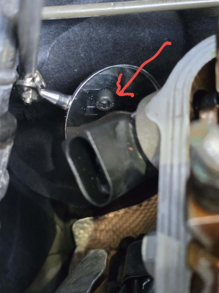

    PIA to get this one bolt out. It's essentially upside down and at an angle

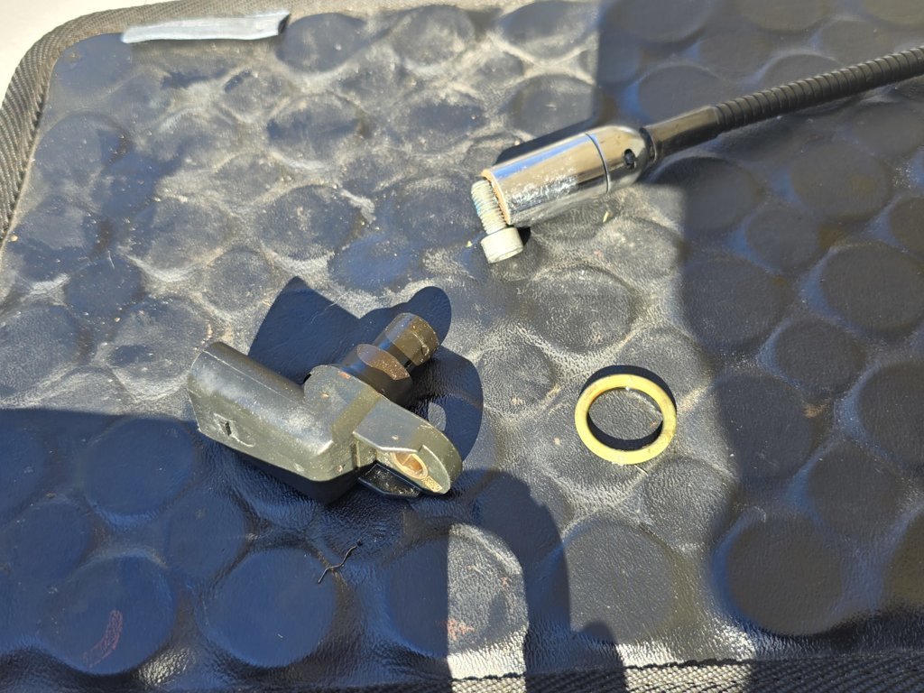

    Aaaand it's a freaking Allen or hex or whatever bolt!

    Ok, i told them the wrong thing. it's actually the CAM positin sensor that I need the o-ring for
    only + $7

    Pro move if i don't say so myself. Put the magnetic sleeve down and it just barely caught the bolt

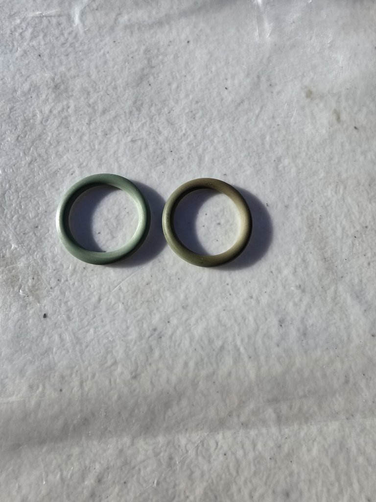

    E46 M3 - New (left) vs old cam position sensor o-ring
