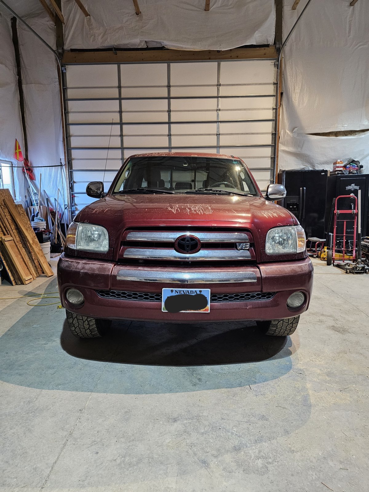

    Hello All,
    My 05 Access Cab 4x4 has sag in the front left. I can't figure out what it is. I've changed the struts. Maybe a bend in one of the A arms? Anyone have any guesses? The truck did sit with flat tires on that side of the truck for 2-3 years. Could that have done something. Hopefully the pictures help. I can add more if someone needs to see specific places. I appreciate all your help in advance.

    That looks like something is legit broken on the driver side

    Flat tires wouldn't cause that kind of lean. That looks to be about 2", I'd guess maybe the spring is weak/bad if something isn't bent.
    If the flat tires were on the drivers side, it'd load the passenger side heavier. Which should cause the lean to be the other direction.
    Mine was 1/2" or so but I corrected it with a spacer on top of the strut to compensate.

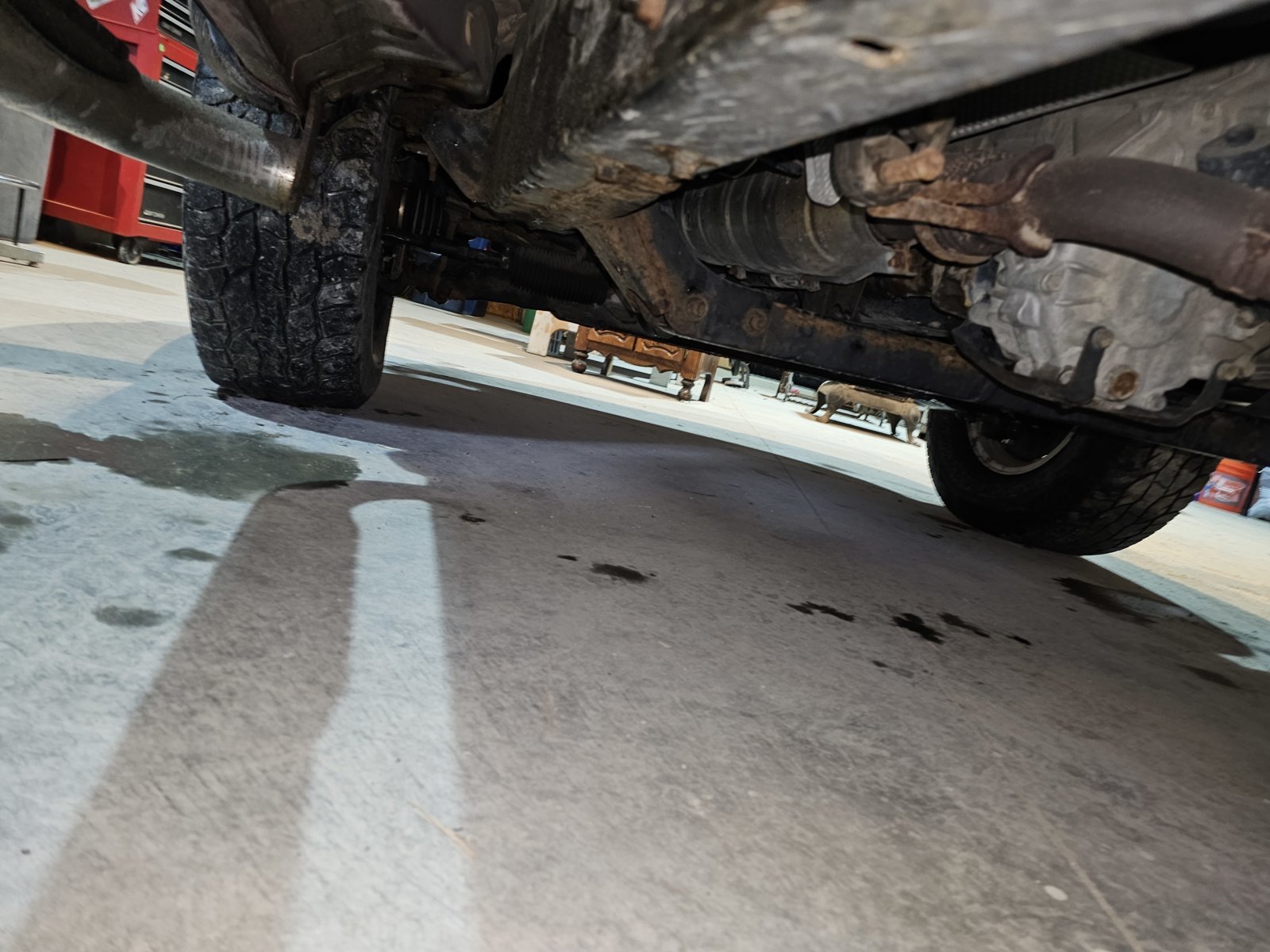

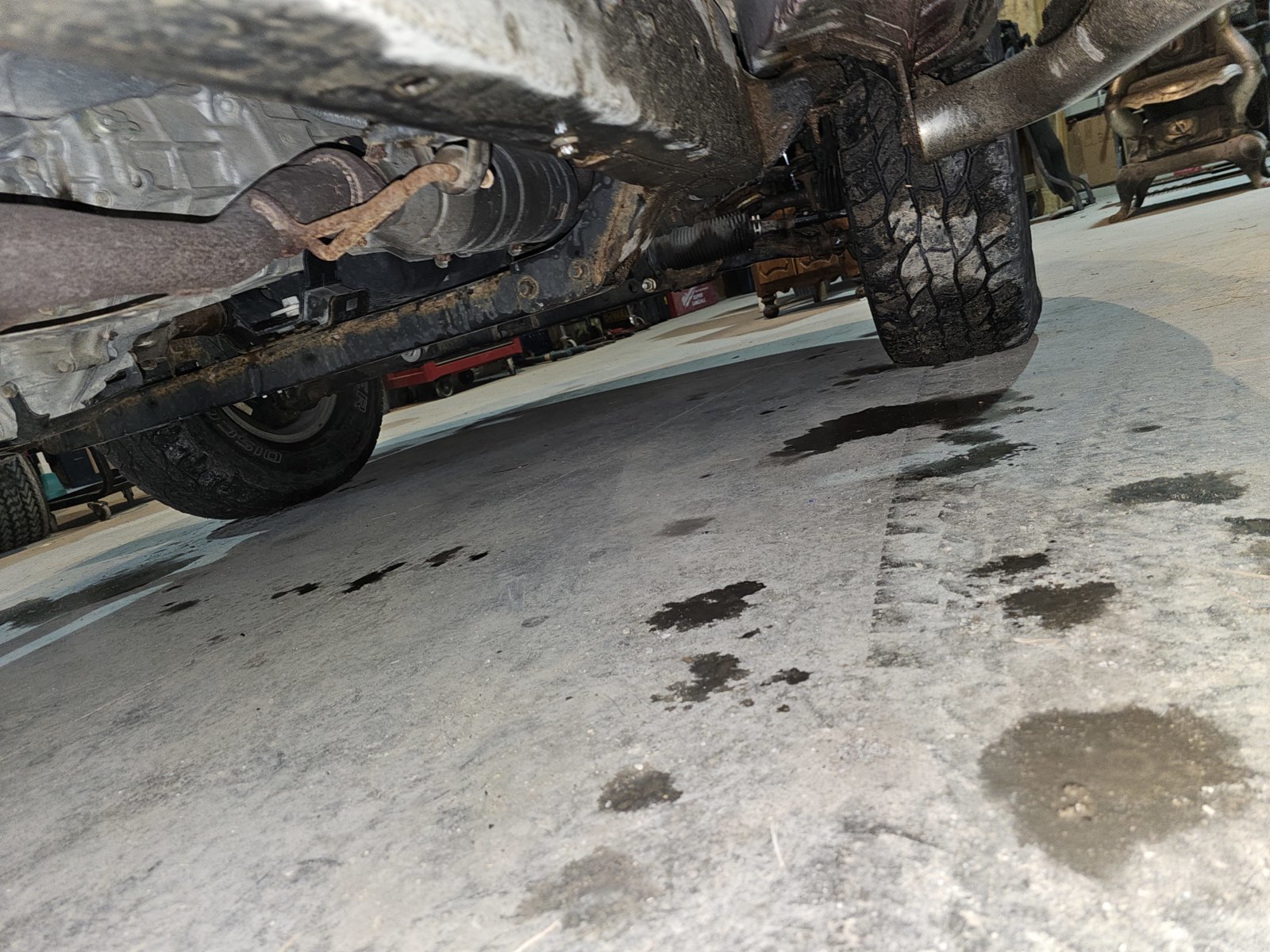

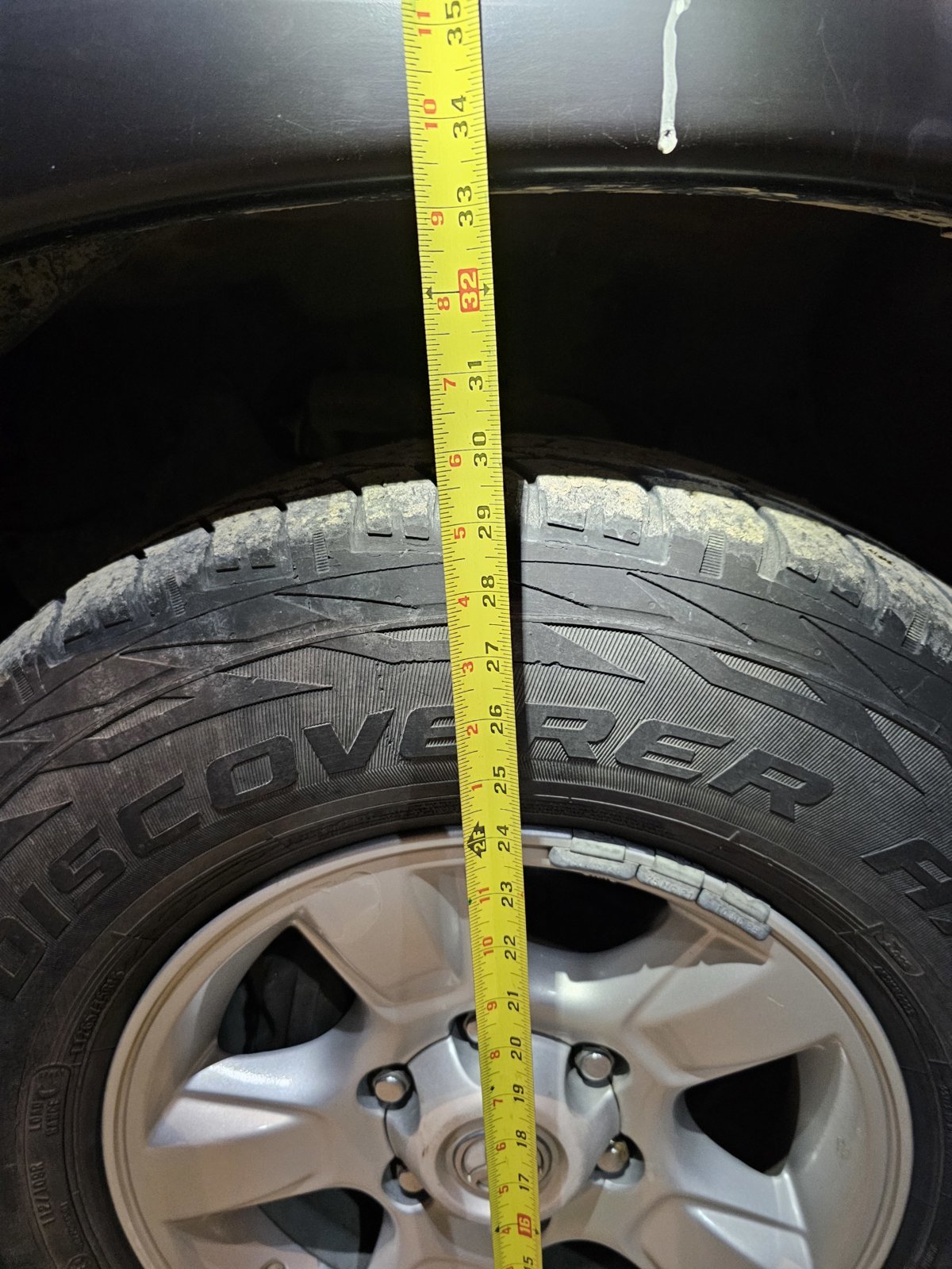

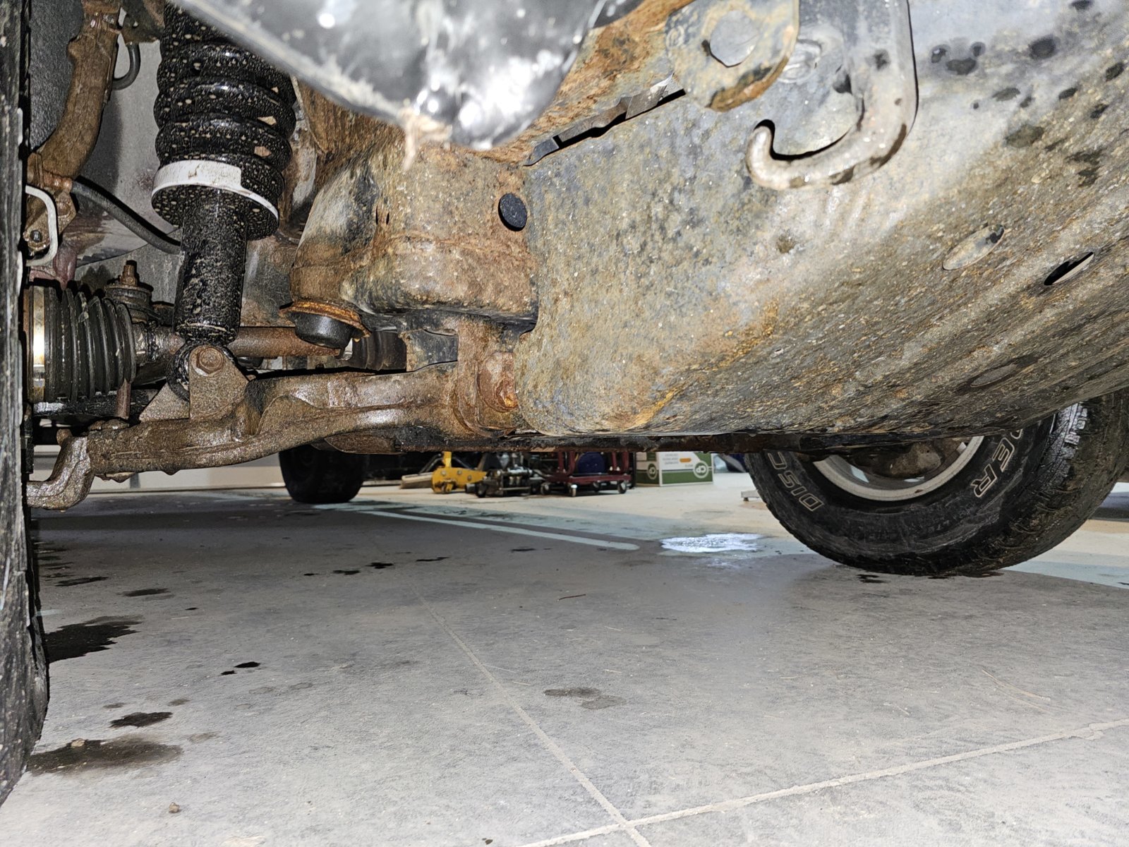

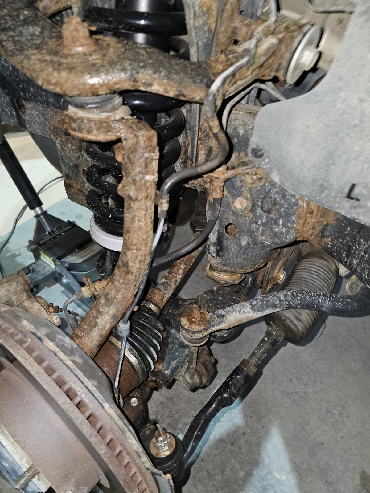

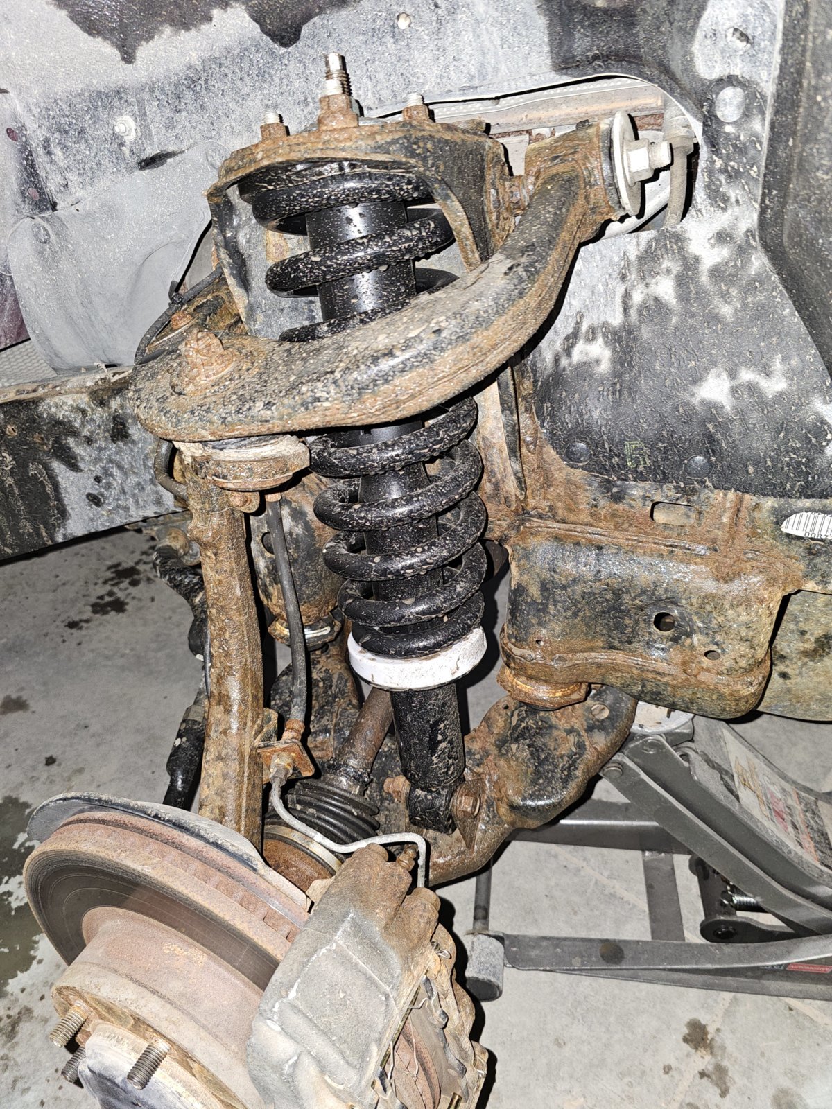

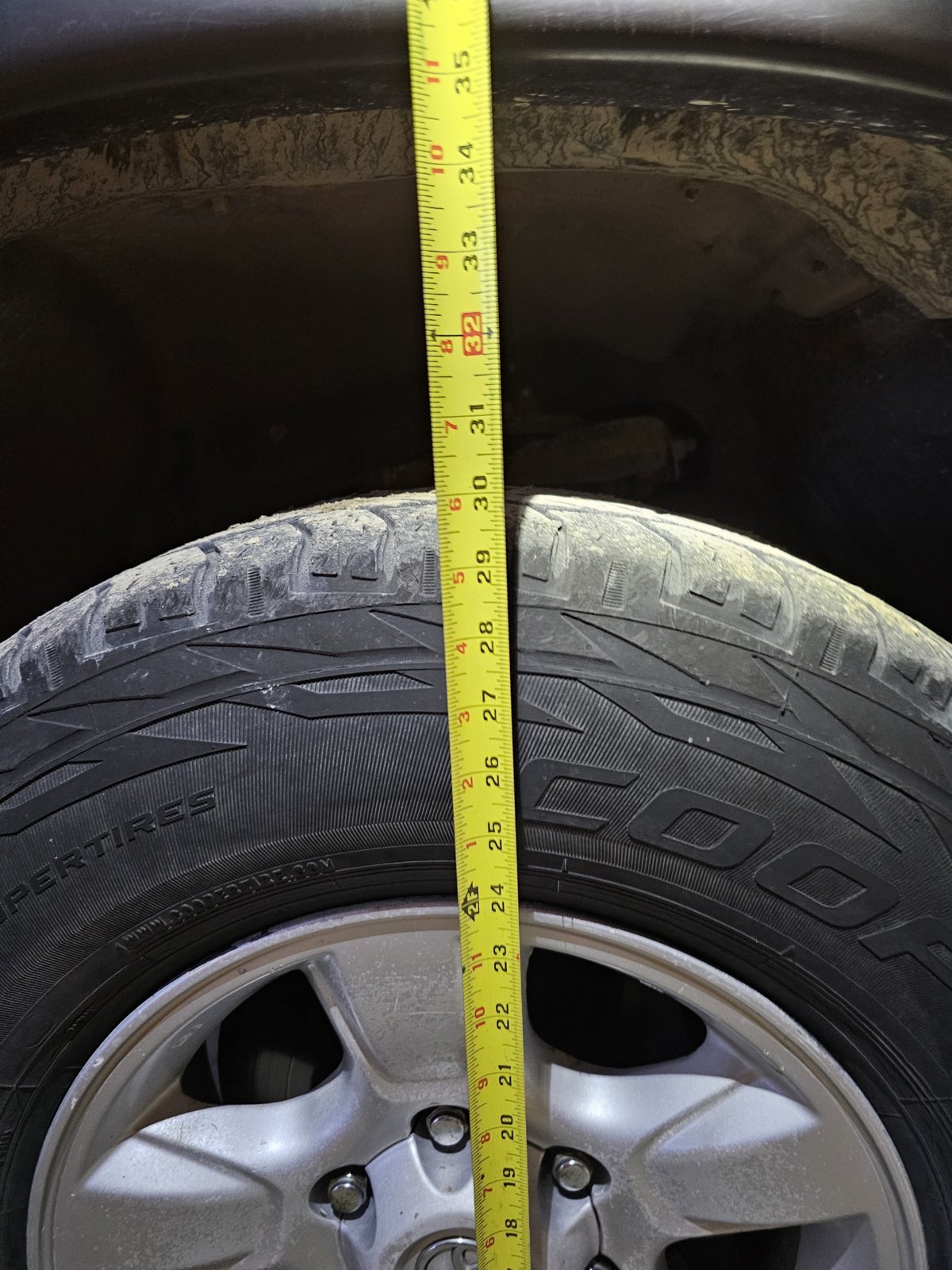

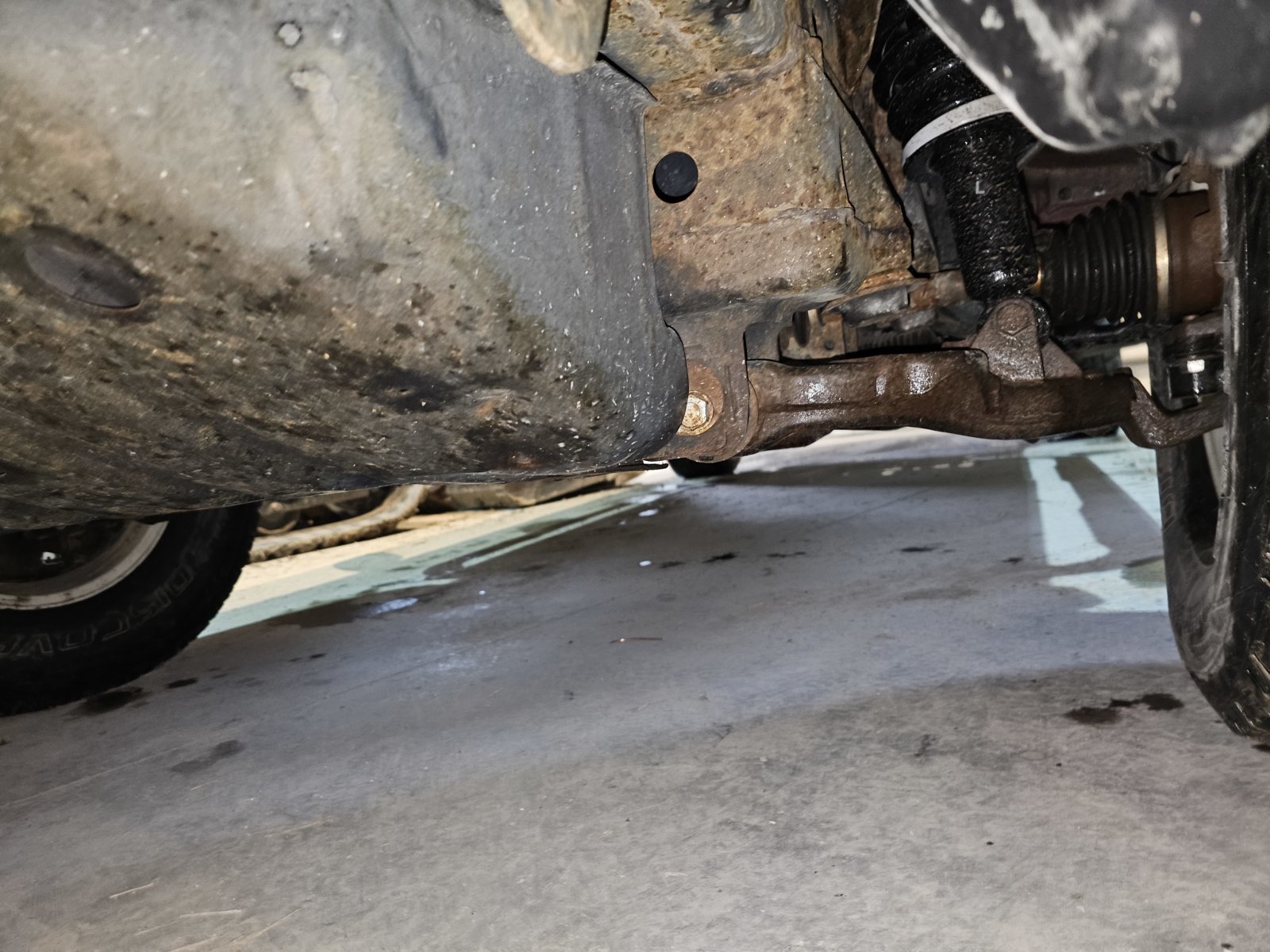

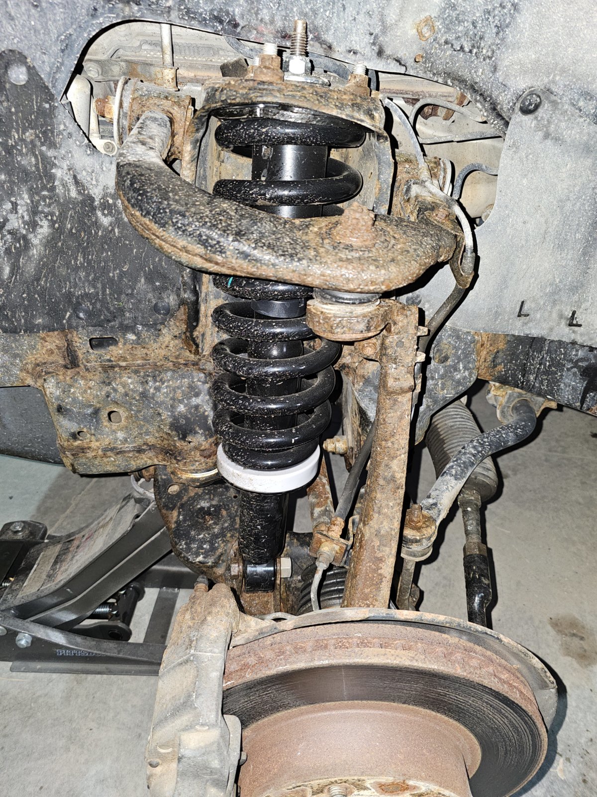

    Ok Shifty, Here are the pictures. I might be a worse photographer than i am a mechanic so stay with me.

    Yo is that the wrong shock/spring??? Lol

    What the hell is going on with the springs? Look at the spacing at the top half of this one spring; I expect springs to typically be uniform in spacing from top to bottom, or at least progressively reducing from top to bottom.

    That's a good catch, I could find one review from scamazon, maybe take it with a grain of salt, but:
    too short
    Reviewed in the United States on October 23, 2018
    compression makes it sit 3" too short!!!! can't tell until its on!!
    FCS 1345564R Complete Strut Assembly https://www.amazon.com/dp/B00BJF6R3Y

    At that price point, not knowing the brand, and seeing 3/5 stars, I'm guessing it's a shit product at a shit price, and the spring on that one side is fucked.

    So if you were guessing, I replaced a broken stock spring with a shitty new spring? Awesome!

    Is the side with the wonky spring higher? (as I would expect it to be, at least 2x-3x the height of the difference in height)
    If you measure from the center of the lower shock bolt to the edge of the spring bucket on both sides, while the truck is on the ground under its own weight, are they equal lengths?

    Nope. The spring with the weird spacing is on the driver side. Thats the side with the sag.

    Ok, but what's that measurement.
    Also, do you see any signs of welding being done? That's a shitload of rust IMO.
    How are the upper and lower balljoints looking? Identical in nature, and both look to be whole?
