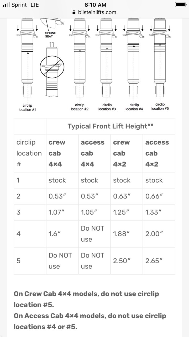

    It will definitely fit, but I think that 2.5 inches of lift fluctuates.
    If you throw those on a double cab on comparison to a 4wd Access cab, you’ll get more lift on the double cab. If you throw them on a 2wd access cab, you’ll get a lot more lift than the 4wd. Maybe a half inch. For some reason the 4wd access cabs get the least amount.

    Same thing with bilstein.
    As you can see, lift fluctuates with each type.

    Nope, not at all. In fact you may get slightly more lift than a 4wd would (like half an inch if that) and you have less to worry about. @Beefnbread is correct.
