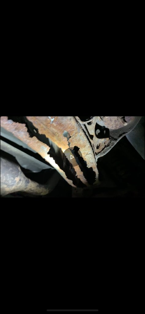

    I just bought a 04 Tundra limited crew V8 4.7 and have found that my frame is rusted and am looking for some solutions.... please give some insight

    There’s a thread or sticky that goes through all this. Maybe a replacement frame, that looks bad. Be safe.

    I would check if there are any used car lemon laws in your state or any legal means of returning it. That vehicle shouldn’t have passed a safety inspection.
    If no, you can look into things like safe-t-cap solutions from www.autorust.com or another vendor who does the same (can’t remember their name).

    Yikes! That's about as bad as I've seen. Expensive lesson to inspect prior to purchasing a vehicle.

    Unfortunately, that screenshot of a video does not look like a candidate for a patch job. That looks to be a frame replacement. Often times, when the frame is that smoked, the underbody, bed, brake lines, and axle mounts are also smoked.

    Insight: 1)Hope you didn't pay a lot. 2)PPI would have gotten you out of this mess. 3)If that's an indication of what the whole frame looks like, get it off the road! You are in danger of killing yourself and someone else. 4)More than likely, the only solution is to find a donor truck and swap frames. 5)How deep are your pockets? 6)Sorry to be blunt, but hopefully you learned a valuable (hopefully not too costly) life lesson.

    I’ve seen that type of rust damage personally and I’m 80-90% convinced it’s from rusting inside out. So while the rest of the frame may just look rusty (assumption here), it’s really not in great shape from a longevity point of view.

    Check it with a ball peen hammer.

    You don't have an issue with frame rust. You have parts of your frame missing. That truck is unsafe to be on the road. This will be an expensive lesson unfortunately.
