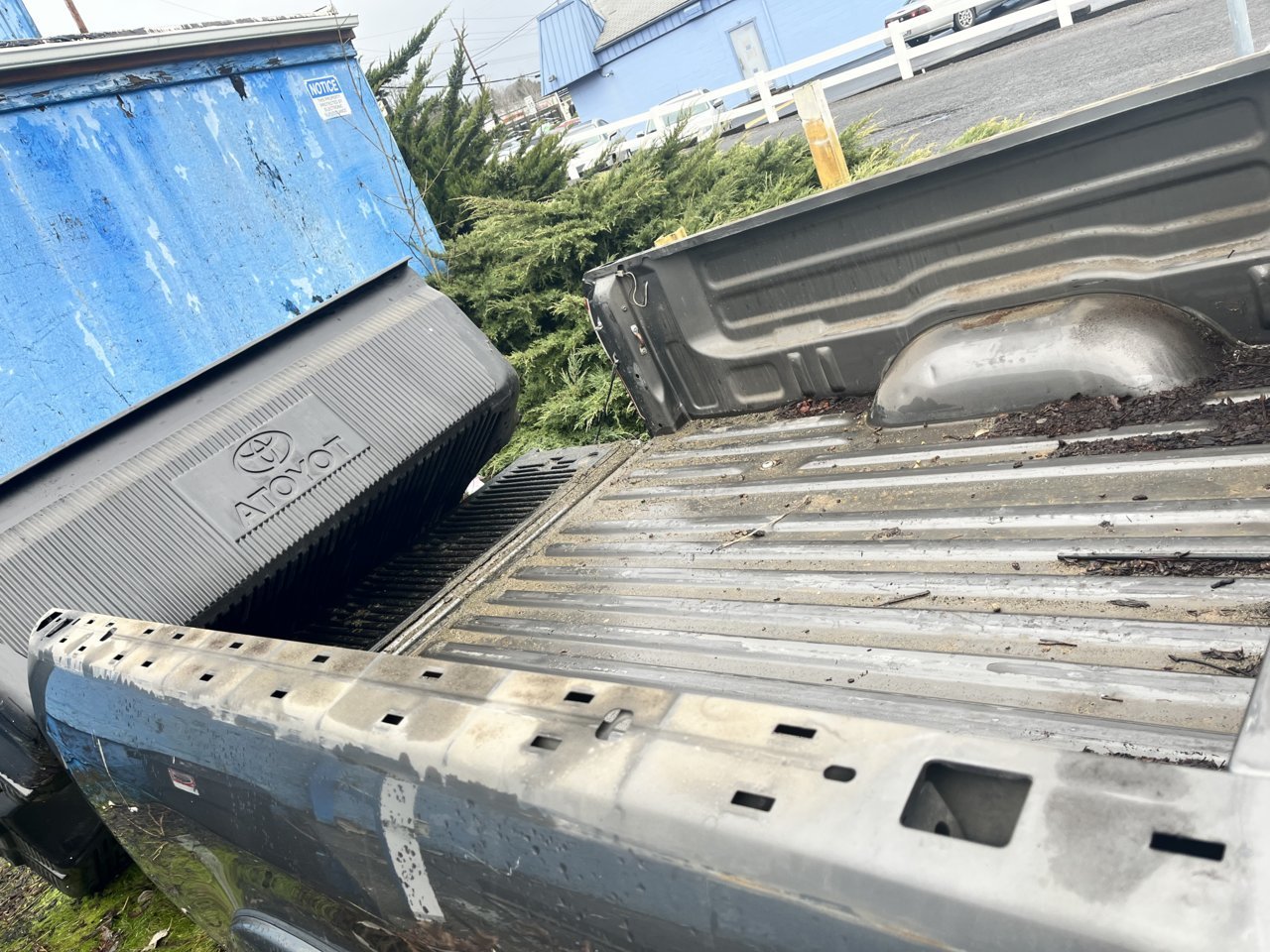

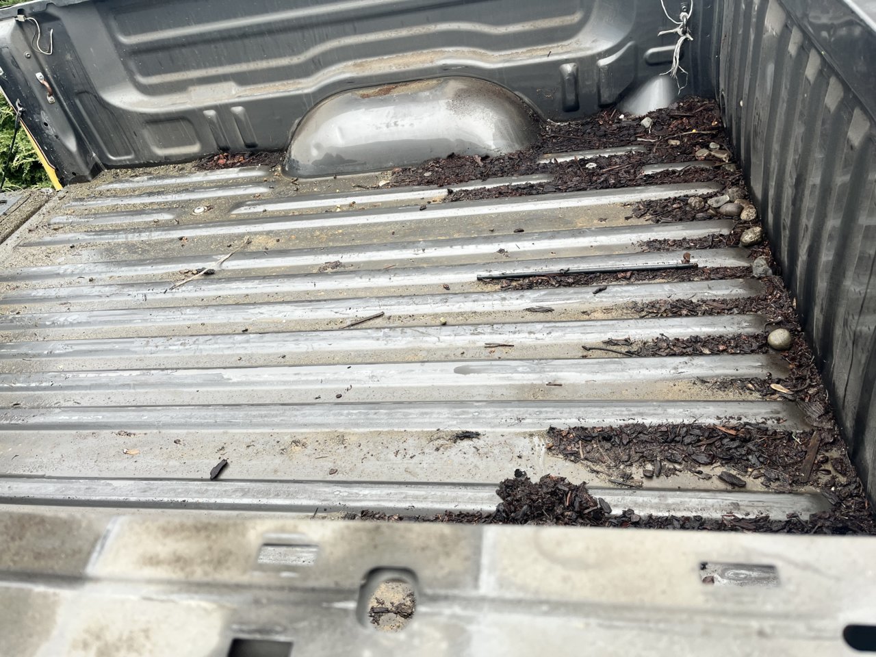

    Don't forget to check under the bedliner if you have one for rusting through the bed. Happens on a lot of these trucks.
    Leafy1975[OP] likes this.

    It's all cleaned out. gonna go to the car wash and scrub all the rubbed in grime over the last 15 years and then put back on. Thank you for your response.
