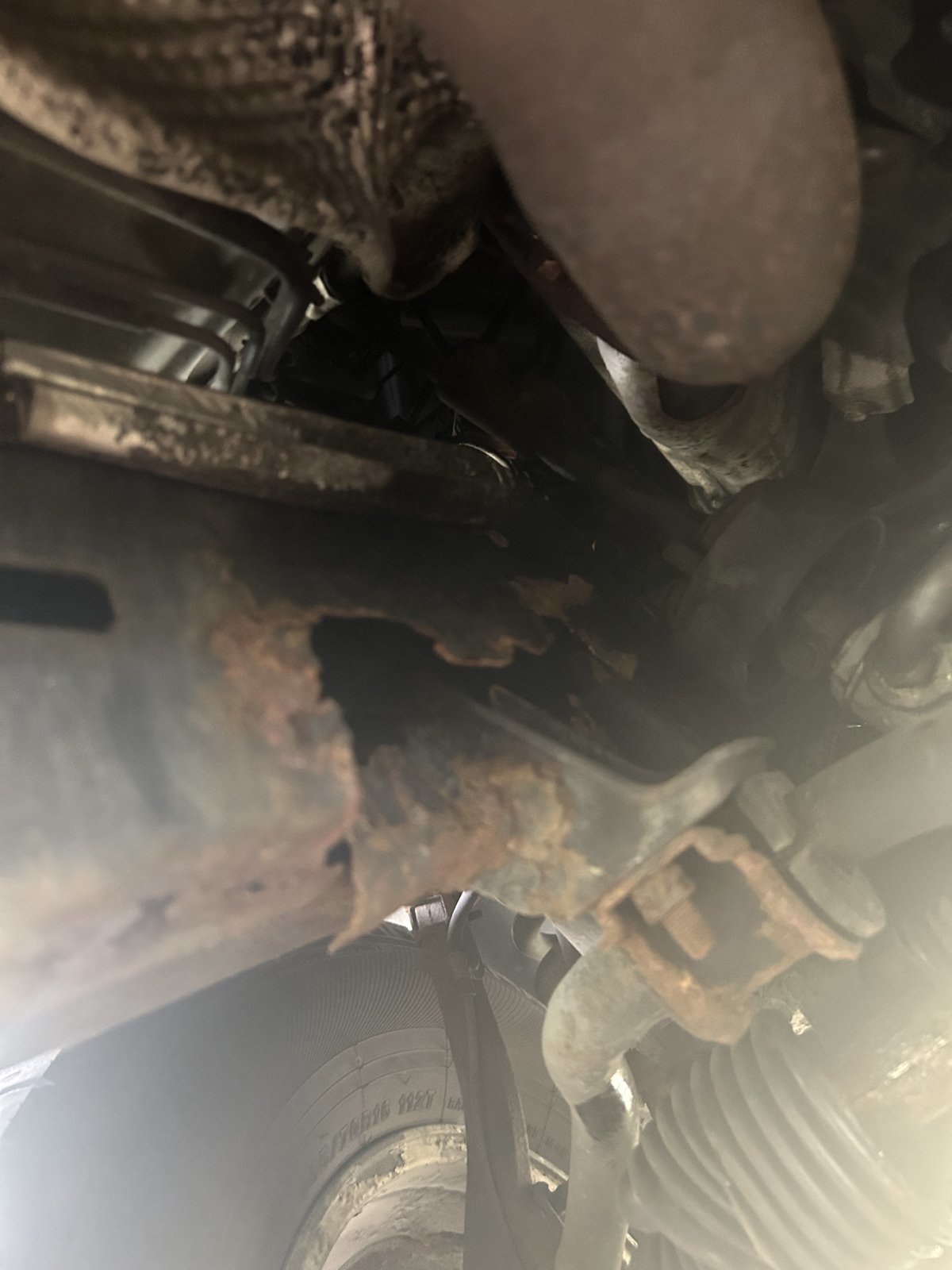

    I have a 2006 Toyota tundra. Had the frame sprayed when they did the recall in 2016, however where my frame meets the sway bar it’s rusted out. Any idea what it’d cost to get it replaced? Can I drive it?

    Ouch…you’ll be parting her out I’m afraid.

    Yeah, that's the downside to the spray: It doesn't do shit, and your frame continues to rust out from under. Hindsight is 20/20, should've done the replacement.
    I wouldn't feel safe driving around with a chunk like that missing, you'd ideally want to remove the swaybar. A lot of welding shops won't touch something like this due to liability, if the frame does snap, guess who gets the blame?
    That's not even a commonly-bad location. If it snapped at that mount, I have zero doubt in my mind some of the worse-impacted areas are not far behind, which is why I'm with @CCE525 on this one: Time to part it out and recoup some $$.

    It also looks like you have a boot/bellows that's wide open there too. Which makes me wonder how much overdue maintenance you may already have...

    That appears to a little more than a stabilizer support problem.
    How does the outside of the frame rail look? Is it compromised as well or in good shape?

    The frame rail is in good shape. This is the only part on the frame that’s rusted out. Definitely over due on maintenance. Just replaced the boots/bellows. I’d hate to get rid of it but if I can’t salvage it. I’m taking it to a good frame shop tomorrow to get it quoted or to even see if they’d touch it. Other than this, the truck runs great. Great body, no damage. With 179,000 on it.

    $1300 to fix it including the strap on my gas tank. Other side is in good shape. They took a look at the rest of the frame and beat on it. Told me I had a tundra in really good shape & if I ever wanted to sell it bring it there lol

    It's repairable, anything is. This is why you must spray oily wax based coatings inside the frame rails for ALL Toyota frames in northern or wet climates or for off road use. They usually rust from the inside out, or wherever their is sandwiched steel layers.
    1st, inspect the entire frame, make sure it's worth your investment in fixing this.
    Then I would use 1/8" sheet to plate inboard side and bottom of frame, and then weld the sway bar bracket back on.

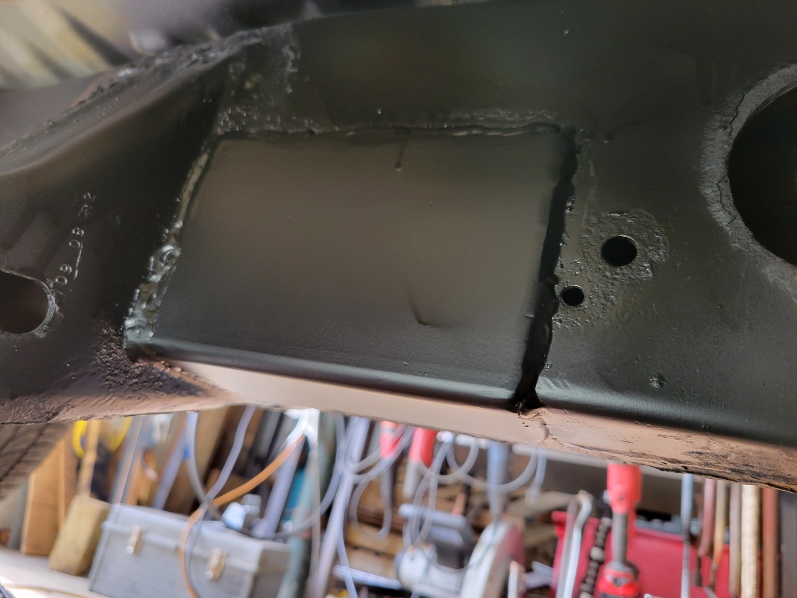

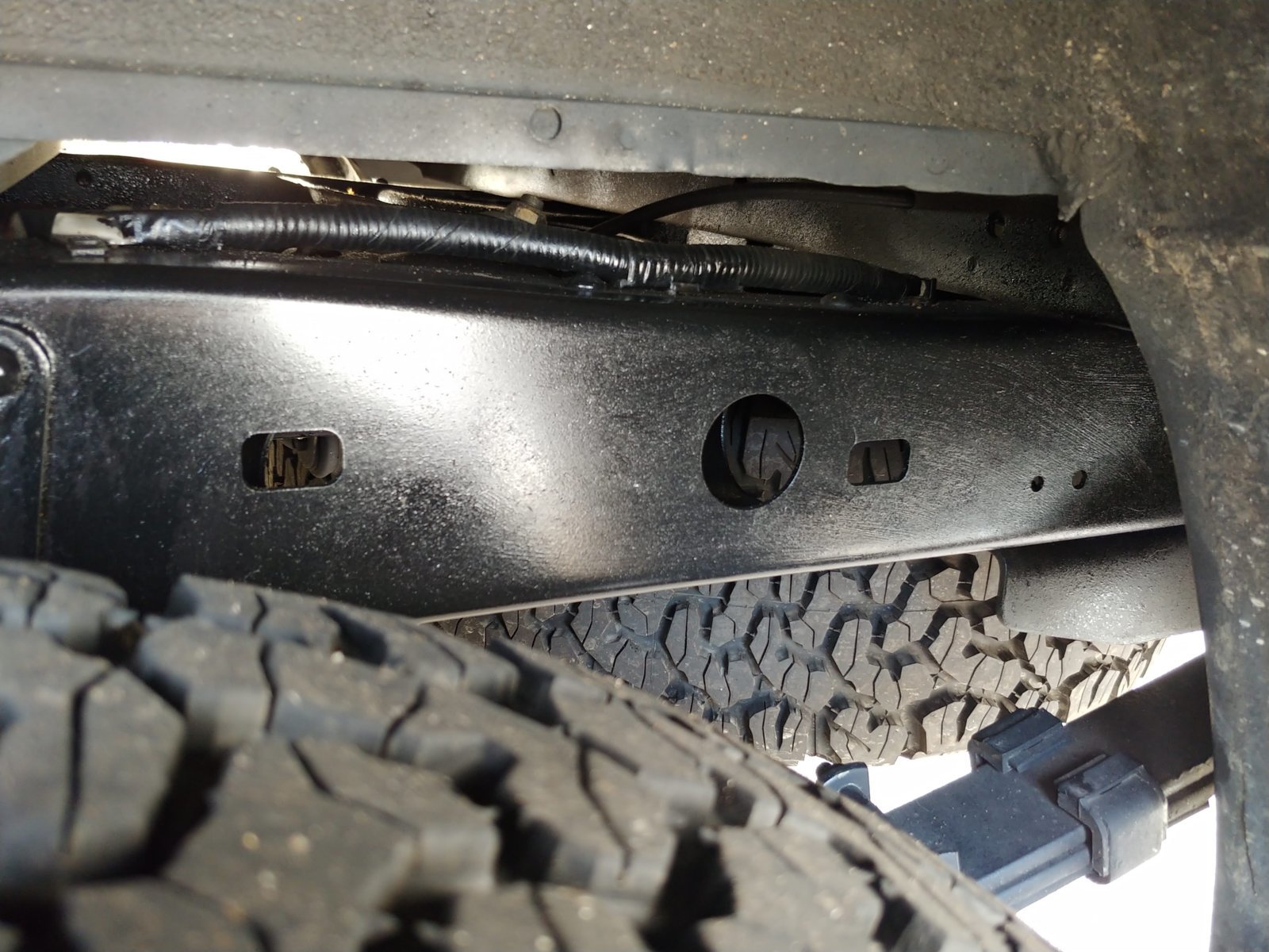

    Here's a Tacoma frame with similar rot repaired using an angle cut out of 4"×4"×1/8" wall tube. Note how there in the hole picture there's black paint on outside of frame but inside is totally rusted.
