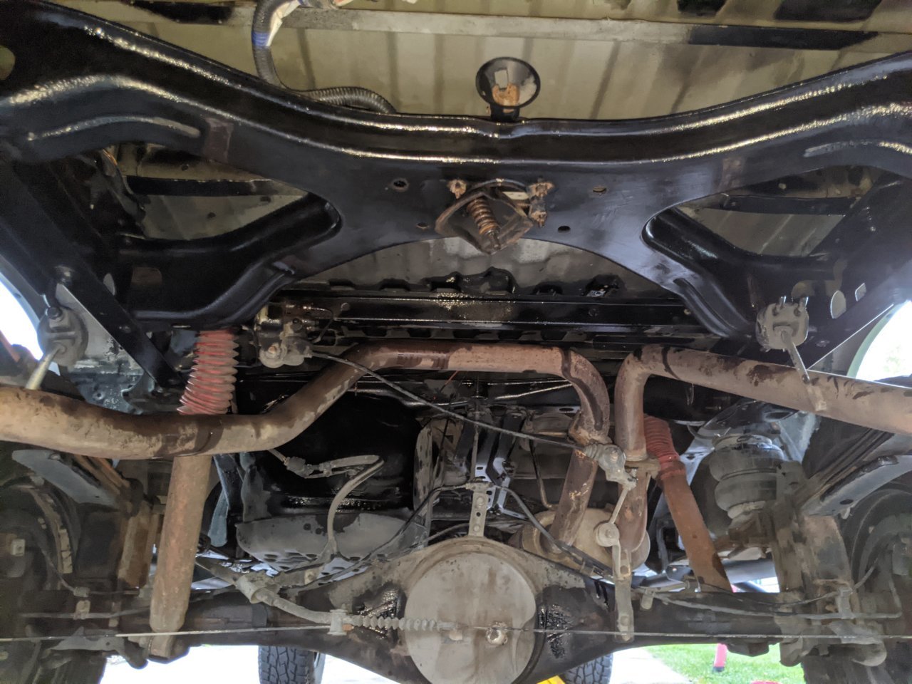

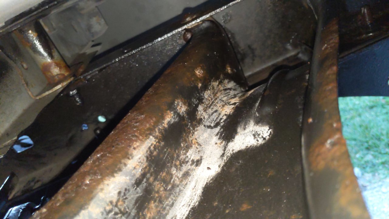

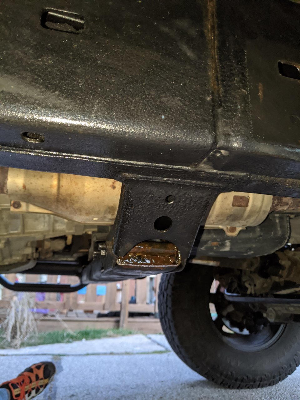

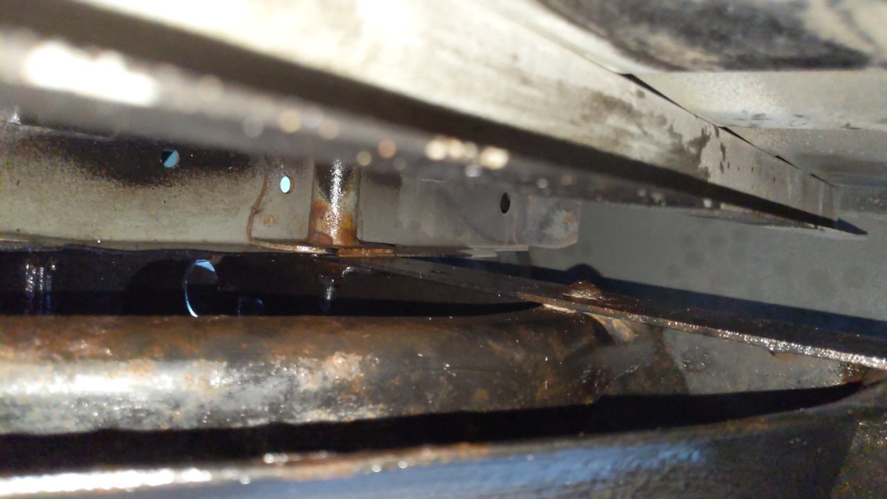

    I said I would take more pictures in the https://www.tundras.com/threads/any-good-frame-oiling-recipes-out-there.76534/page-3#post-1963537 thread...but figured I'd just started another one with all of these pictures and shit.PXL_20201103_230612024.jpg PXL_20201103_230736834.jpg PXL_20201103_230807844.jpg PXL_20201103_230853790.jpg these are from top side of rear cross member where spare is

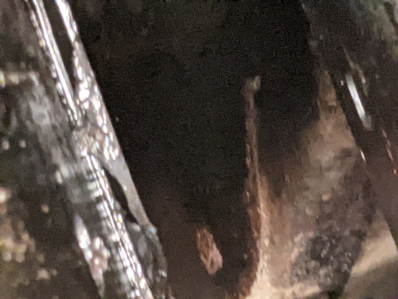

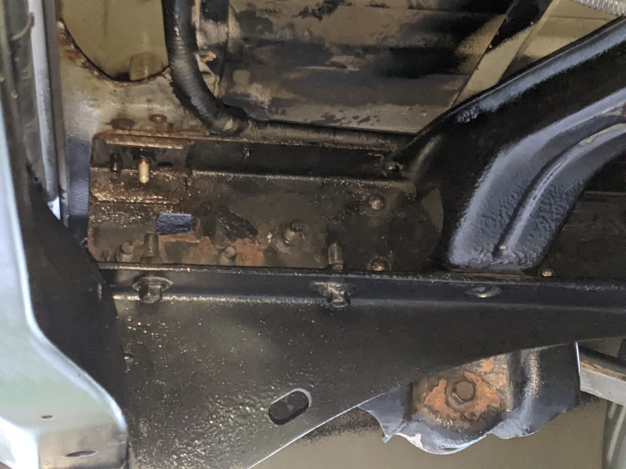

    PXL_20201103_230914866.jpg PXL_20201103_231323495.jpg PXL_20201103_231448560.jpg PXL_20201103_231646331.jpg PXL_20201103_231543790.jpg

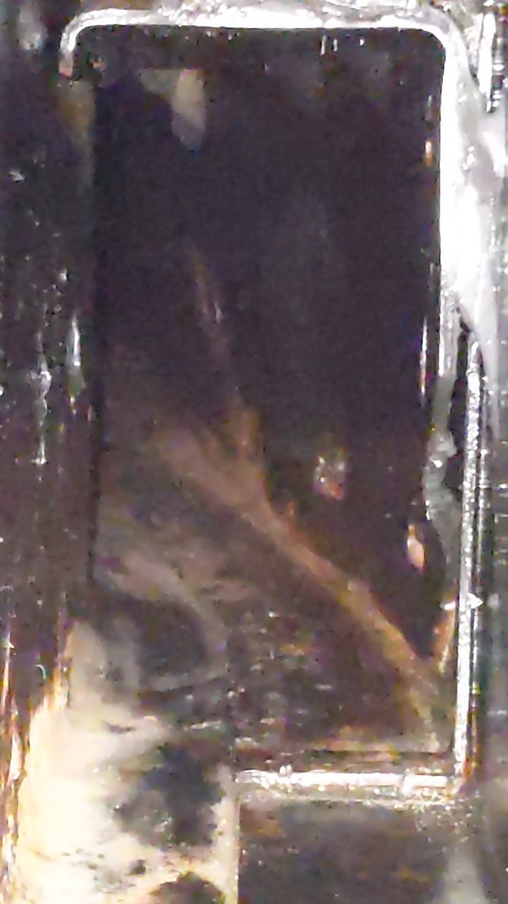

    This is a shot up into the boxed frame towards front on each side. Don't think it looks that bad, could it look brand new? Yes but....
    I started the PHM @Professional Hand Model method of rust prevention/maintenance the other day in the thread above. I've pretty much got everything I want to and can reach by hand with the grease. I say want to because I'm not quite sure if the grease will lock in any moisture and make things worse in these "trouble" spots. Which are just surface rust currently. Other than a hard to get to and see spot right tight to the gas tank. It's not horrible but believe the fluid film will donuts job til I can get in there.
    Think what I'm gonna do in the X/rear cross member is spray FF on the top side and thennnn nest spring that bed is coming off and I'm doing it all from a standing position.

    Did you clean your frame before application? If so, how'd you do it?

    Looks great I would not worry at all. Wish mine had looked that good.
    Also the Ff will keep out oxygen which it needs to grow.
    Good as that is I would not waste the time to pull the bed unless really bored.

    I wouldn't say I cleaned it. It never really gets that dirty. I spray up underneath in the winter amd some times during the rest of the year. I'd say it's better to not introduce more moisture right before doing this sort of thing.
    Just used a wire brush and a flat putty knife. Wasn't a whole lot to work. Sprayed the welds and rusting areas I could find at the time with on blaster, about 2 days prior. Then sprayed FF where I needed, waited a day or 2 then went to town greasing what I could. Probably gonna but 1 more can of FF and hit some more spots I didn't see first go round and call it good til I either do more work on something else and find an area or next year when I pull the bed

    i would at least hit it a wee bit to take light scale off before puting POR down, but yea, POR works wonders
