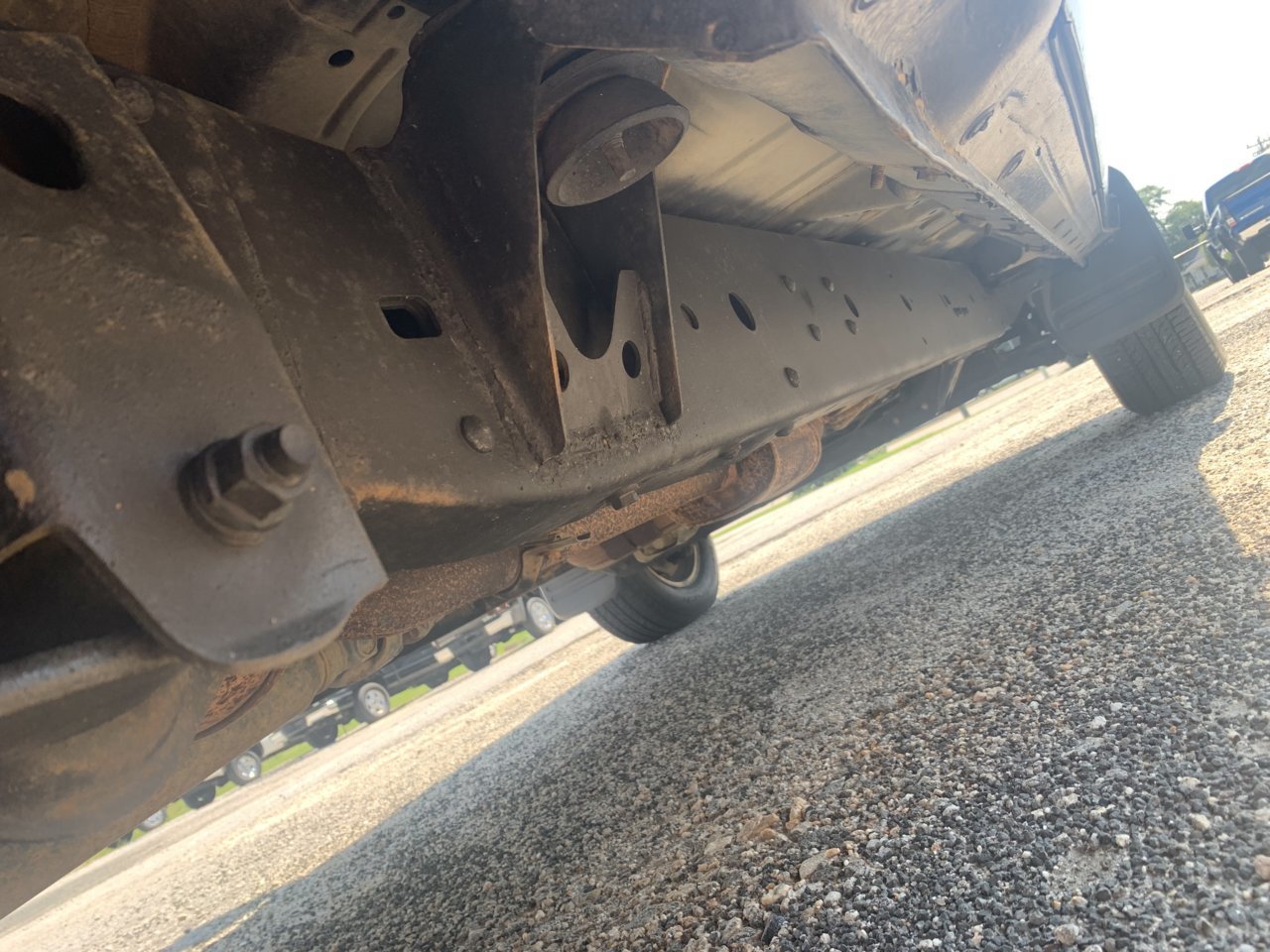

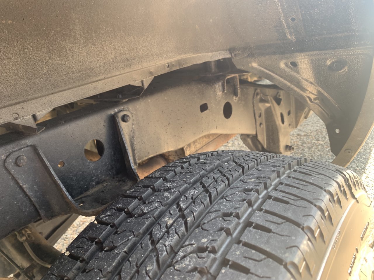

    Looking at a 05 Tundra Double Cab 4x4 tomorrow. 176K miles. Truck looks clean, carfax is clean. There are a few sales through auction, but other than that 2 owners in the PA area. I am in SC. The guy sent me two pictures. Does it look like its been painted over, concerns? wants 11,500.

    I would want a lot more than 2 pics, but it looks like that frame may have been replaced already. The welds look kinda funny, but it does not look bad in my opinion.

    Unfortunately the only two I have until I go to see it tomorrow. I will try to get more. It was mainly in PA, so I figured it definitely experienced salt on the roads.

    Get a look at the spare tire cross member. I'd also get a pic from underneath/inside behind the rear tires on those beams. They can look good on the outside but be all patched up on the back.

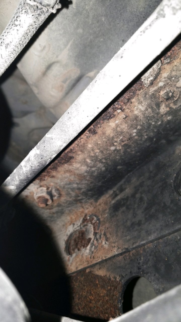

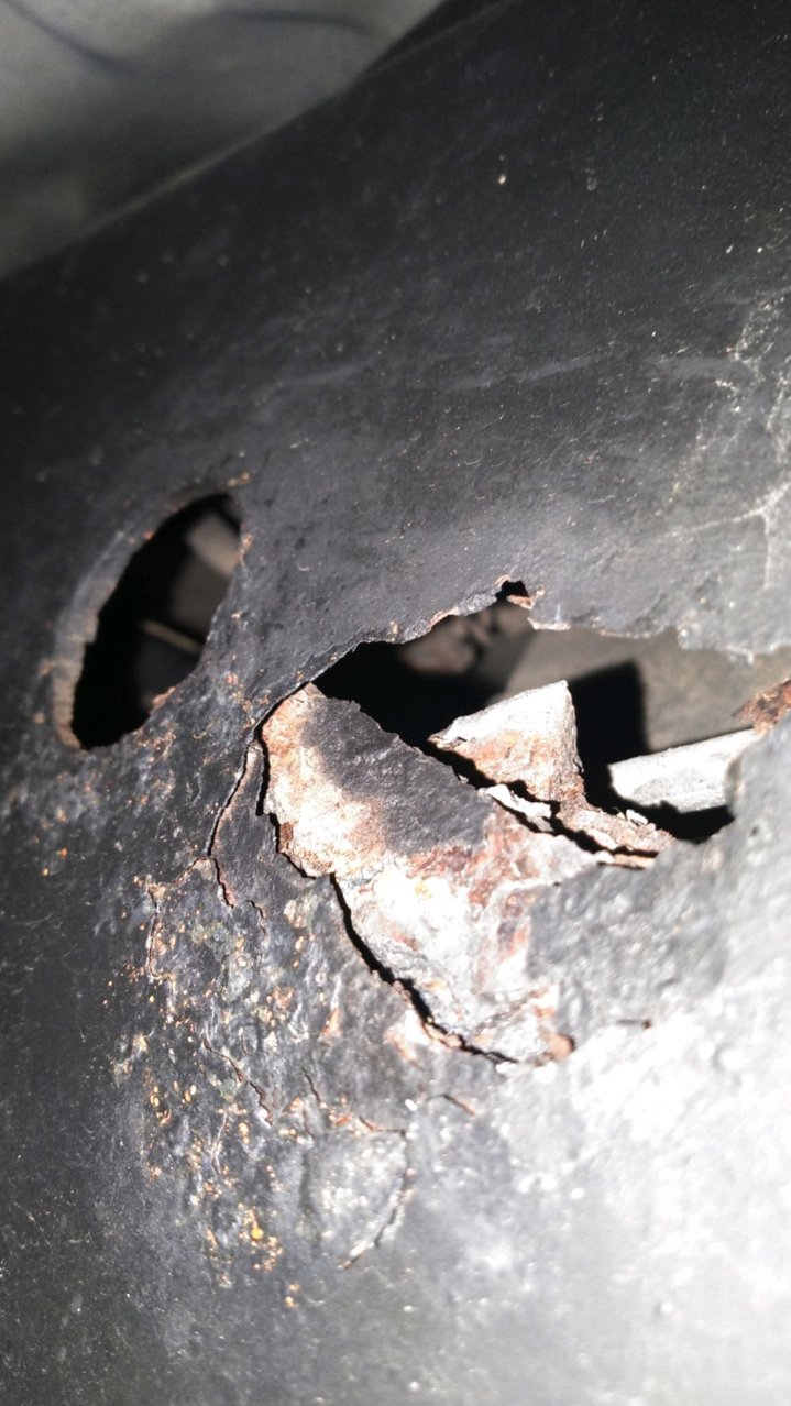

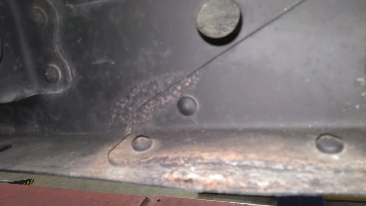

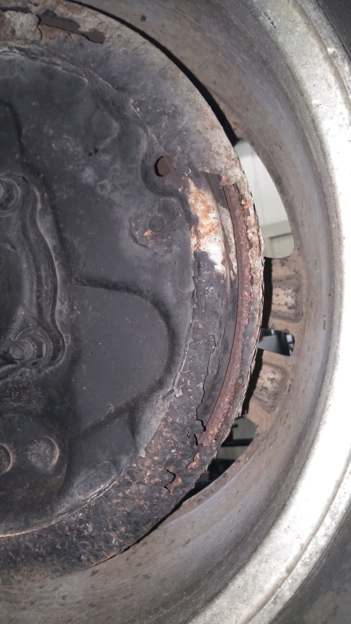

    Here are some pictures. Thoughts? These are from a Toyota inspection at a dealership.

    It has a gaping hole in the frame in that last pic and some other areas that looked concerning. This one looks like a hard pass.
    How much are they asking for it?

    This. If there are holes in the parallel rails, there are holes elsewhere. Doesn't matter how much they're asking. Unless you have a compatible donor frame, it's on its last leg.

    You can get sub-150k mile trucks with perfect frames in Atlanta right now for less than their ask.
    With the frame in that shape, it's unable to pass inspection in several states requiring inspection. In my opinion, that's a $2k-$3k max truck, but would only net you money if you parted it.

    Walk away; the metal layers have already begun to de-laminate. Probably from the crusty top coat which should have never been done with whatever is used there.

    based off these pictures.
    this trucks worth $1200 max.. its needs a $15K frame swap
