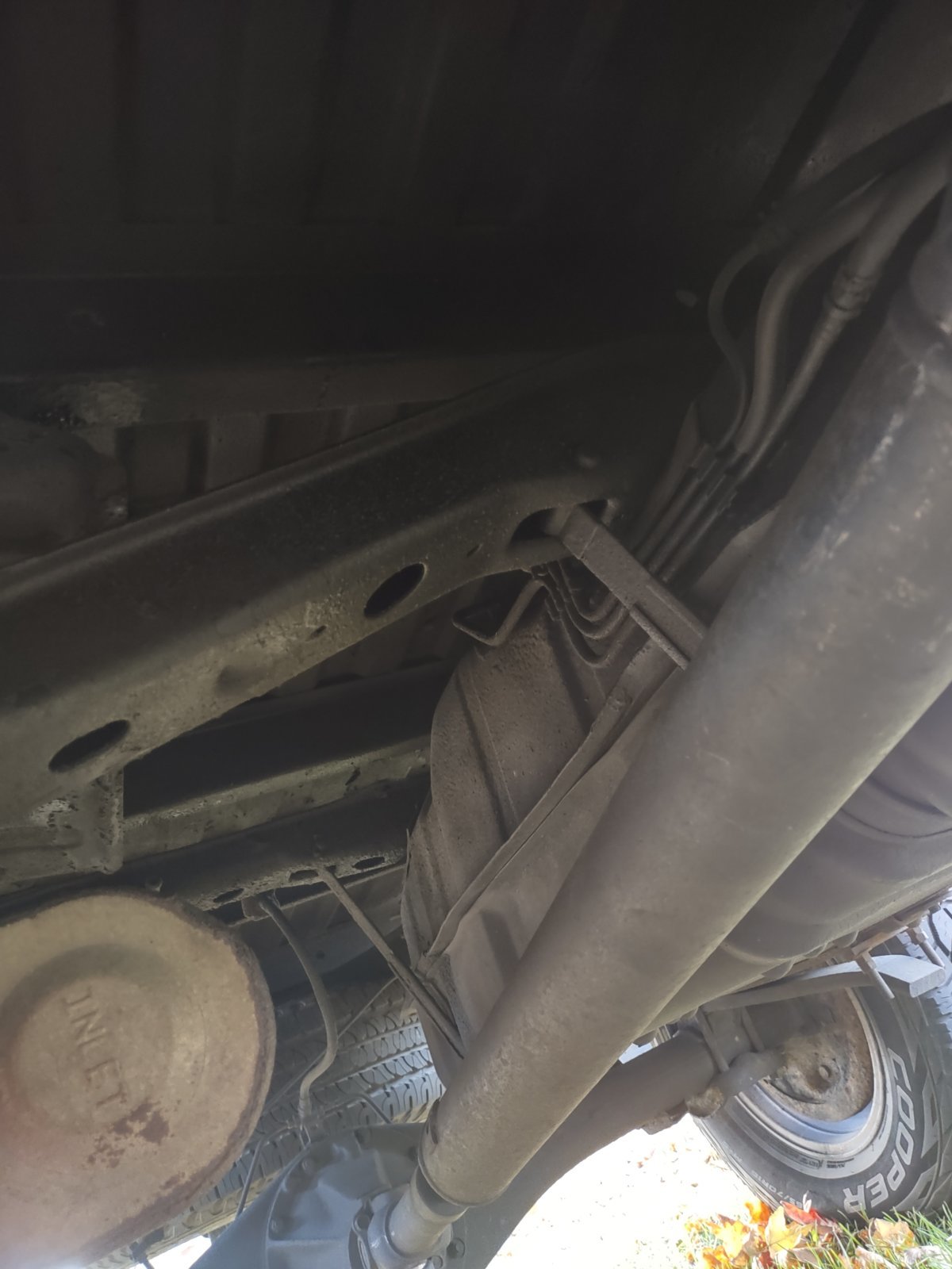

    Let’s see some pics of this frame

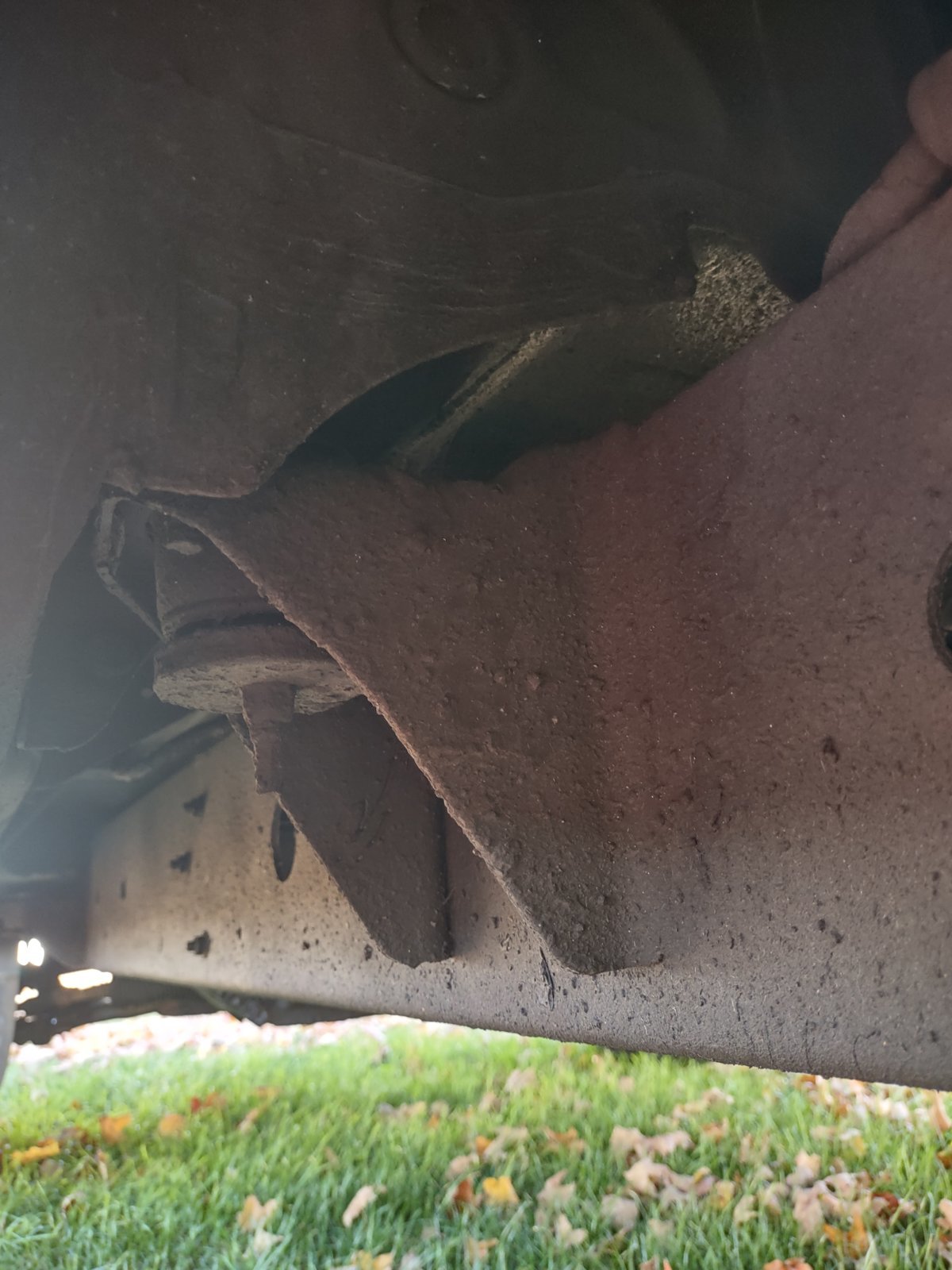

    The rust bubbles are from underneath the spare tire area

    :ballchain: Just seeing that on my truck would compel me to grind it all off and treat it properly.

    There's definitely rust under a lot of that.

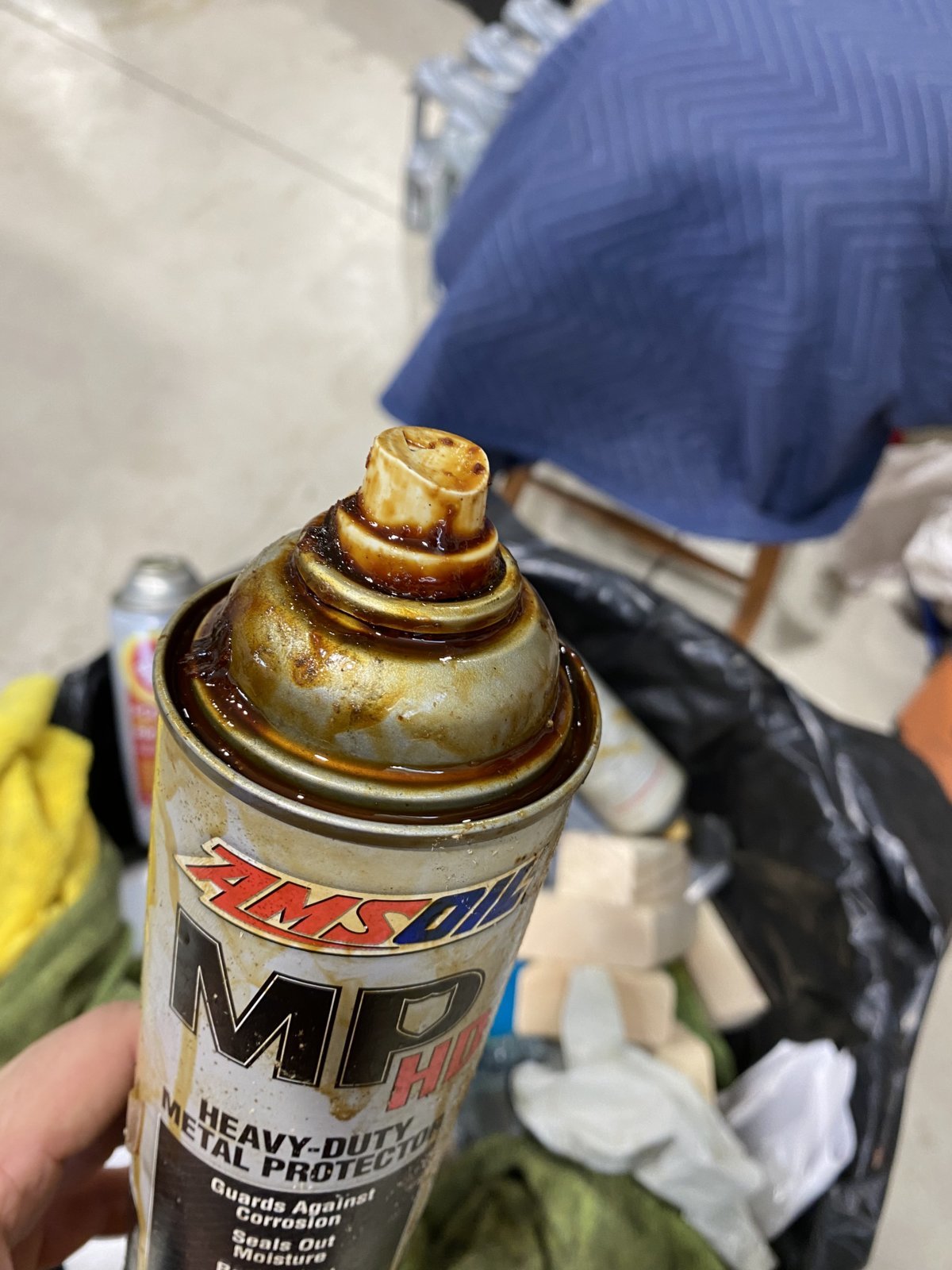

    IMG_4606.jpg I was coating the frame on my 2015 for winter today and had a mix of products... Fluid film, Amsoil MP, and some PB blaster Surface Shield. I have been using FF for years with good results. I picked up the Amsoil and thought it would be better in the fender wells because it doesn't wash off easily. Honestly PB is the best for applying with less smell. I haven't seen it yet so we will see. Northern Ohio loves to spray brine and salt so we are definitely the proving grounds. The Amsoil cans suck. It sprayed as much product on my hand as it did on the truck for 2 of my cans. I emailed amsoil and they want a receipt to replace it. I sent pictures and an email. I think I will be doing to CRC next year. For $15.00 a can I am probably done with amsoil. All of these products work well. In 9 winters my chassis is still very solid. Some surface rust but all still there. Attached is the pic of the Amsoil Fail LOL
