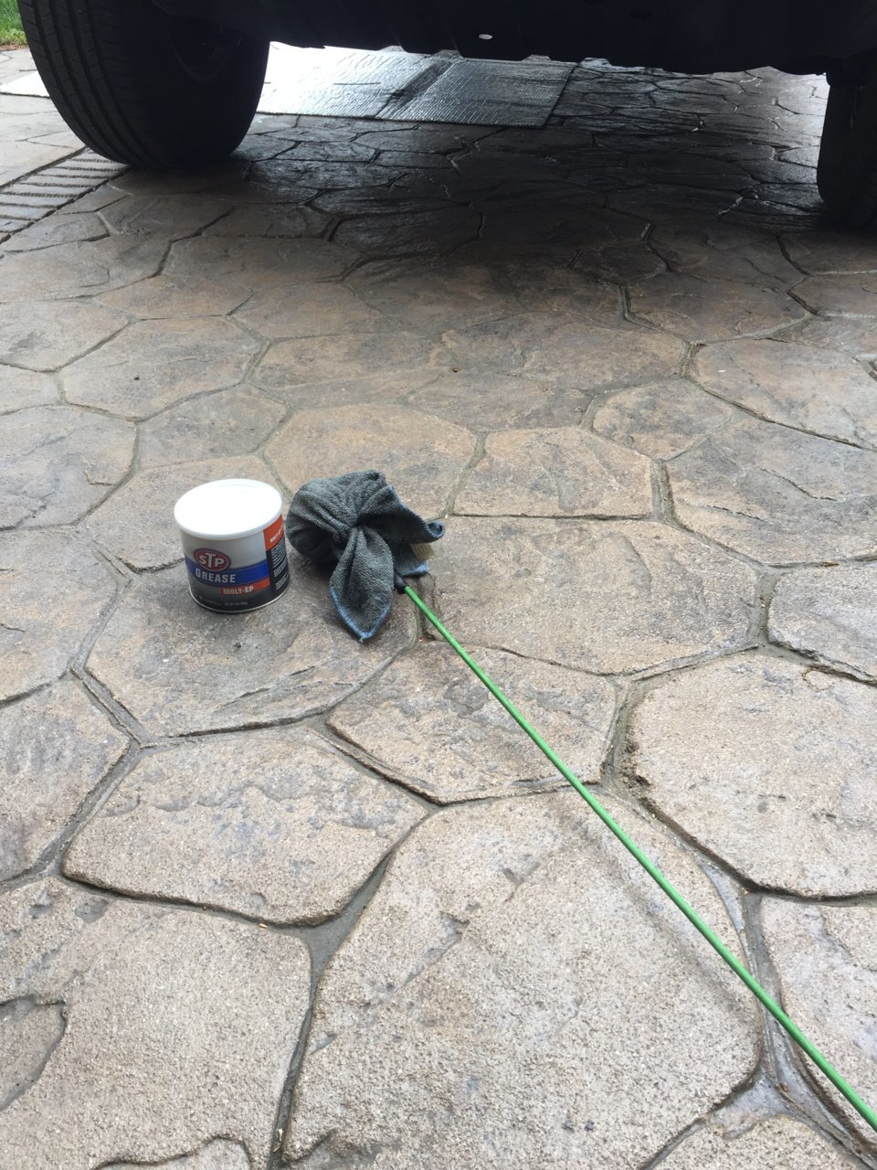

    It you are DIY and you want to do it right the first time with about $5-10 in grease and $7 in PB Blaster then do it my way. Probably will last a lifetime with about 5 hours hard work under the truck.
    1) Go under and spray every crevice on frame that your PB Blast straw tube will fit. This acts as a primer penetrating the welds and thirsty metal frame pores. Also lightly spray the frame.
    2) After the PB has soaked in, load up a sponge and hand rub your frame with a layer of Moly-B Grease bought in the tub. Use a flexible rod to shove the sponge and rag down your hard to reach box frame towards the front portion of the truck.
