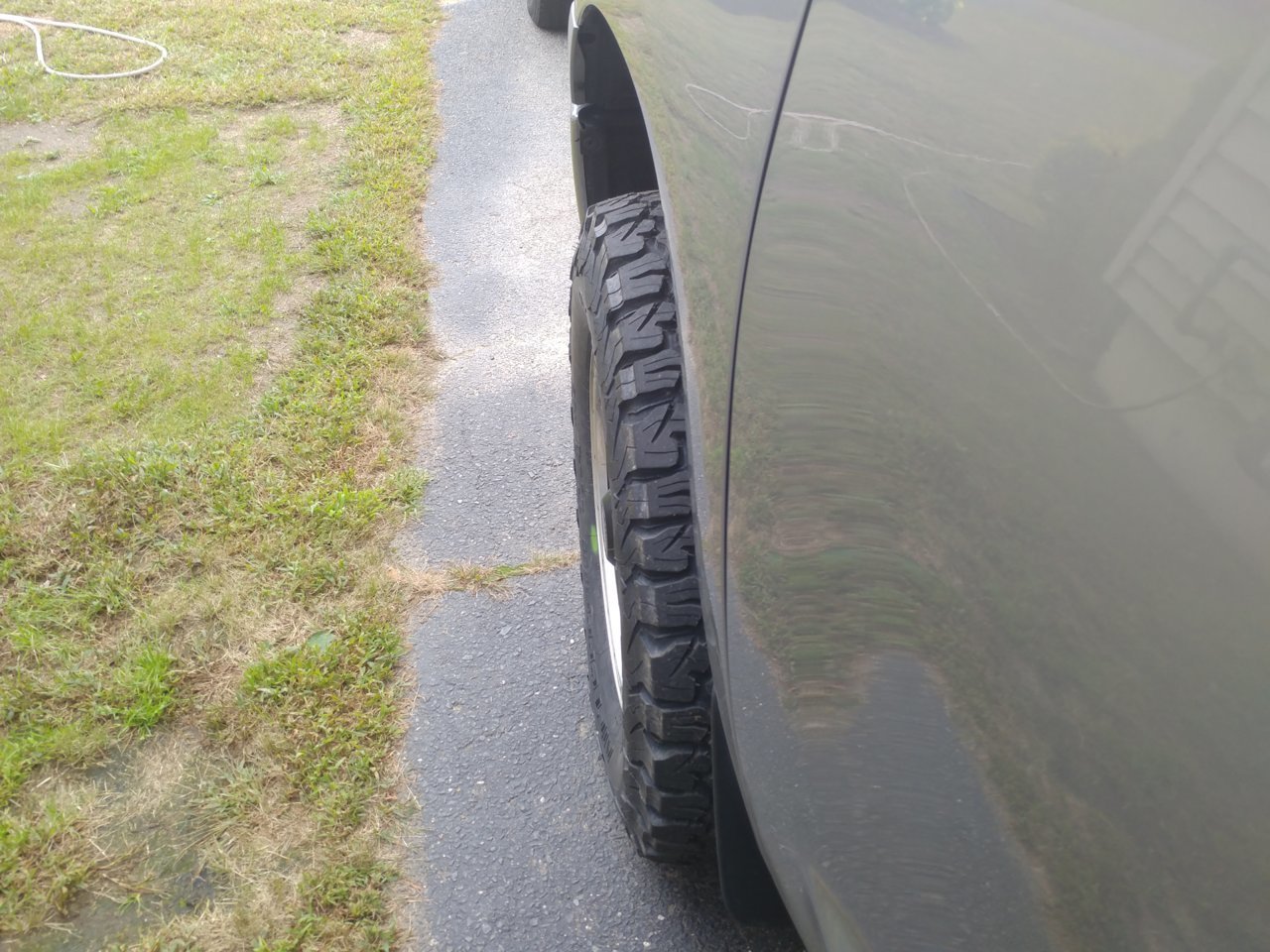

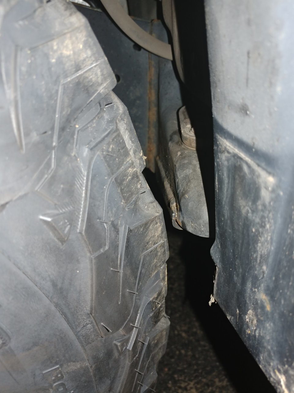

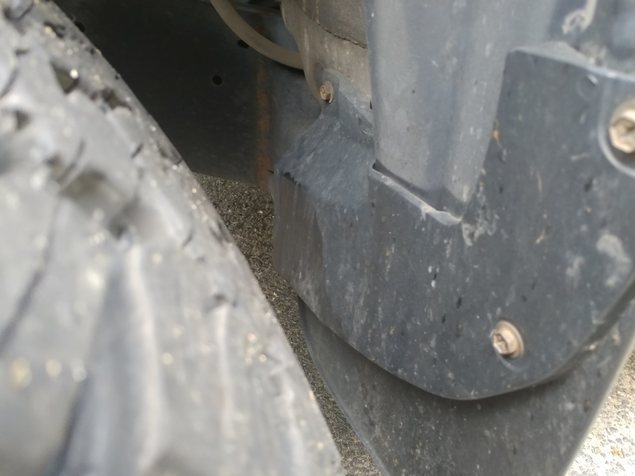

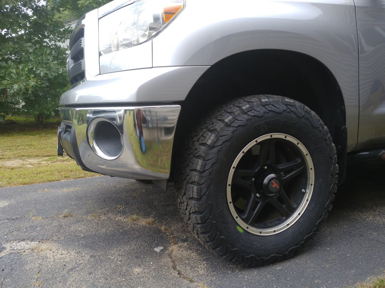

    Imagine many have ran into this. Just purchased new tires after 3/1 leveling kit. BFG's 305/65r18 (33.5×12.25) getting rubbing on inside of front tire rear flap. See attached pics. Any suggestions greatly appreciated.

    Just take the flap off. You gain an extra 1/2-3/4 inch I think. I had to take my front and rear flaps off both front wells.

    Took mud flap off. Have about a 1/4". How do most get away with 295/70r18 with 3/1 lift when tire is larger?
