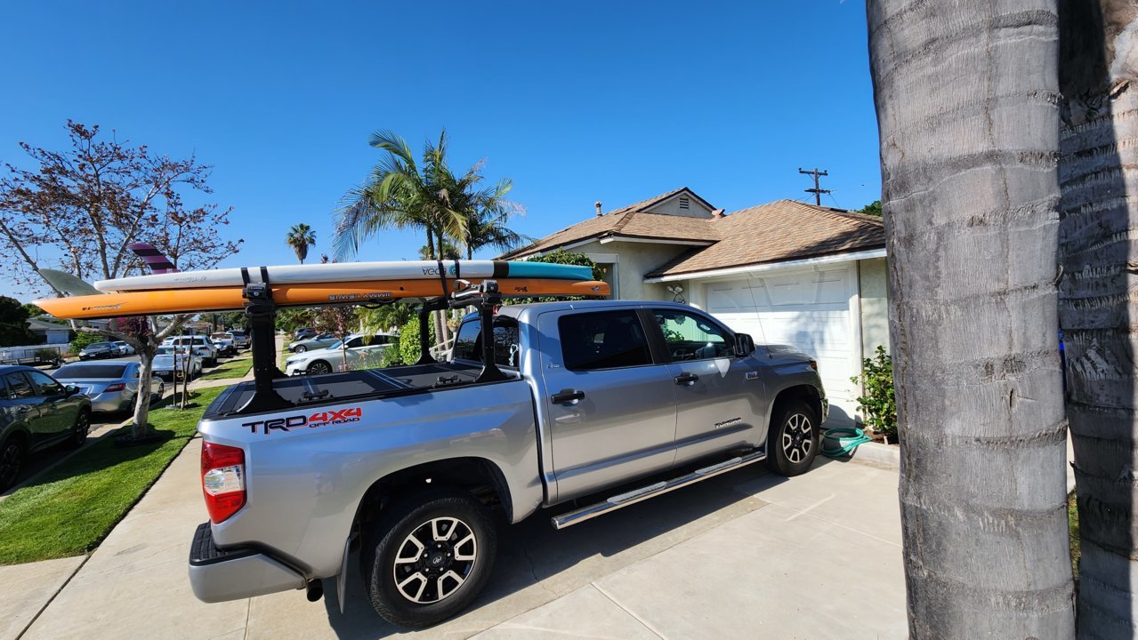

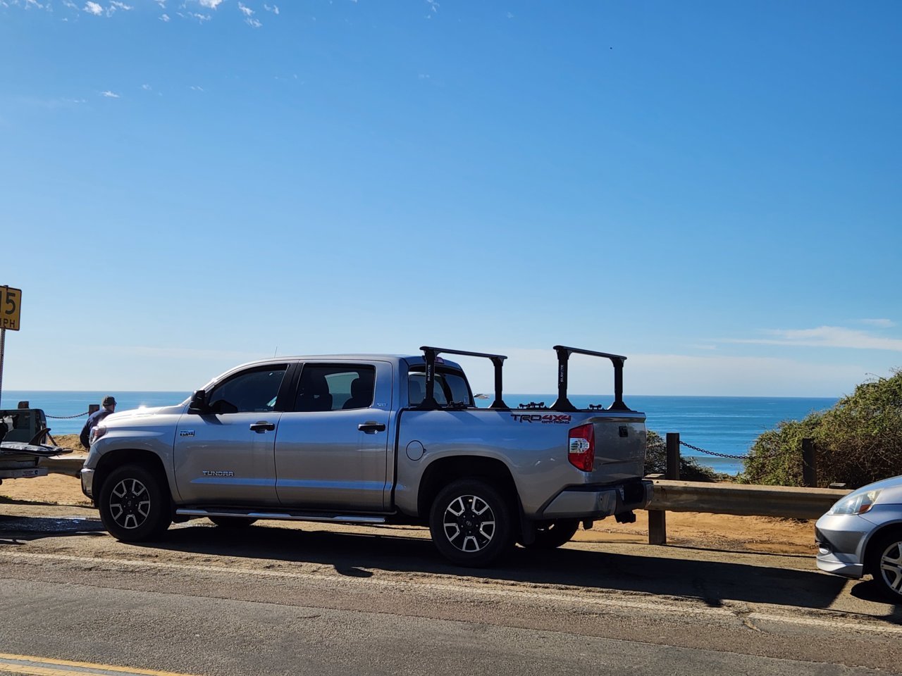

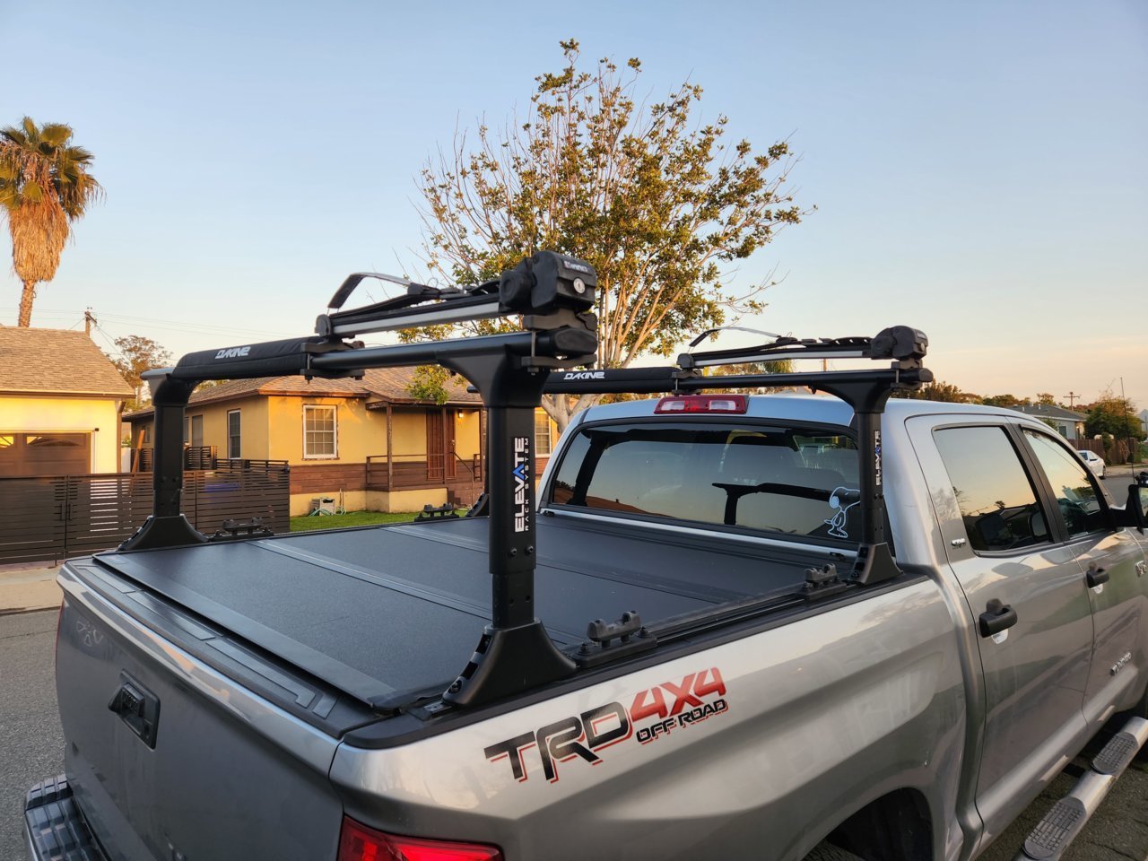

    Elevate T-Slot Rails/Racks are pretty quick and easy to take on/off.
    8 nuts in total, maybe 5 minutes w/cordless and racks are off. I take mine off when I go to the carwash. Low/Med/High settings, but you can't open a Tri-Fold tonneau on the low.
    Diamondback might be the only one that's strong enough to go directly on it, but then you can't open it with a RTT on there can you?

    That looks really nice. My truck already has the Extang Solid Fold 2.0 cover on it. Maybe I just keep my current cover, go this route for the rack, and remove it when not in use. I appreciate the help.
