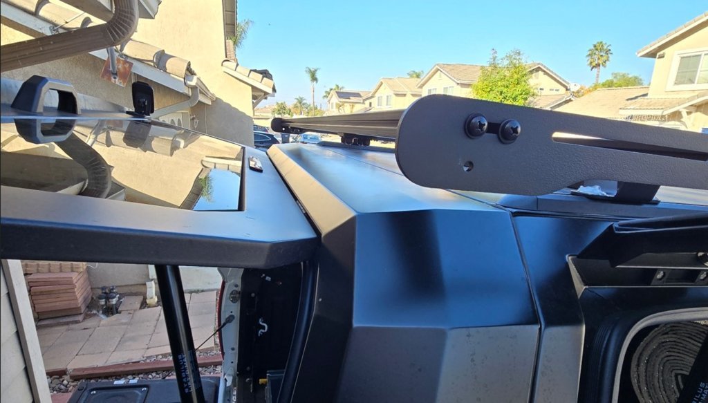

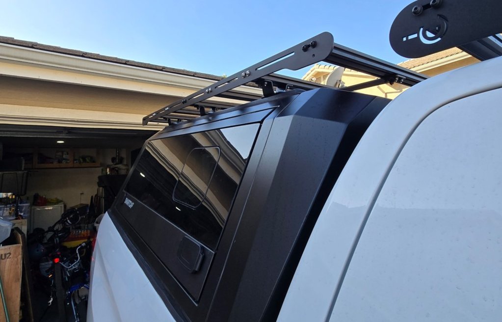

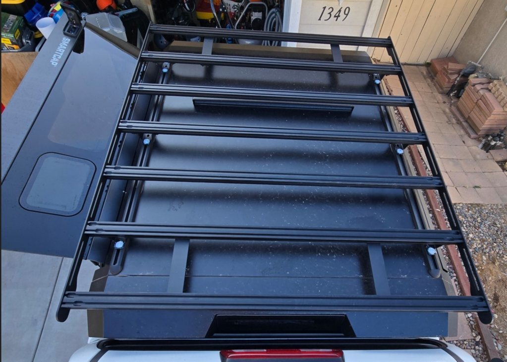

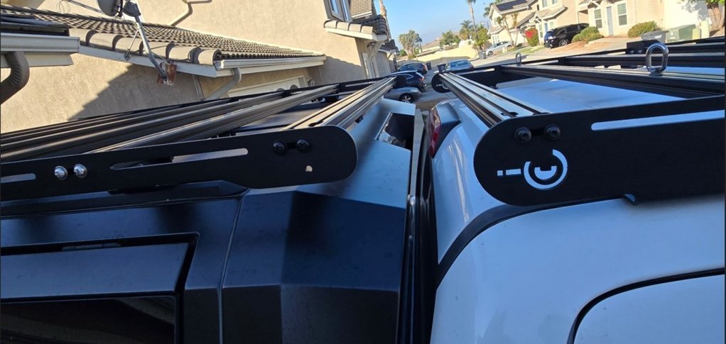

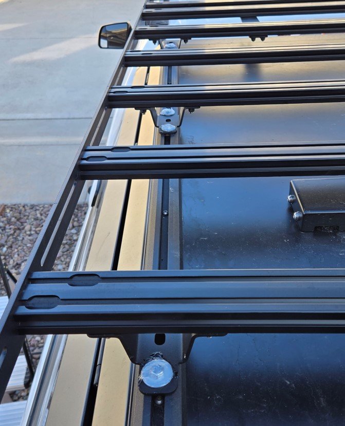

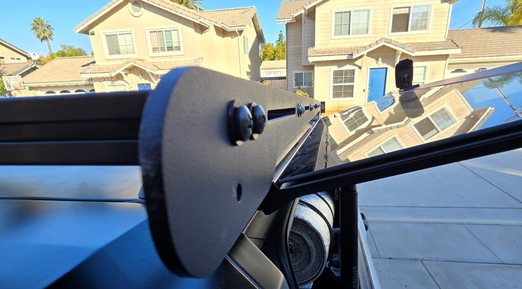

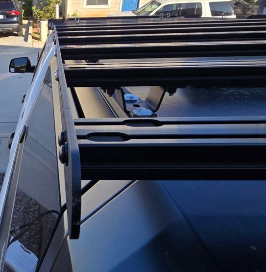

    Hello everyone! Figure to contribute will all the great information that I get from here. I have a 2019 Toyota Tundra Crewmax. I installed an RSI Smartcap Evo Sport and been trying to decide if I will be installing a load bar or a top rack. I initially ordered the RSI load bars however, after a conversation with RSI, since the demand is high, they will not be even shipping until January to their authorized dealers. I then decided to look at the Prinsu top rack since I have a prinsu roof rack. I installed a Universal Top Rack 5.5' X 54". From the Youtube and all research that I did, which I found mostly Tacomas. The concern that I have is that it was hitting the gullwing doors when opened, which is not the case when you have a Tundra. From the most video that I saw also, is that most people are installing only two mounting brackets on each sides because of the nut plate not fitting the track the RSI Smartccap comes with. I had to cut the nut plate with a grinder, total of 12. It was not bad if you have a steady hand, crimped it with a vice grip and clamped it to the bed of the truck as I was doing my precision cutting. Hope this helps someone in the future.

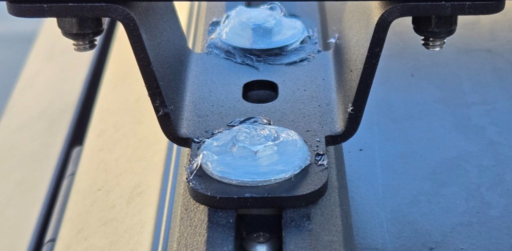

    What was the purpose silicone on top of those prinsu to smartcap interface bolts? Is it not going into a t-nut in the channel?
  7. Dec 6, 2024 at 8:43 AM
    gcarlo001
    gcarlo001 [OP] New Member
    Dec 6, 2024
    #126935
    5
    Carlo
    2019 Toyota Tundra
    Trying to prevent exposure from weather elements, dirt, grime, increasing the possibility of corroding. I pretty much copied the instruction when I installed my Prinsu roof rack.

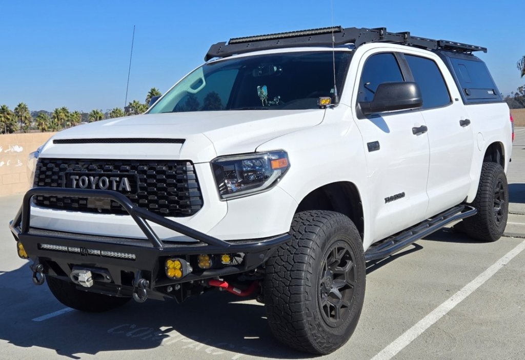

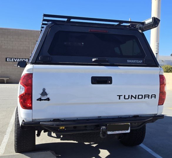

    As promised.

    what rear bumper do you have? my RCI arapaho bumper is heading my way but i cant find a rear bumper that i like. that one is clean and it still has a receiver
  11. Dec 7, 2024 at 11:24 AM
    BiggHertz
    BiggHertz DZTLIMO
    Nov 24, 2019
    #39101
    2,110
    Chandler, AZ
    IG: dztlimo
    Stuff and Things
    looks like an ss built
    brevard828[QUOTED] likes this.
  12. Dec 7, 2024 at 4:47 PM
    gcarlo001
    Dec 6, 2024
    #126935
    5
    Carlo
    2019 Toyota Tundra
    ss built
