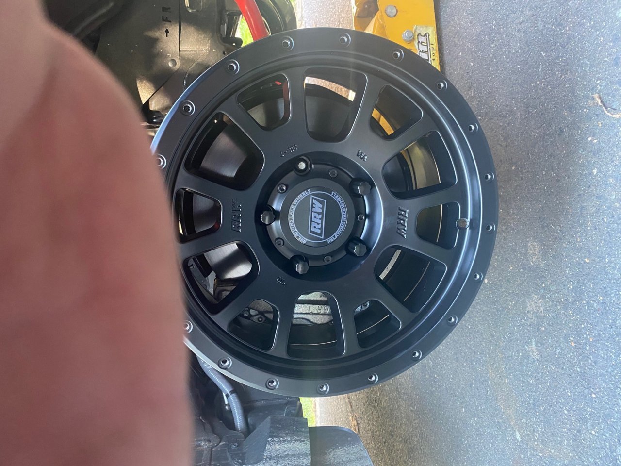

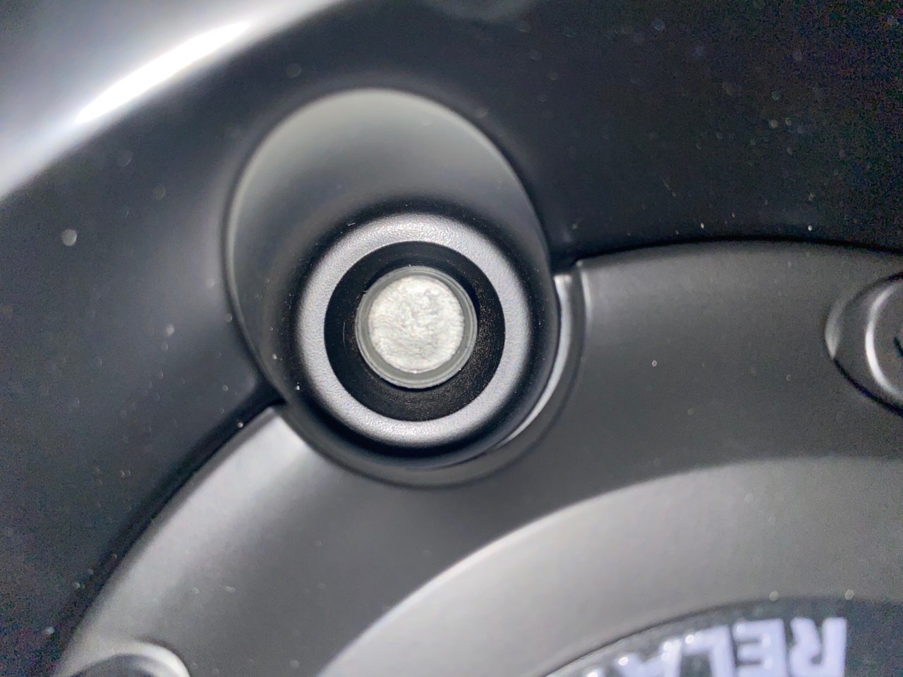

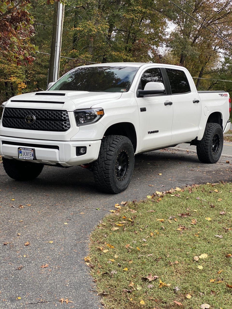

    Hello all,
    I recently purchased and received some RRW RR5-v wheels and noticed immediately that the lugs they suggested only went on and tightened up 5 turns on the front. "I have not test fitted a wheel on the back as of right now". I did alot of research and see where people suggest using an Et style lug and some do not suggest it. I used some micrometers and the lug bore on the wheel has an od of .059" and the lug itself is .049'" od so i dont think there will be enough room for et lugs. Has anybody ran into and come up with a fix for this besides longer studs that wont match the back? My truck is 2 months old with 500 miles so I would like to not to change out the studs.
    Thank you all very much for any help.

    Hey Ben, yes i figured it out. I installed longer front wheel studs “very easy”. There are others out there that don’t install longer studs but I wanted to have more positive thread engagement.

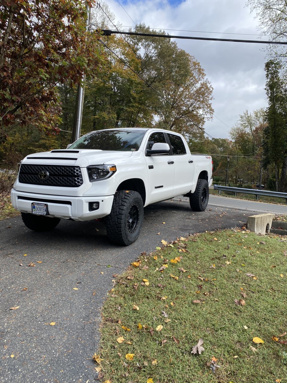

    Can I ask how big of rim and tire you ended up with? It looks like a 17". Whose lift and how tall is it?
    The truck looks really good and I like that stance. I have a 19' limited that I'm slowly upgrading things on
  6. Dec 29, 2020 at 7:02 AM
    Mrf1987
    Mrf1987 [OP] New Member
    Sep 2, 2020
    #51663
    244
    2020 Trd sport tundra
    17"
    truck has 17x8.5 wheels and 35x12.5 toyo rt. I am running the king 2.5 extended travel up front with jba upper control arms. In the rear im running king 2.5 and toytec shackles

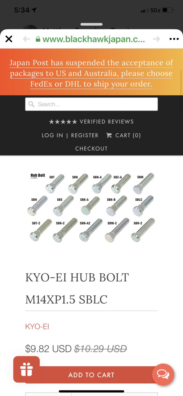

    2007 Tundra Blue Streaker
    Details and where can someone get longer studs?
  8. Dec 29, 2020 at 9:43 AM
    Mrf1987
    Sep 2, 2020
    #51663
    244
    expensive but they are the truest size replacement possible and you can still use your factory lugs on stock wheels if you ever change back out!
