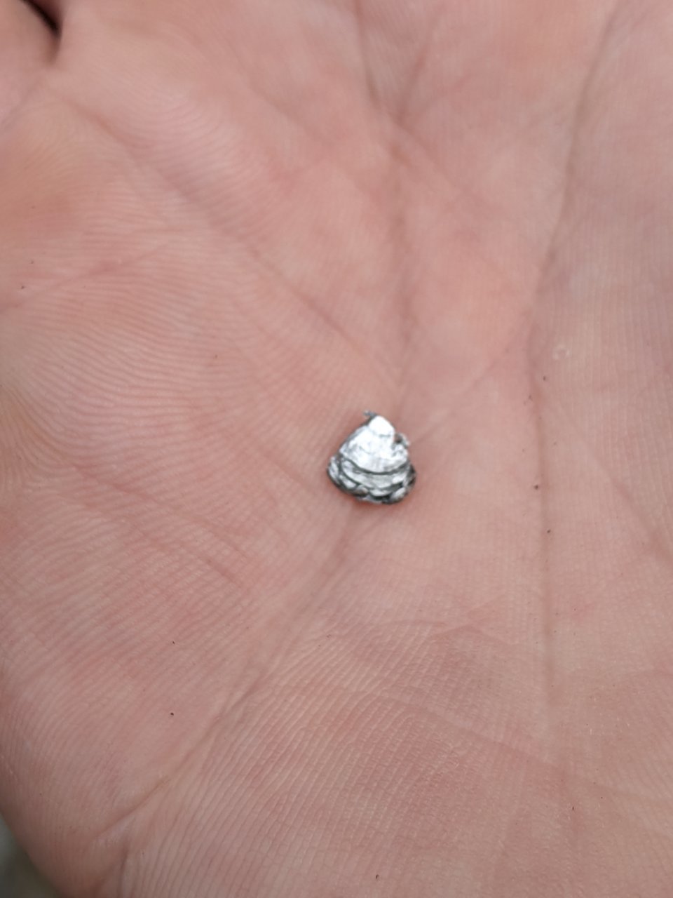

    A little will remain in the valve body, until you garage shift through PRNDL and activate lock up.
    Anyway, dropped my pan and cleaned it out. Had some aluminum metal shavings and a pretty big chunk. Also, some sludge from the strawberry milk shake that was solidified on the bottom.
    I thought may as well put this filter and fluid in that I already bought. And, I'm happy to say it shifts better than ever. No longer slamming into 2nd. There is still a little metallic ping shifting into 2nd, but it's smooth. Sounds like slop in the drivetrain. Whatever, I'm happy. I can drive it like this until it explodes.

    @mbreed2 how many quarts did it take to get it clean? These transmissions are tough. Maybe you'll be ok.

    I'm at 7 gallons so far. Milk shake is gone but it's still cloudy. Like @tvpierce has said, it will probably take 9.
    I did a drain and fill, then dropped the pan and cleaned it. Changed the filter and put the pan back on and filled it up. Since then I have flushed about 5 gallons through the cooler lines.
