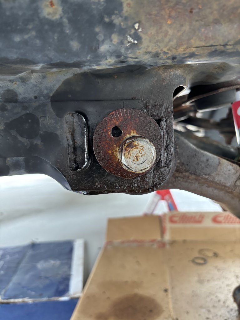

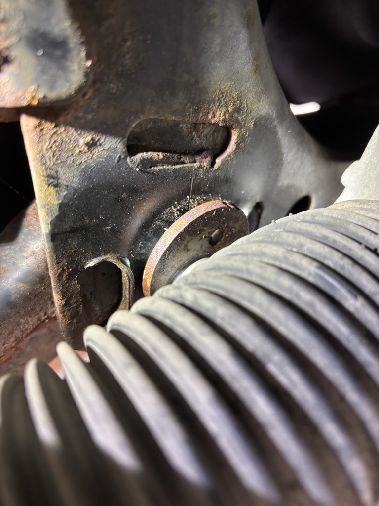

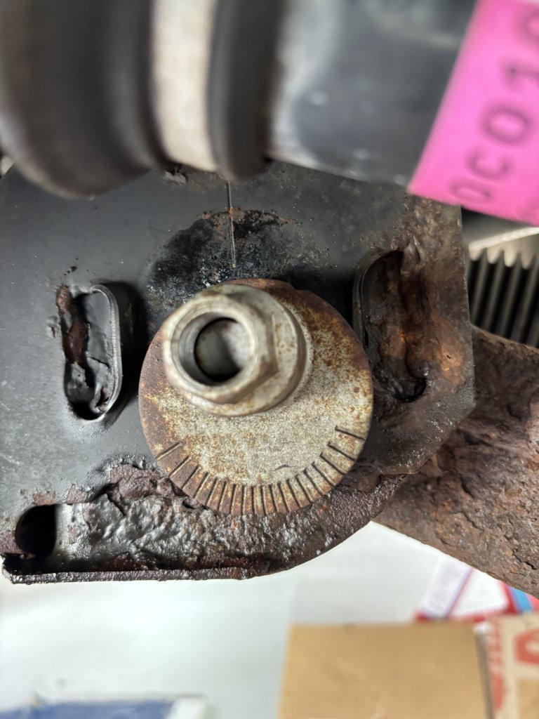

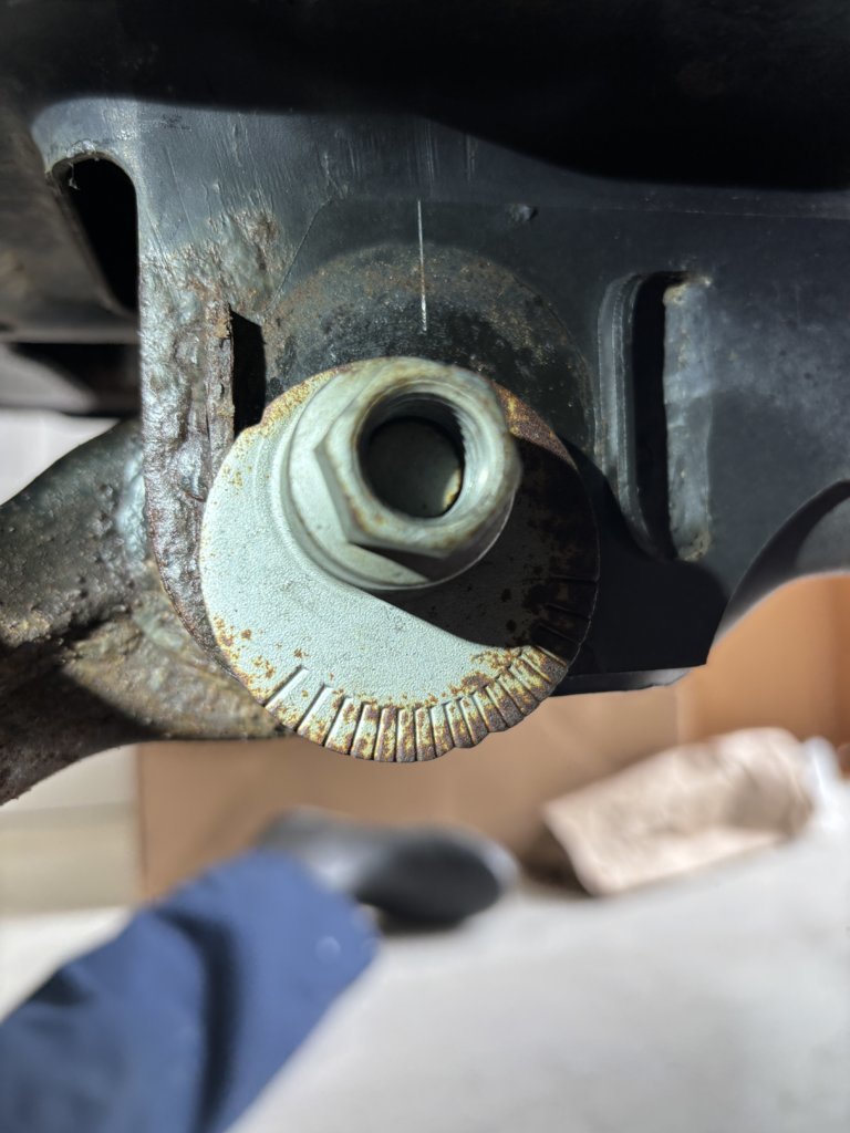

    Could someone with a 2.5” front lift provide me with some pictures of their LCA cam bolt settings?
    I completely loosened mine up during the install to facilitate putting the bottom shock bolt in and also to ensure they were not seized and could be easily adjusted during the alignment.
    However I have no clue how to line those cam bolts up to get me to the shop. I have a couple more days of work, going slow and steady. Still need to do the rear suspension, lbjs and brakes before I put it all back together.
    pics similar to these from someone with a 4x4 DC with about 2.5” lift would be greatly appreciated!IMG_5980.jpg IMG_5981.jpg IMG_5982.jpg IMG_5983.jpg

    I can see the outline of where they were in your pictures. Why not just put them back to there? Should be close enough to get you to an alignment shop. In the future you need to mark where they are with a paint marker before loosening.

    Flip the 2 eccentrics that are upside down. Once they’re in their nook, they’ll hold an alignment better.

    SOP after any modification of suspension requires an alignment. So really it doesn't matter what you do. Tighten them up willy nilly, or put them back where they were, you still need to get an alignment. Even if someone gave you pictures of a DC with an exact 2.5" lift you still need an alignment. I'm not even sure what the point of your question is now...

    Forward cams in the middle (12 o'clock).
    Rearward cams pointed full outwards (3 & 9).
    Tape measure toe to 1/8" to 1/4" total toe in.
