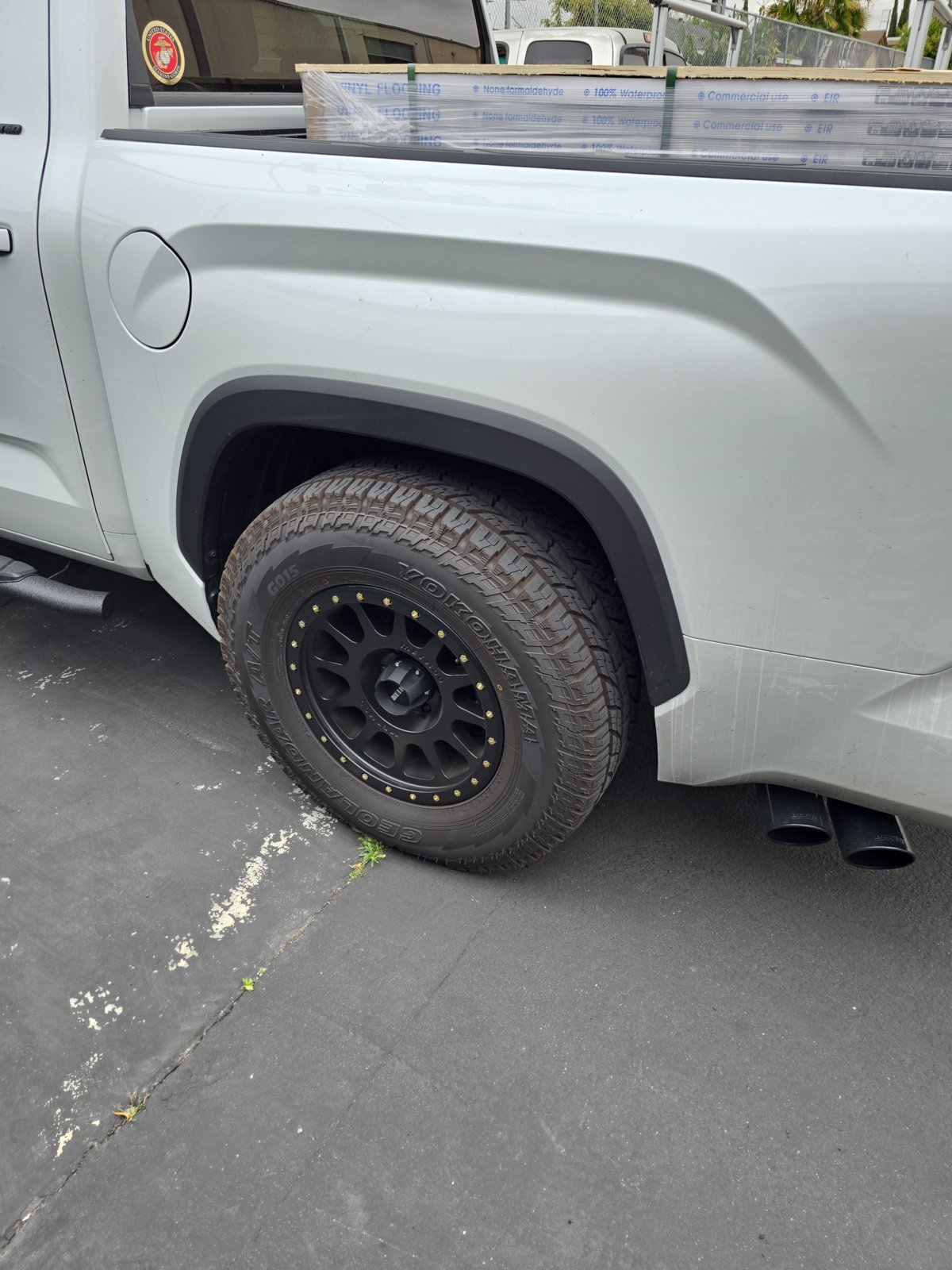

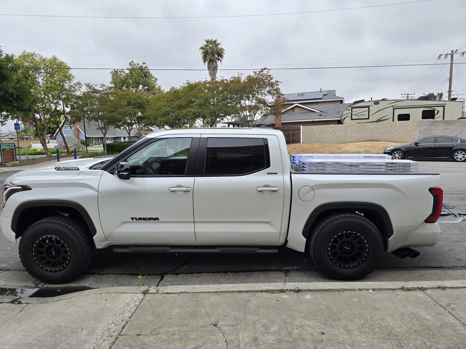

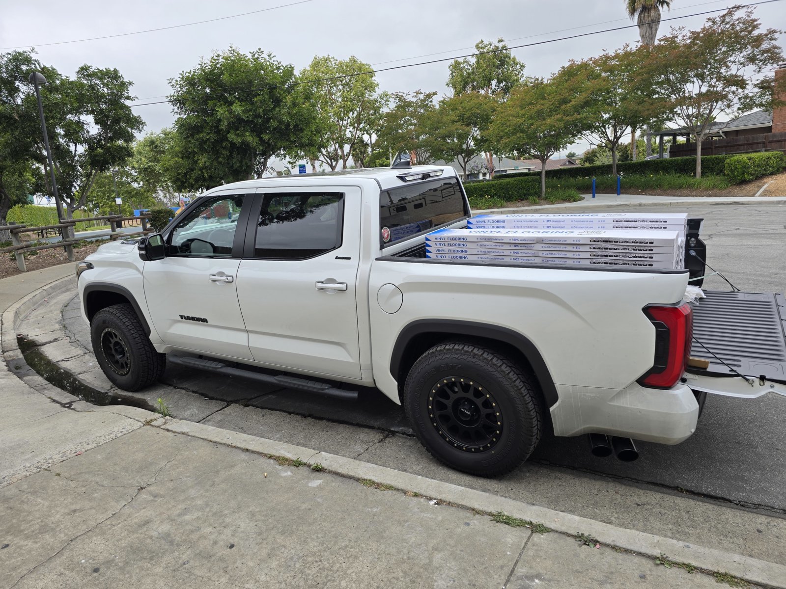

    2024 iforcemax tundra limited
    Ordered a borla atak delivery April 2!!
    3.5in lift kit

    How much weight is in the bed?

    Looking at you pic's yeah that sucks the corn hole and I'd be pissed too but what's the load rating for the lift,what type of lift is it (bags,springs shocks) and how many pounds is that flooring?

    its called carrying alot of weight, its not setting like its unloaded!

    Guy has 1400 lbs in the bed and complaining it’s squatting. Cmon. RC is stamped out in the same factory as Icon. Same shit different sticker.

    That's so much weight dude, my roadmaster setup would even squat

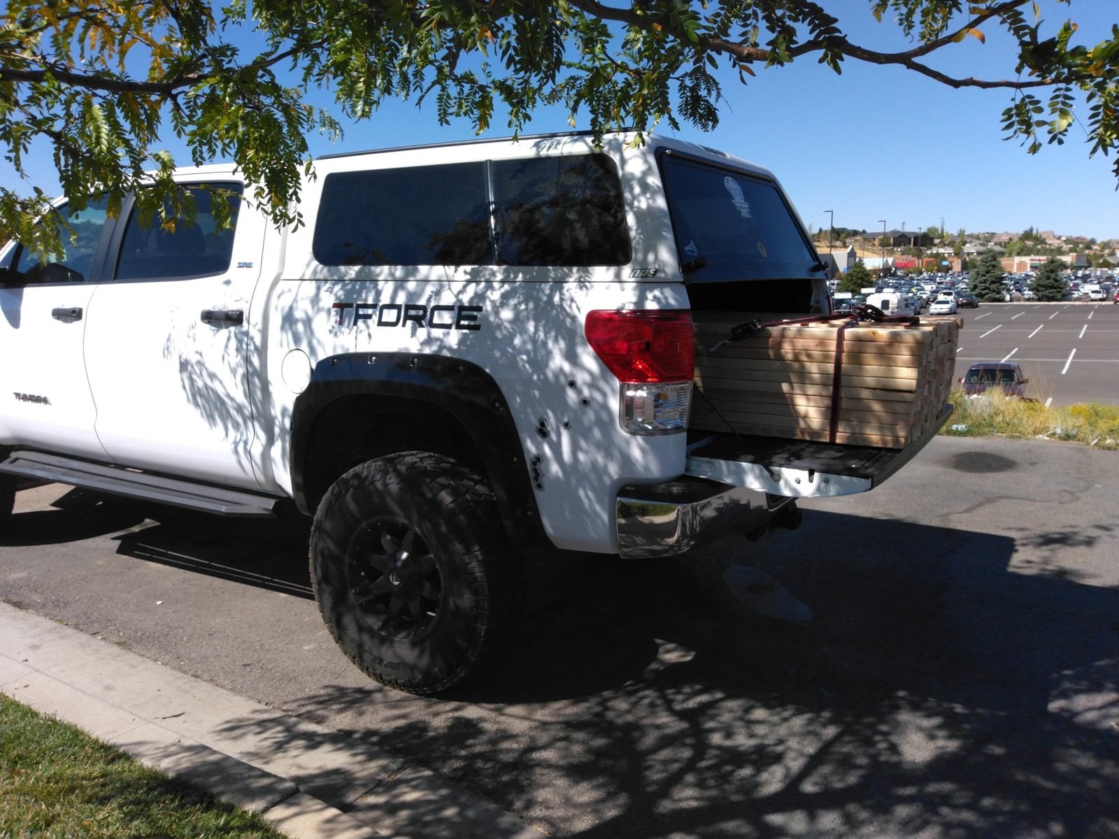

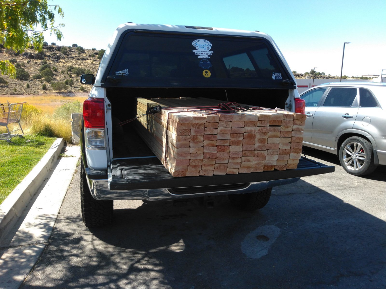

    should have bought a gen2
    air baaaggggzzz.....

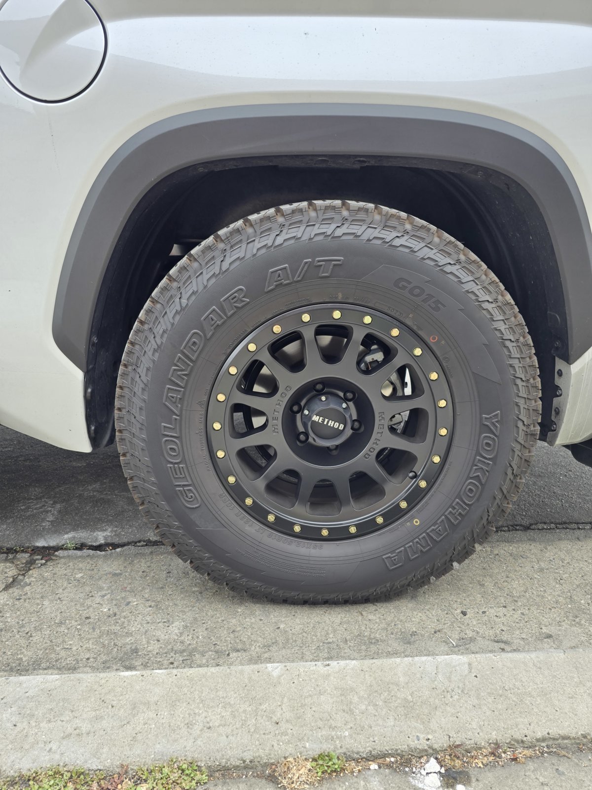

    On the bright side, those Geolandars are taking the weight like a champ!

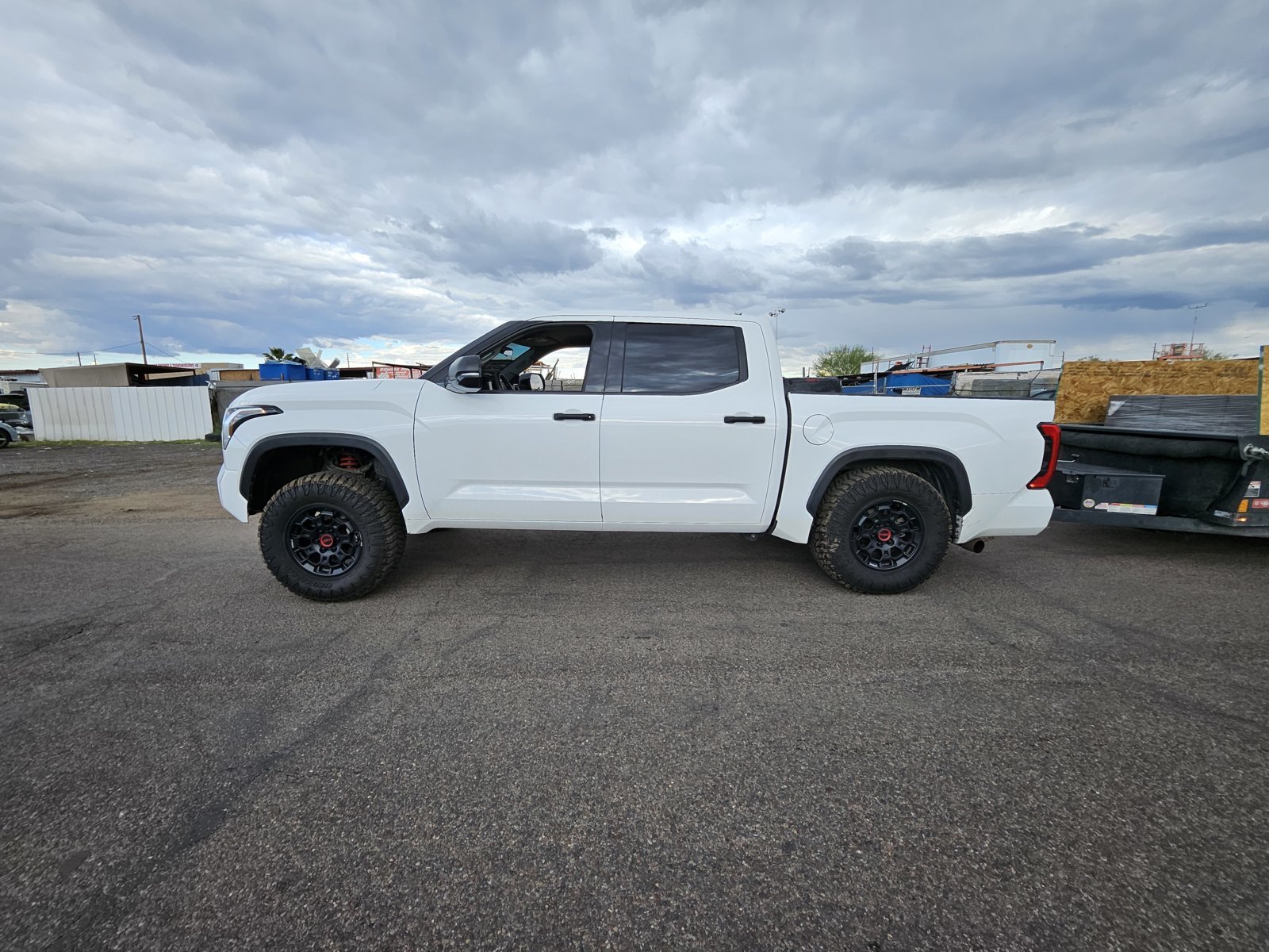

    2022 tundra sr5
    Trd pro bbs wheels Trd pro fox shocks Wescott level kit
    Nothing in the bed but 2 pallet of pavers in the dump tailer on trd pro fox shocks surprisingly I didn't hit the bump stops truck did great but won't be doing that again

    Looks like the trailer is a little front loaded as well

    I'm betting those rear coils that come with the RC kit are still stock load rated. Time to hit up Dobinson's.

    I’m not sure why the OP is so surprised about this result. This is exactly what lifted trucks look like when you put load on them without any load assist.

    Vinyl flooring is very heavy. I wouldn't be surprised if that was closer to 2000+ lbs in the bed. Last time I bought vinyl flooring I was about half that high in my bed and I was a good 1400 lbs (that was in the Chevy though). That was some pretty dense Vinyl though...
    @B.Ross Looks like you got about 100 ea 2x4x8' Kiln Dried DF or Pine studs in there so about 800-1200lbs depending on moisture content maybe could be 1200-1400 lbs if it was still green. We know we know...all the 3ed gen owners should have bought 2nd gens......
    @Battousai Share the brand of Vinyl flooring and how many boxes ya got in the bed, lets get an idea what kind of weight caused that amount of squat.

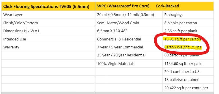

    Total 950sqft
    6.5mm with padding
    20mil wear layer

    Don't know the specific product but... here is one example I found with a quick google
    My calculator tells me that works out to 1,456.9 lbs. Squat looks about right for that.
