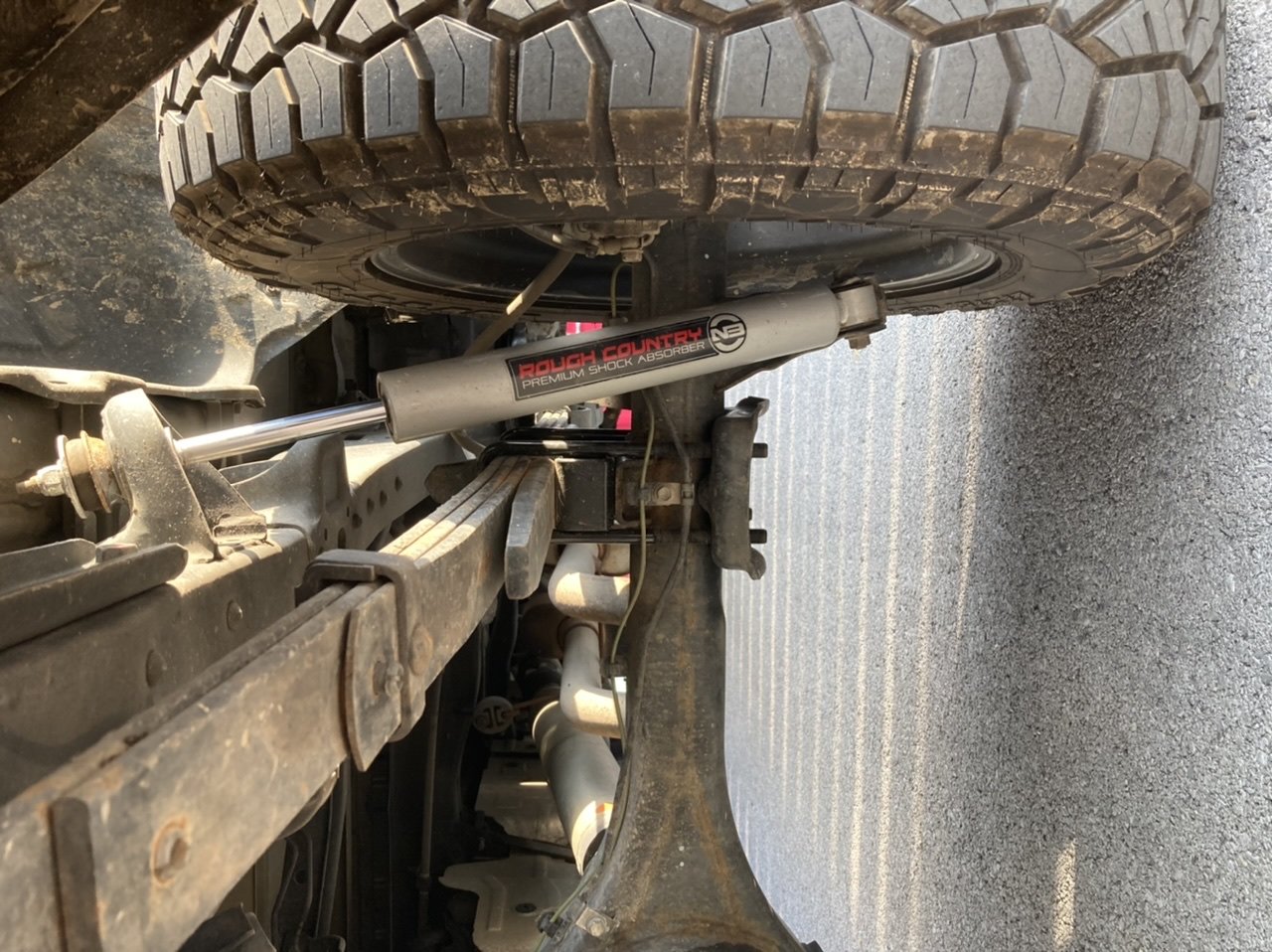

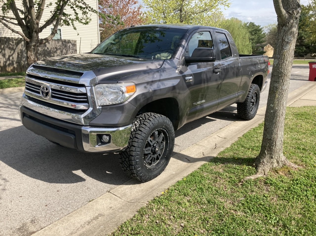

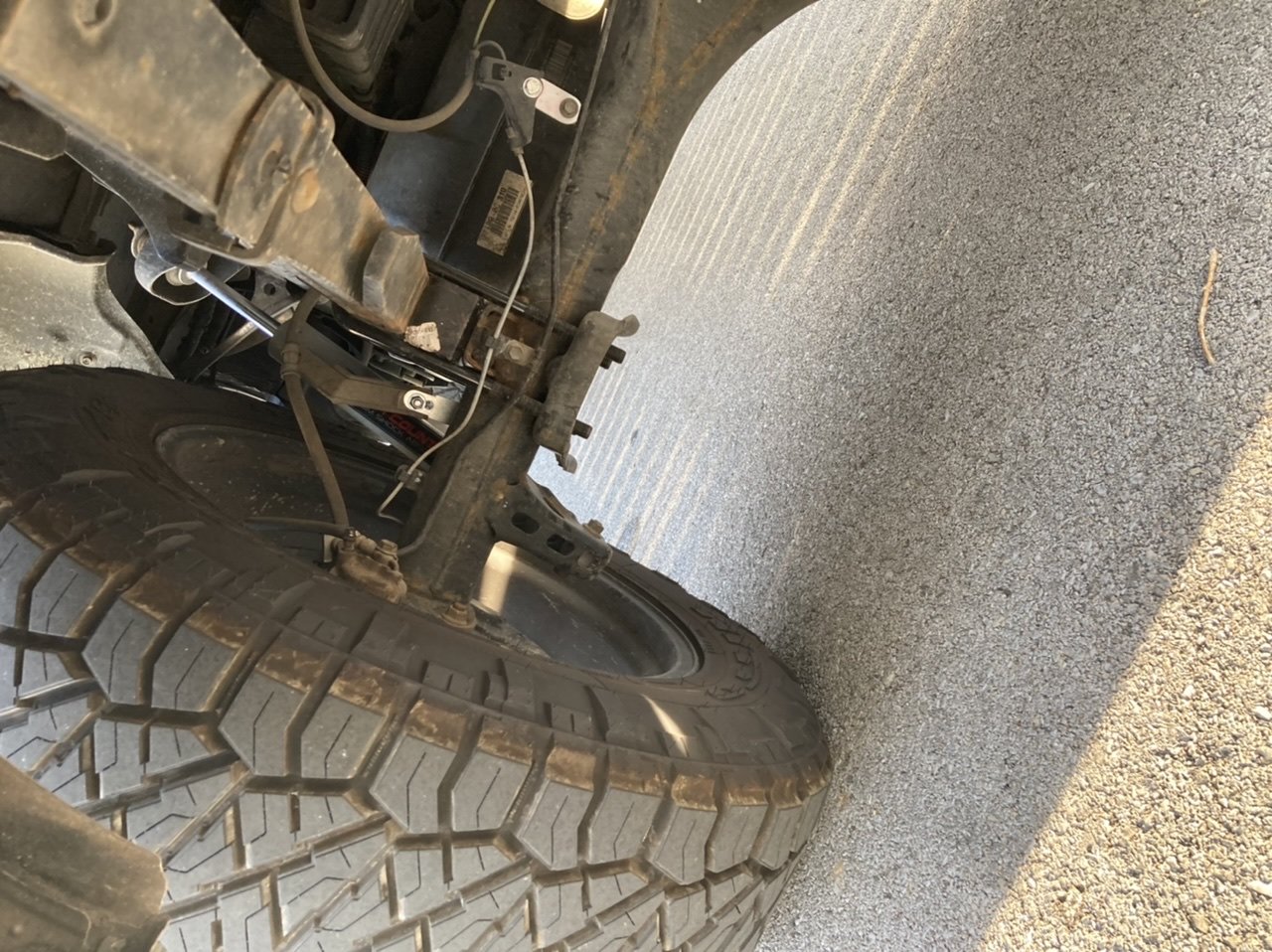

    I have that exact lift on my truck and I love it. I’ve heard all of the “Great Value” brand jokes, but my truck isn’t a desert runner or a rock crawler. I needed to get the truck high enough to get through logging and field roads while hunting in TN. It rides better than my wore out factory coil overs. The reviews on the rough country site are spot on as far as I’m concerned. I am also aware that OME makes quality stuff. Really comes down to personal preference. Hope this helps and good luck with your decision.

    I have put about 2500 miles on the lift so far. It leaves no rake in the truck, so that may be something to consider.

    I went with a 275/65r20 (34x11). I could have gone 35s but I wasn’t sure about rubbing since I was keeping the stock tss wheels. Any wider on those wheels and I’d probably need spacers to clear UCAs.

    Good to know, I have the stock 18" 4x4 wheels, with a 1.5" spacer, I'd like to do a 35x12.5 but I'll have to look into it some more because ideally I'd rather not rub

    But no issues with coming close to the frame?

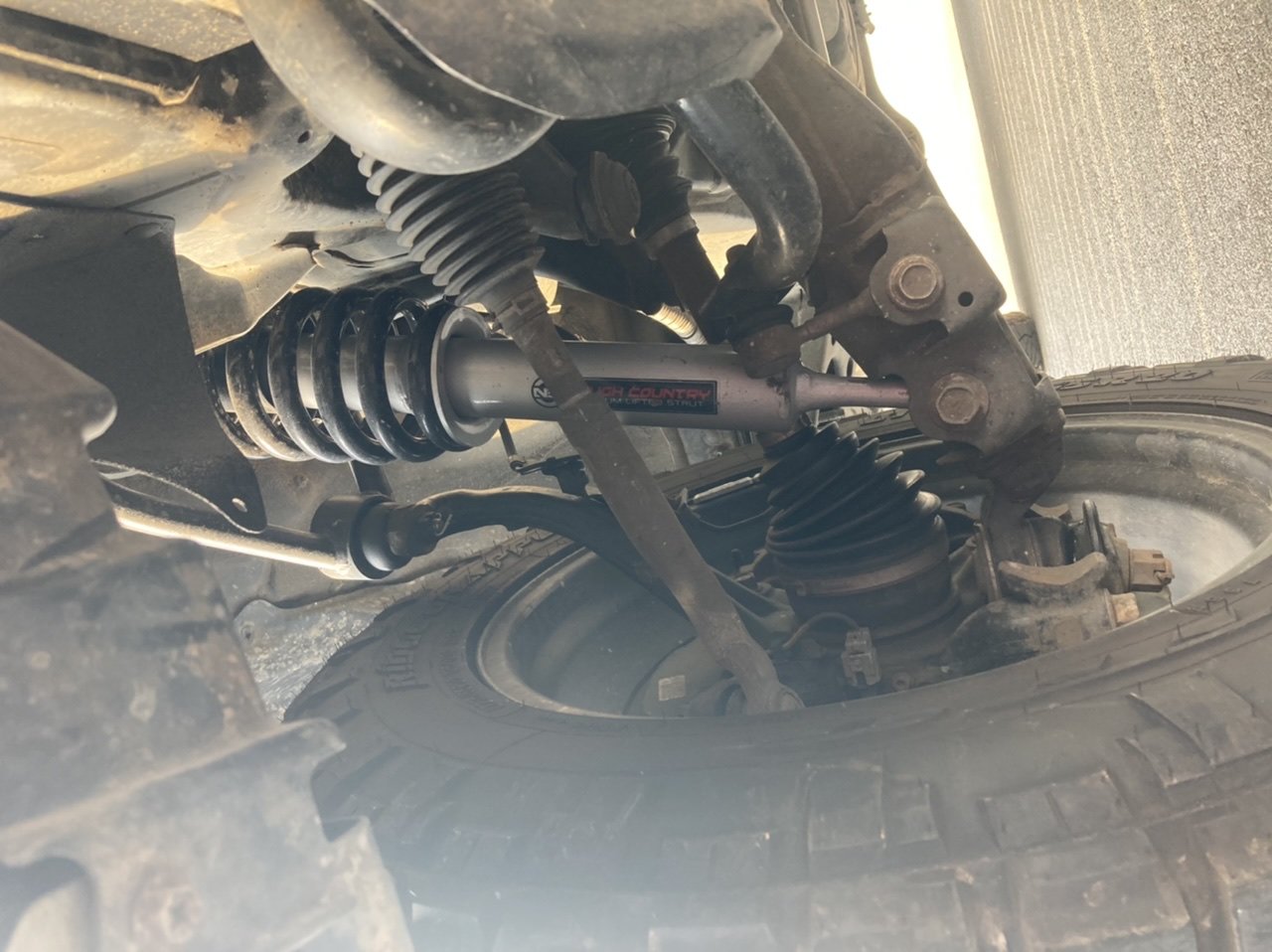

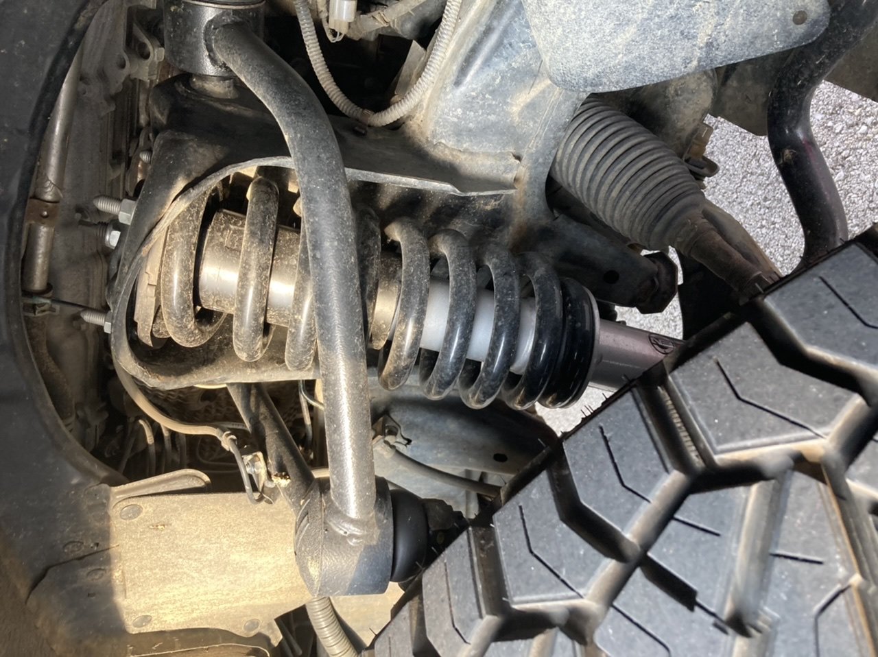

    I had this lift installed a month ago, the front full struts with the v2 rear shocks. Components seem good quality, greaseable UCA…so far happy with everything. Nice planted ride on the street vs oem and room for 35s.
    I know RC gets some serious online hate, I think it stems from 10ish years ago when their shocks were garbage.
