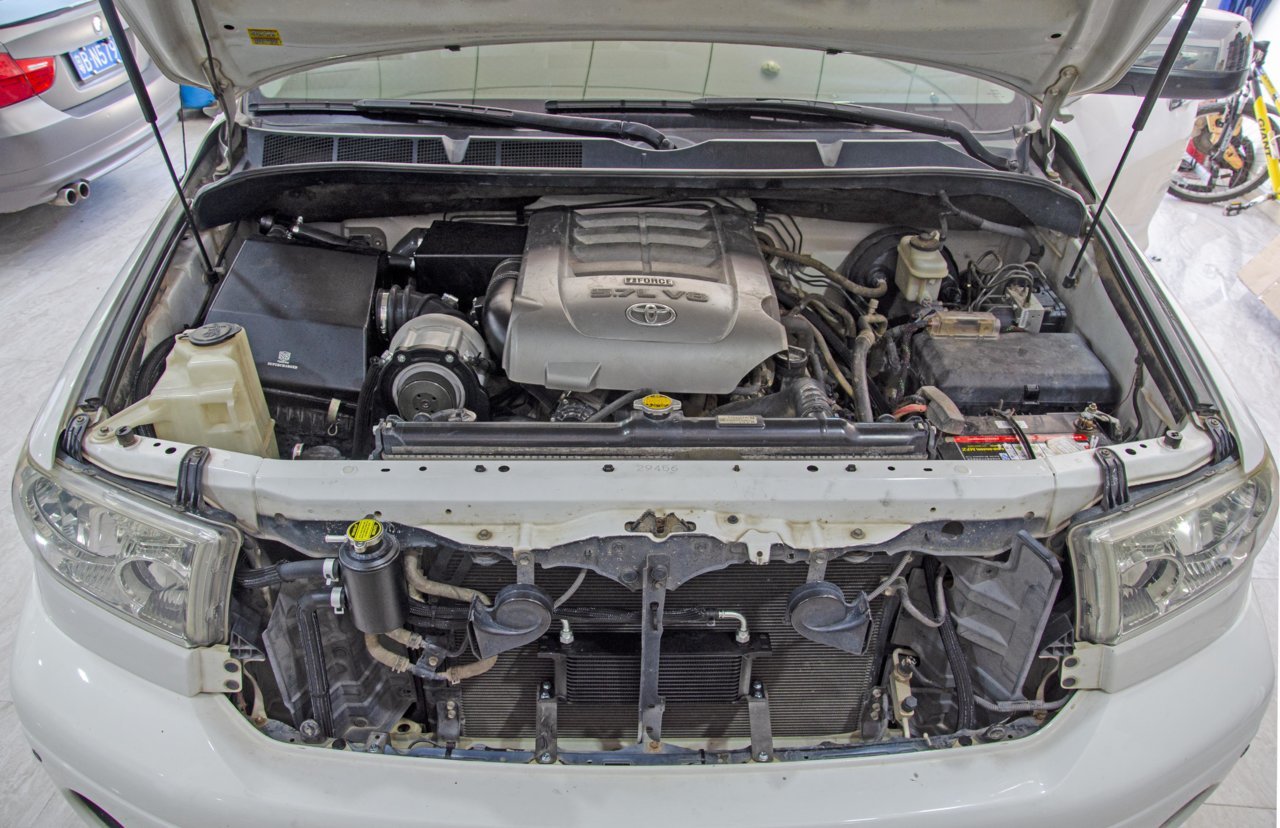

    I installed a Rotrex C38-81 centrifugal SC in my BRZ and love it. I started looking around to see if there was an application for the Tundra and I found a dealer in China. Yeah, yeah, I know... They've installed numerous C38-91 Rotrex SCs over there on the Tundra. They state 540hp with the Rotrex. Ive asked for a dynograph of HP/ torque curve if they have it. Anyway, they are putting a kit together for me to install here in the US. Pricing comes in about $500 - $1000 (including shipping and taxes) less than the Magnuson kit (w/o shipping and tax). I'll post more as I finalize the deal and will end up doing a write up of the install.

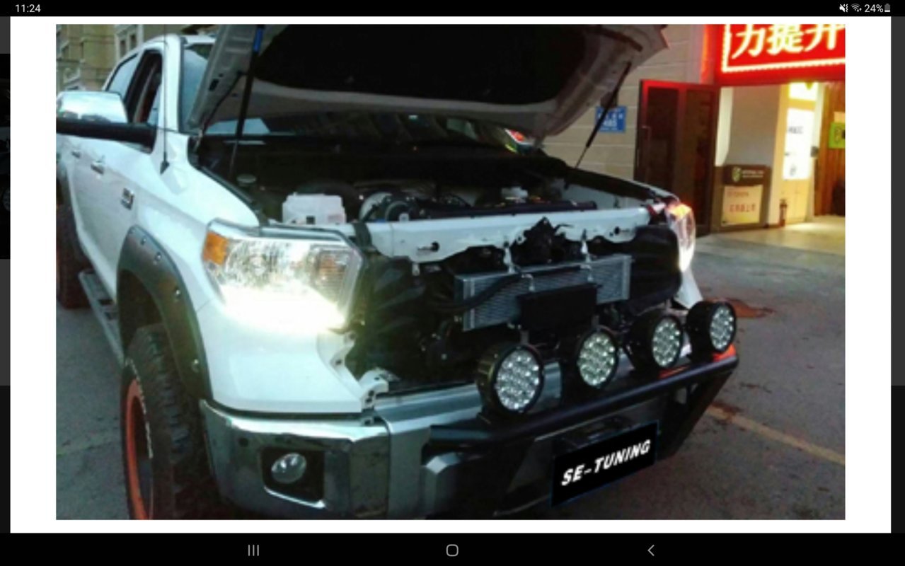

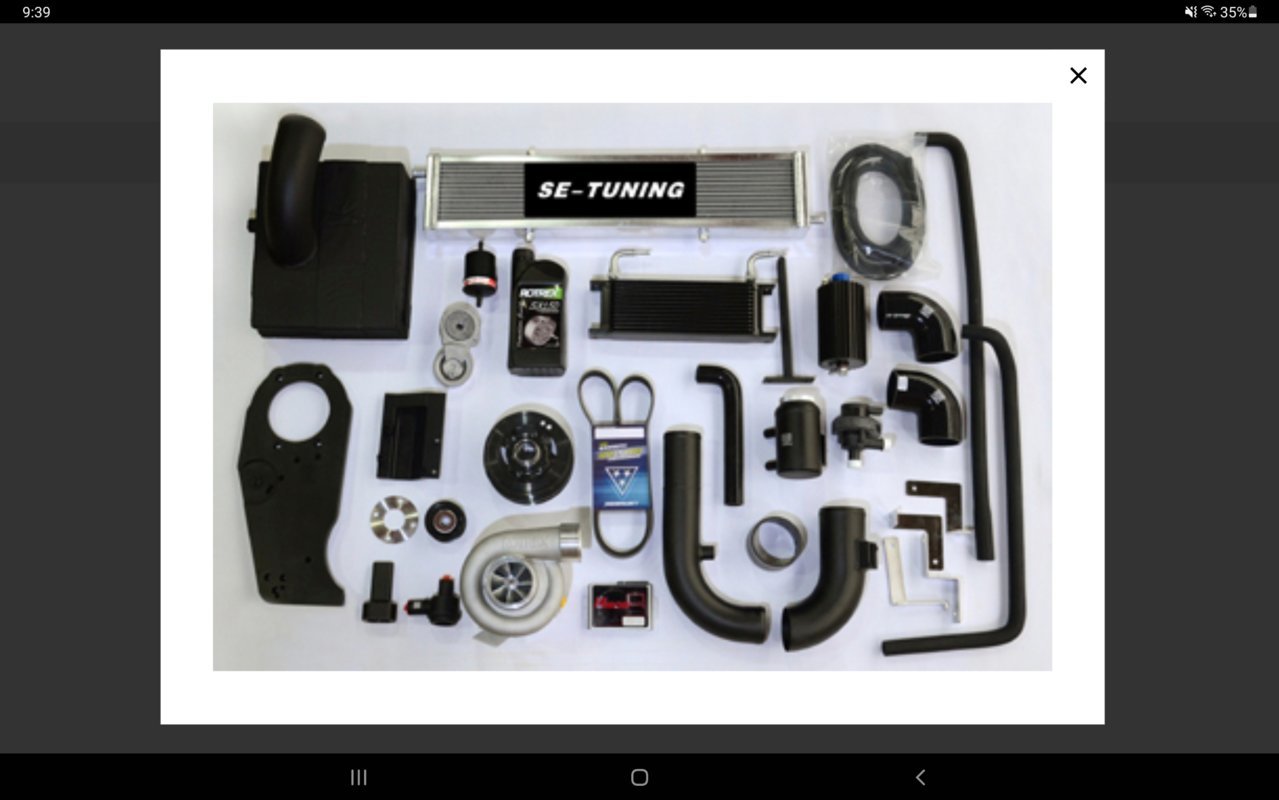

    A couple more images. Another thing I like about the Rotrex kit is the "smaller" packaging. I'm curious to see how much the kit weighs compared to the Maggie or Harrop. They did say there is no cutting required; only rerouting or repositioning of hoses/ pipes. The tune comes with the kit using Unichip. It should be plug and play as far as that goes. Getting excited!

    Looking closer at the kit looks like a belt is added with another pulley and auto-tensioner. May not have to take OEM belt off at all for emissions testing. It would be nice to be able to replace a belt only for the SC vice a whole serpentine belt.

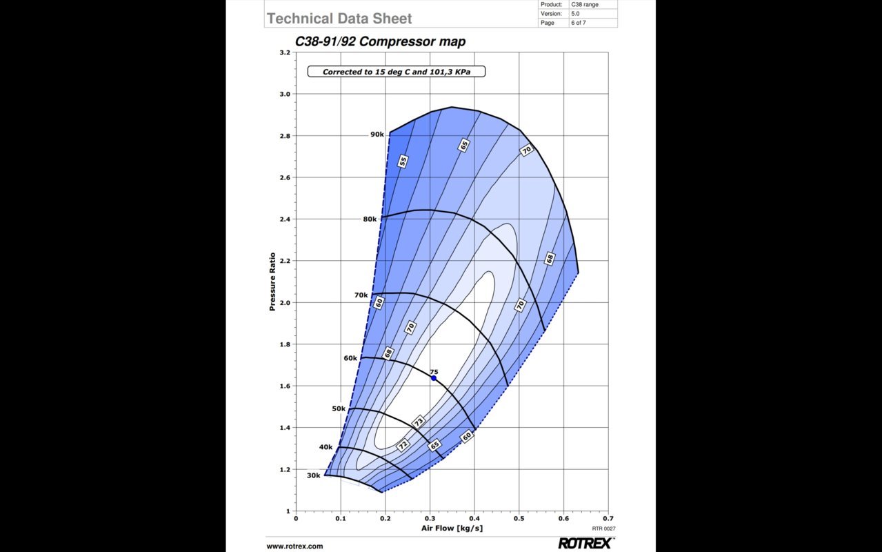

    The c38-91 is kind of small for a 5.7l. But I guess space is limited so that’s the biggest you can squeeze in there. Centrifugals are much more efficient, but you’re not going to get that gut wrenching torque in the low to mid power band, which is where these motors are designed to make power at.
