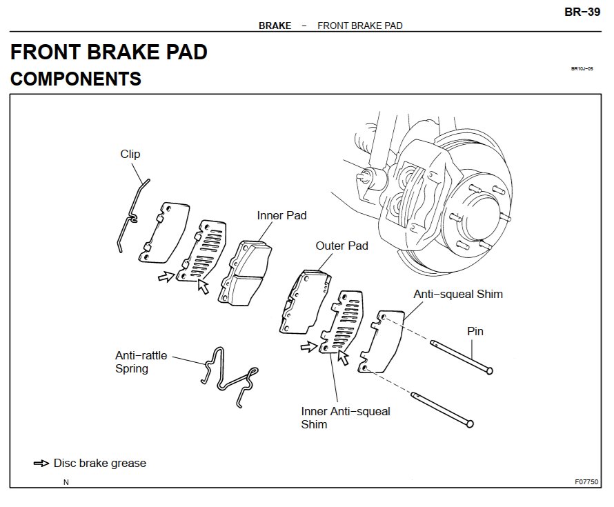

    As far as grease, Toyota only specifies the use of disc brake grease on both sides of the inner shim. Very light coating. The Permatex or CRC disc brake grease would be fine. I have also used the red CRC disc brake quiet for the inner shim (although it may not have been correct). Do not apply to the pad or outer shim. Slide pins are to be smooth, clean and dry, no lubrication.

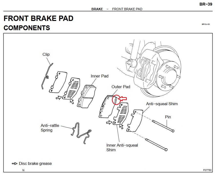

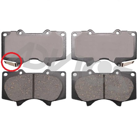

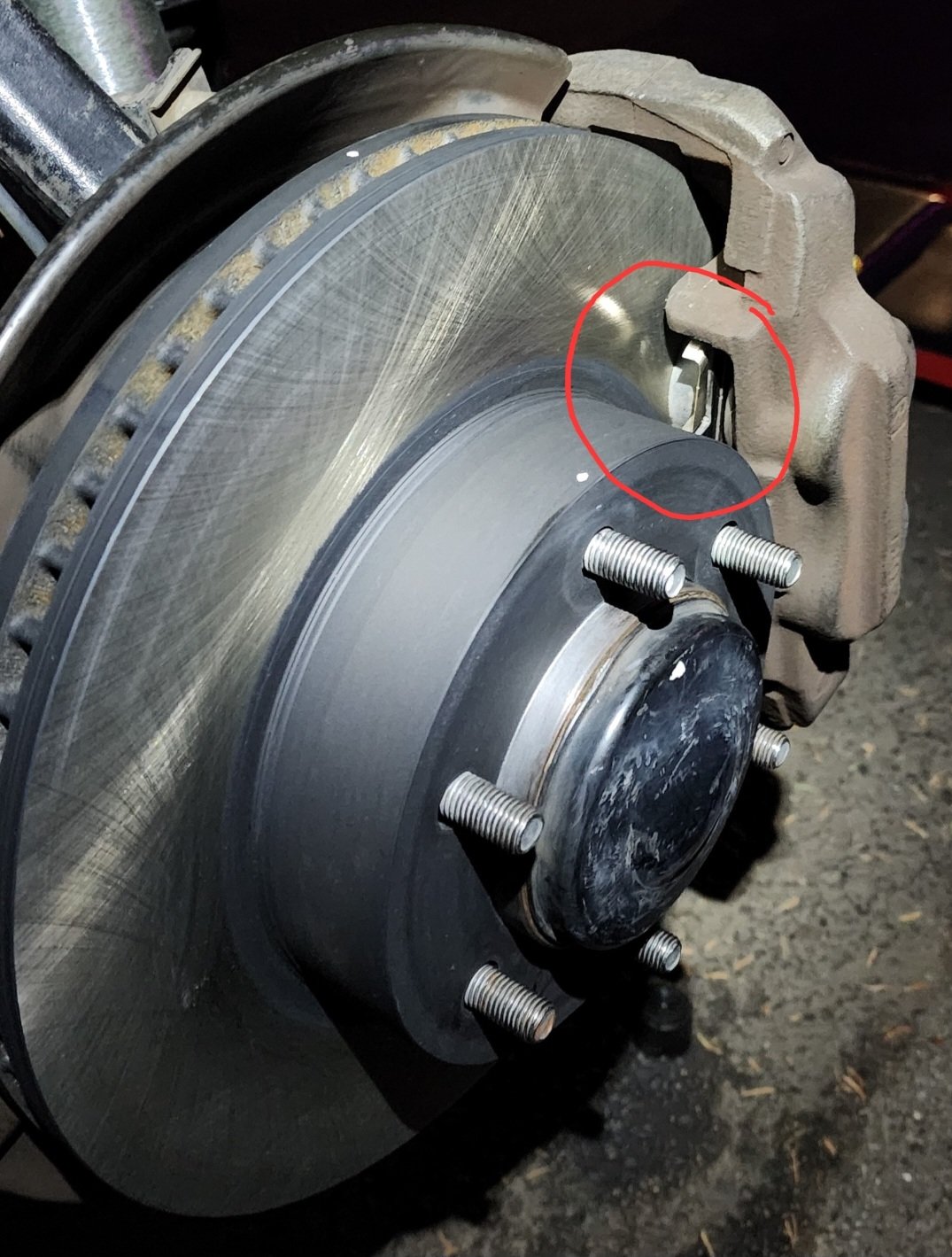

    EDIT: And when I say "screamers", this is the tab I'm talking about. This pad needs to be installed on the lugnut side of the truck, with the tab facing up. Note the pads otherwise look identical (these are the actual pads Advics will send you in the box, if you flip the top two over, they look identical to the bottom two except that metal squealer tab)

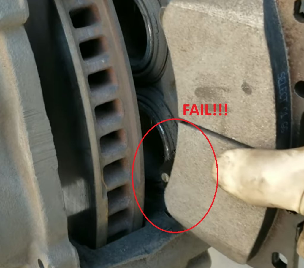

    And just to really drill home how to do it, here's a video. It has flaws... but you see the process overall, fundamentally...
    Some points:
    • One, don't get any grease on the pad surface like this guy did, see above his finger on screencap below
    • Two, that long clip he pulls from the side, holding the slid pins in, you may have two individual clips, one on each slide, totally normal
    • Three, the original anti-rattle clip being on the bottom is not correct, it should be on top, and you don't need to use two clips, although some people do, it makes no difference in my experience.
    • Fourth, the kit will come with a packet of grease to use on the back of the pads, the guy in this video goes overboard
    • Fifth, he installs the pads wrong!! ... I see the screamer at the bottom of the inboard pad at the 3m33s mark of the video
    • Last, I find a part of adjustable pliers (channel locks) to help gently persuade the pistons in, but his method of using the old pads works too... it also matches the FSM above I think

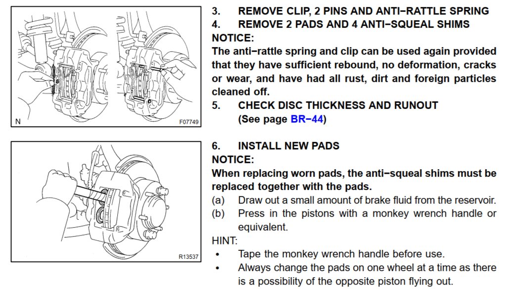

    Pad replacement, as mentioned above, is fairly uncomplicated. The fronts are especially straightforward due to the caliper design. Since you want to replace the rotors, it does add a bit to the job. It's not too bad, but you need to prepare for it. Probably will need a long breaker bar or long 1/2" drive flex ratchet to break the caliper mounting bolts loose. Also need something (bailing wire, rope, cord, etc), to hold the caliper up so that it doesn't stress the brake lines.
    The videos and write up work for your front brake pads. The rears will be a little different, as they are single piston sliding calipers.
    If you plan to DIY, pick up a Haynes manual as it does a pretty good job. The factory service manual for Tundras is out there too, but I'm not certain about for a Sequoia.

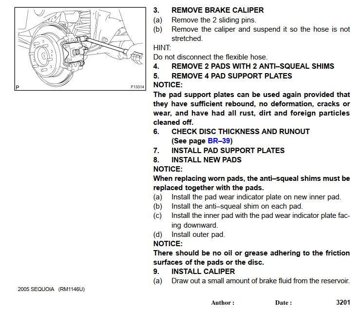

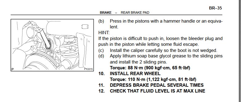

    That means you will be reusing the shims from your existing rear brake pads. Make sure you don't bend them, and clean them well with brake parts cleaner. You can use the brake grease previously mentioned, or something like the CRC red disc brake quiet. Just a very light coating on both sides of the inner shim (if two shims) or on the back side of the shim that faces the pad (if one shim).

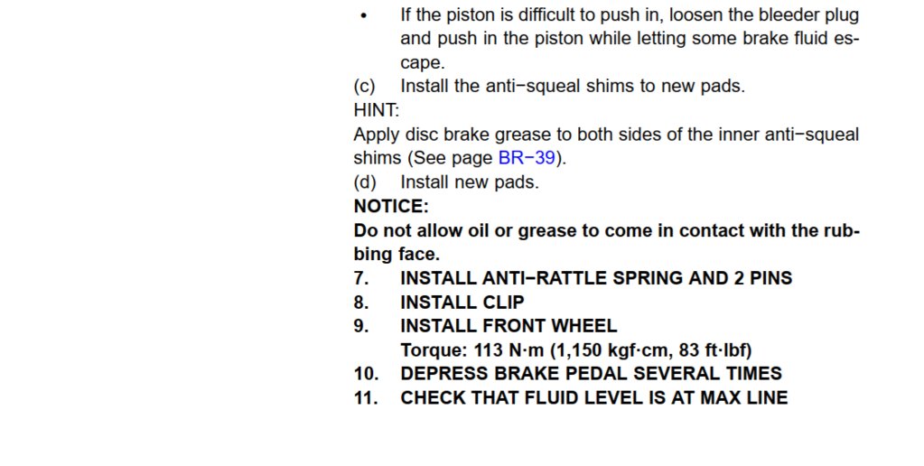

    I'm quoting from the Toyota procedure for the front brakes. Toyota does not specify the use of grease on the front slide pins, only both sides of the inside shim. I realize you are working on the rear brakes first, but my advice is the same.
    I have found that brake grease gums things up and causes more harm than good, esp when over-applied. Many car makers want the parts clean and grease free. If you lived in another part of the country, say the northeast, then you might need it.

    If you're reusing shims just follow the attached FSM pages pasted above. This really is a very simple job.

    I found Sequoia FSM. Its for a 2005.
    https://www.dropbox.com/s/hh086fxxx3xz0o8/2005_Sequoia_Repair_Manual.pdf?dl=0

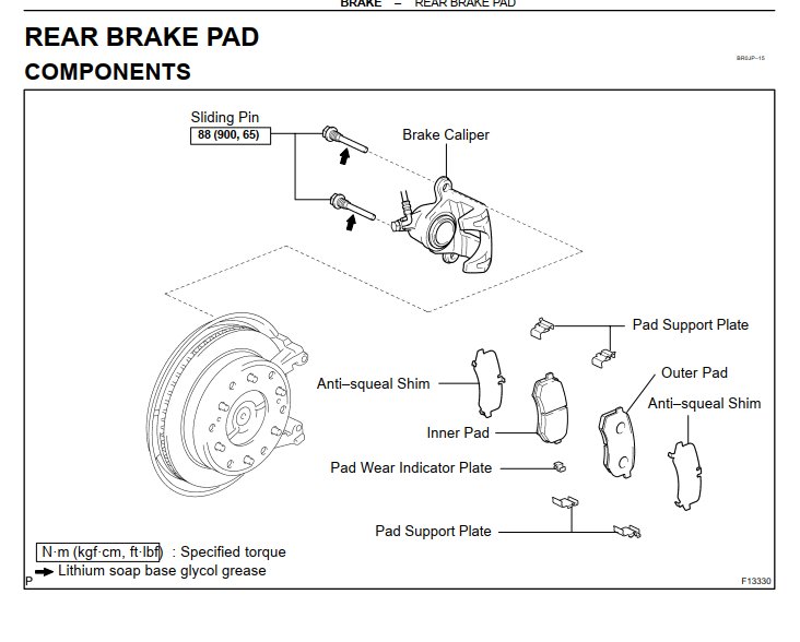

    Since the rear calipers are a different design from the front, Toyota does state to use "lithium soap base glycol grease" on the slide pins. I believe they are covered and not exposed to the elements. Just keep it light.
    No grease or adhesive is specified for the shims.
    Also notes to "Install the inner pad with the pad wear indicator plate facing downward."

    The front slide pins are exposed. If you coat them in grease, even just a fine film, dirt and brake dust will stick to the pin. Does not make for a good sliding surface.
    The rear slide pins are not exposed.

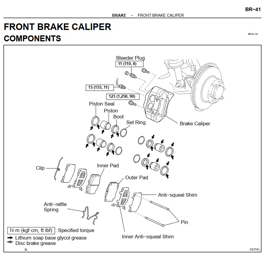

    Weird. They definitely identify where to use grease in the '06 FSM and it's not on the slides. And beyond that discrepancy, which is bizarre considering it's the exact same damn calipers...
    And I see what you wrote or they wrote about the squealer position, but '06 FSM doesn't say which direction (page is above). However, I swear Advic's (they made the OEM pads/rotors) doc they ship with the OEM upgrade kit shows installing with the screamer at at leading edge (i.e. facing up). I'll hafta go grab it and check. I thought it was weird to have on the leading edge, because it should scream louder on the trailing edge.

    My posts today were regarding the rear disc brakes on his Sequoia. The rear calipers are the standard single piston calipers, not the big four piston calipers like on front. The designs are different.
    The front brakes on the Tundra and Sequoia are the same.

    Ah shit. I totally missed that. And I also missed something else.
    For the front caliper, the squealer is definitely shown in the FSM as being outboard, and facing up, I just didn't see it in the image before. It's here in red.
