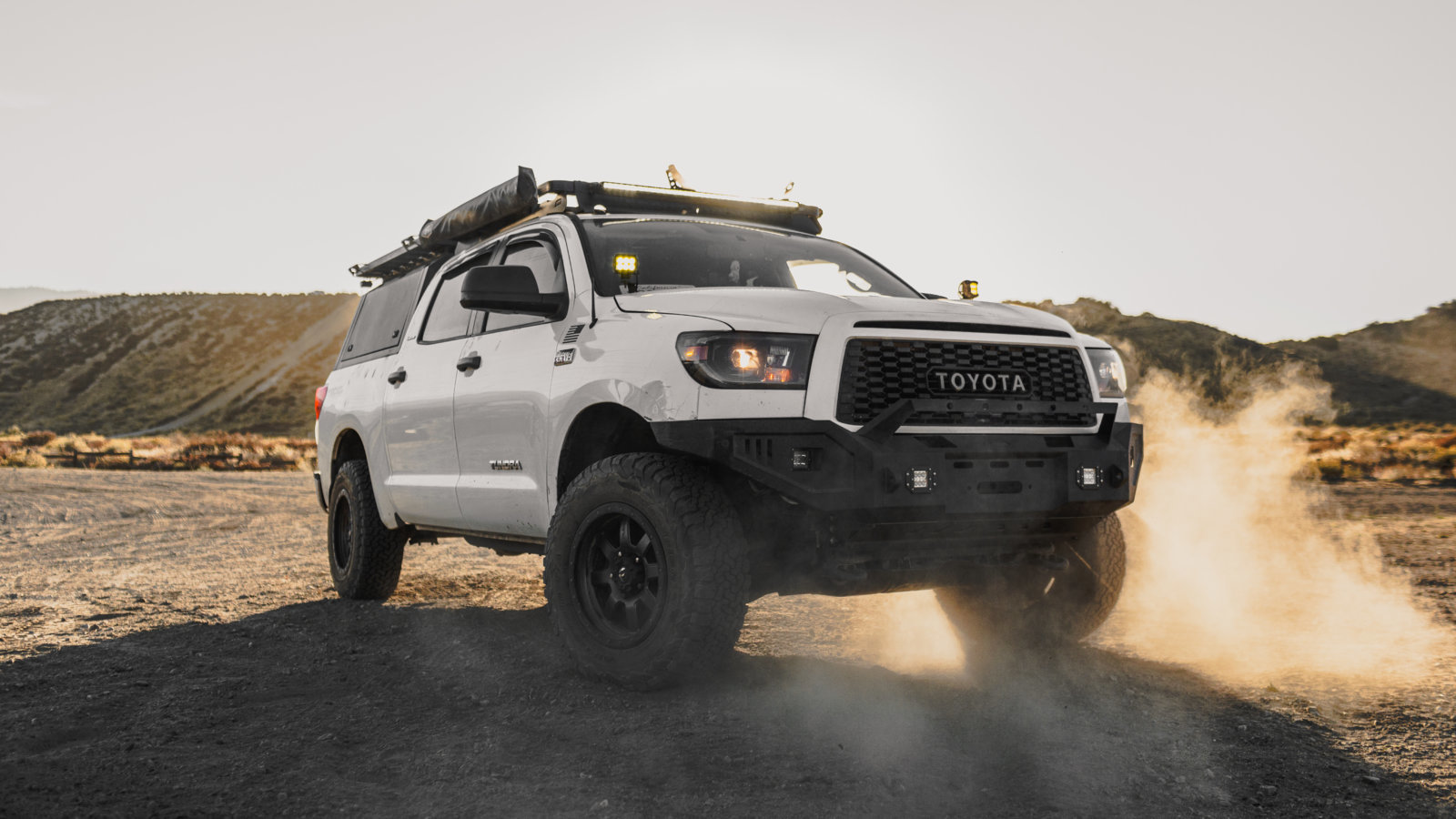

    I've got dual Front Runner Slimline II's on my 2013 Crewmax. I guess it would depend on your use for the platforms. We have tons of accessories for our Slimline II platform. If you are wanting to use the rack for general use, Yakima and Rhino Rack are great. If you are looking for an off-road purpose-built platform, I recommend the Slimline II. Anything you want to mount to it, we probably made a mount. It's very modular and strong as well. Yes you do have to drill into the roof to install the Cab Rack since Toyota didn't give Tundras factory mounting points, but since you are already having the tracks installed on your shell, our components for that are just bolt-on. You can either go with a load bar set up or a full tray set up like the one on mine. The cab and canopy trays wouldn't sit level, but it would be very close!
