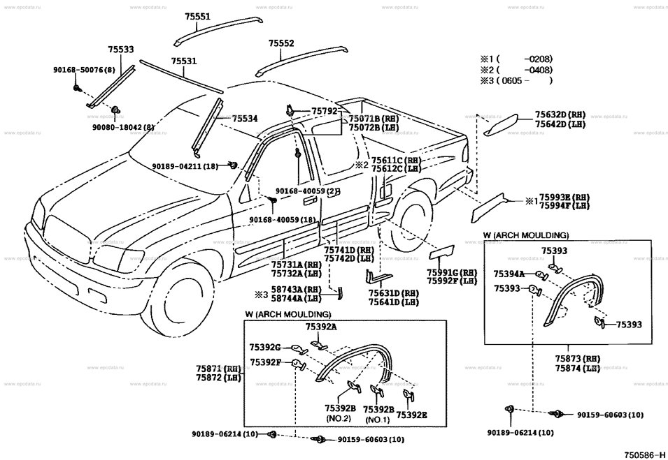

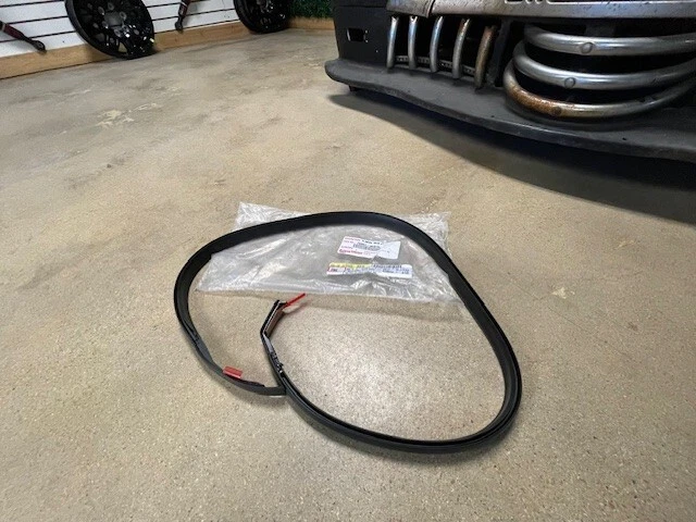

    Has anyone replaced their roof moulding? Mine are starting to come up on the ends and I'm hoping it's a easy DIY. Toyota website says each side runs about $100.
    Do you just strip them off and use an adhesive to attach to the roof?? Any issues with getting them into the sealer around the window?
