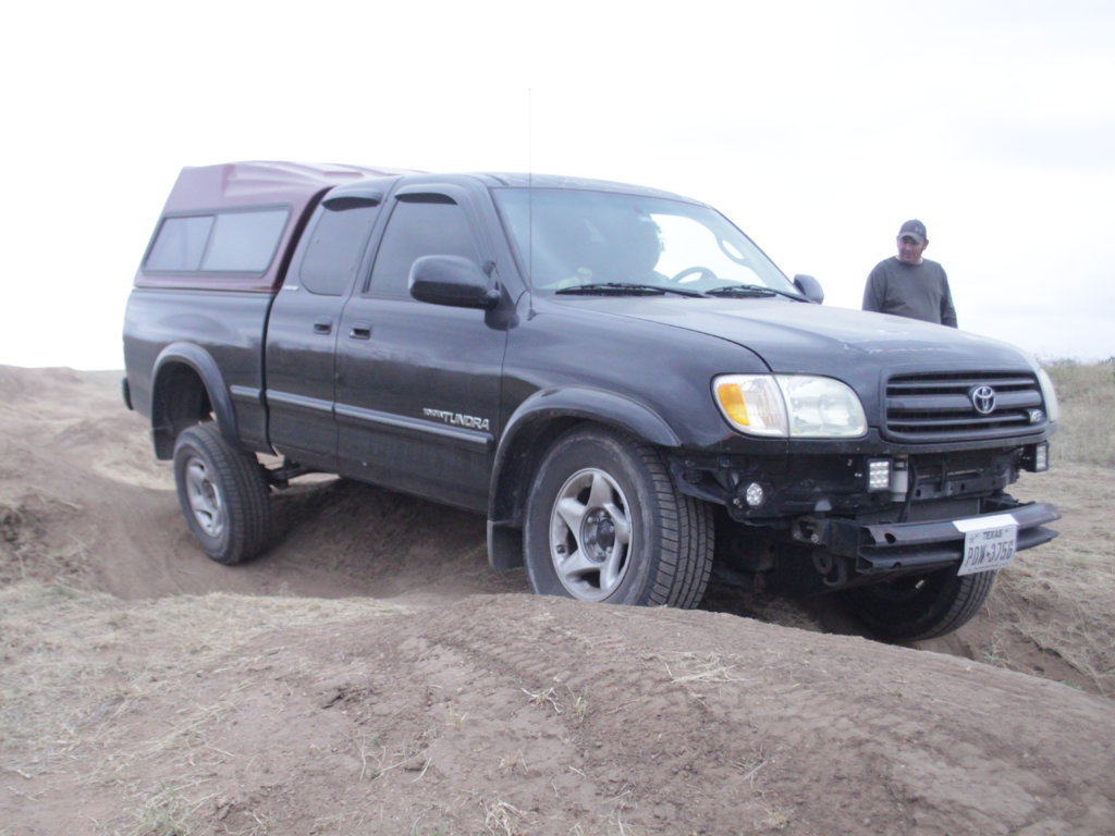

    Anyone use a roadactive setup offroad?
    still articulate? Stiffer over speedbumps?
    i know, wrong section, i've just never used em, and i think i know how it works, but im not sure.

    I haven't been 'crawling' since I've had mine on, but when when the terrain warrants, you can still see the rear wheel start to twist and tuck (articulation) as it did w/o the set up. I'm just not sure if it requires a bit more force to start that process, but on uneven ground in my driveway and on FSRs it wouldn't seem that way :thumbsup: I'm only on the 'lighter' setting currently w/about 400lbs in the bed and about 1/2" lift over OE height on my '21 Pro (no rear sway bar)...
