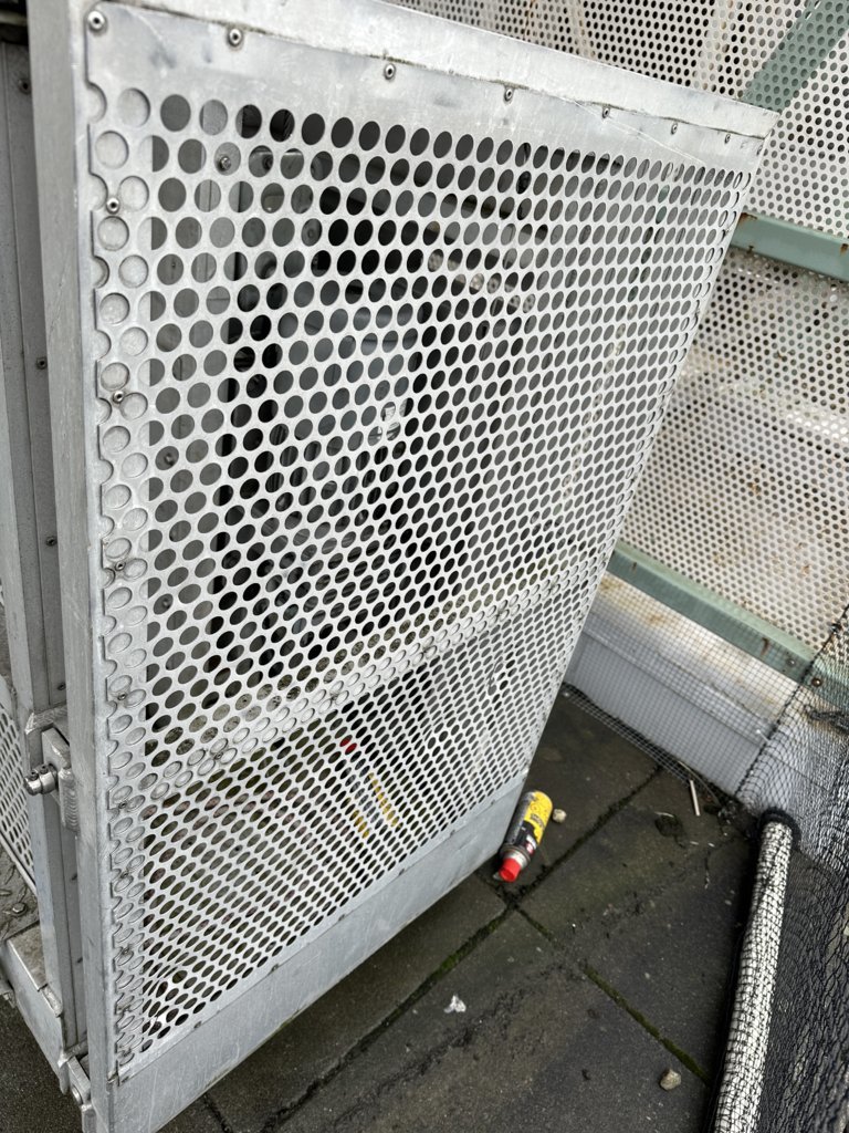

  19. Nov 7, 2024 at 10:36 AM
    G3ardnut
    G3ardnut Brushed Chrome is COOL
    Apr 29, 2023
    #96222
    690
    Joe
    Canada
    2023 Limited TRD Offroad Crewmax Celestial Silver Metallic
    Yup, I did this to mine.

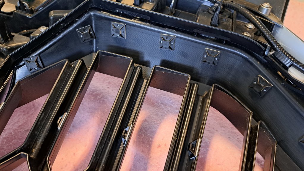

  22. Nov 7, 2024 at 10:54 AM
    G3ardnut
    Apr 29, 2023
    #96222
    690
    Joe
    Canada
    Secured it to the back of the grille with zip tie mounts so there are no exposed zip ties. If they break or come loose just redo.
