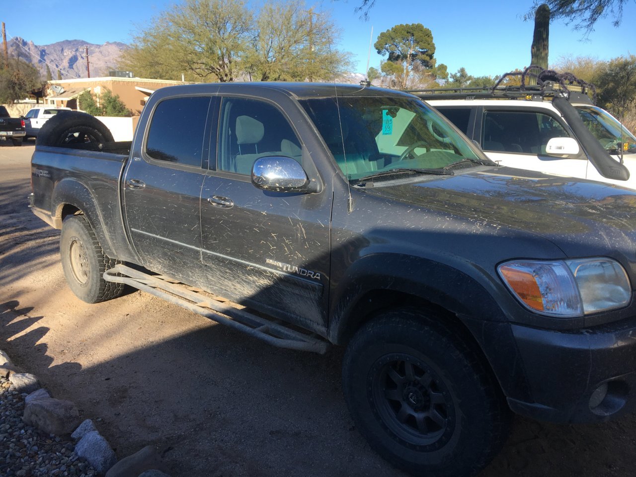

    FrenchToasty
    Sep 15, 2019
    #36156
    18,385
    Mo
    The SoAz….. big surprise
    Bone stock
    They are pretty nice.......

  10. Feb 2, 2021 at 8:13 AM
    FrenchToasty
    Sep 15, 2019
    #36156
    18,385
    Mo
    Bone stock
    Last we talked, I don’t know if he plans on making any/many more. It’s a lot of work and tig welding isn’t cheap. His design is wicked smaht how it mounts to/into the frame rails

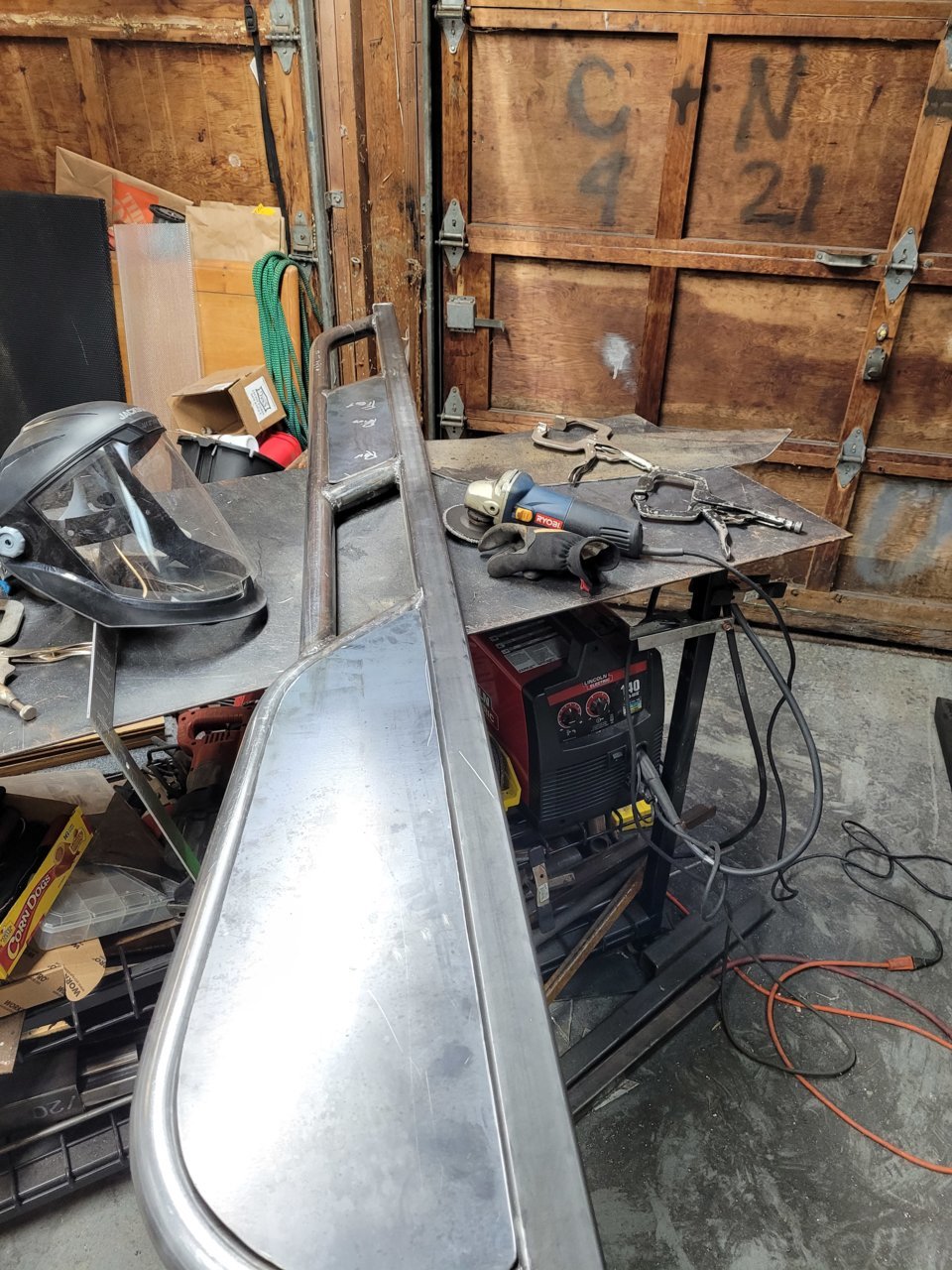

  20. Feb 2, 2021 at 9:54 PM
    Siebler
    Siebler Taco Tow Vehicle
    Apr 27, 2020
    #45601
    279
    CJ
    Eastern Oregon
    01 AC 4x4,07 Sequoia 4x4, 99 Tacoma Long Travel
    Monstaliner, Kings and Camburg UCA, projector retros, DD injectors, homebuilt bumper/ sliders
    Started plating these ones tonight. 2"x2" 1/8" inner and and 1.75" .120 wall on all the round. I think with these trucks being fairly large 1.75" is minimum and 2" would look better but I dont have that die.
    My taco is a mix of 1.75" and 1.5" so the step up to 1.5" and 2" i think works.
