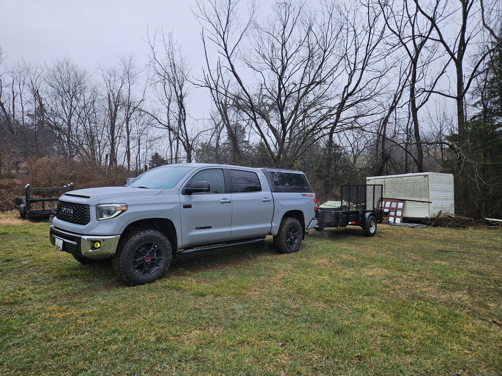

    As lame as that is, those are my top two use-cases, followed by actually having time to go hit some trails. Last time I was out near Flagpole Knob, I turned back because I thought I'd get my OE tubular steps hung up on rocks.
    In everyday life, I'd love something that would:
    + make life easier for my wife when she's loading our 1-yo and 2-yo into their car seats
    (Read as kick-out at rear, tread plates)
    + keep people's effing doors off my truck!
    (Reasonably wide up front, too?)
    I've always had an eye for the RCI sliders and love that they are bolt-on, but not sure how they do protecting from door dings??
    Sincerely,
    Official Dad-Wagon Driver

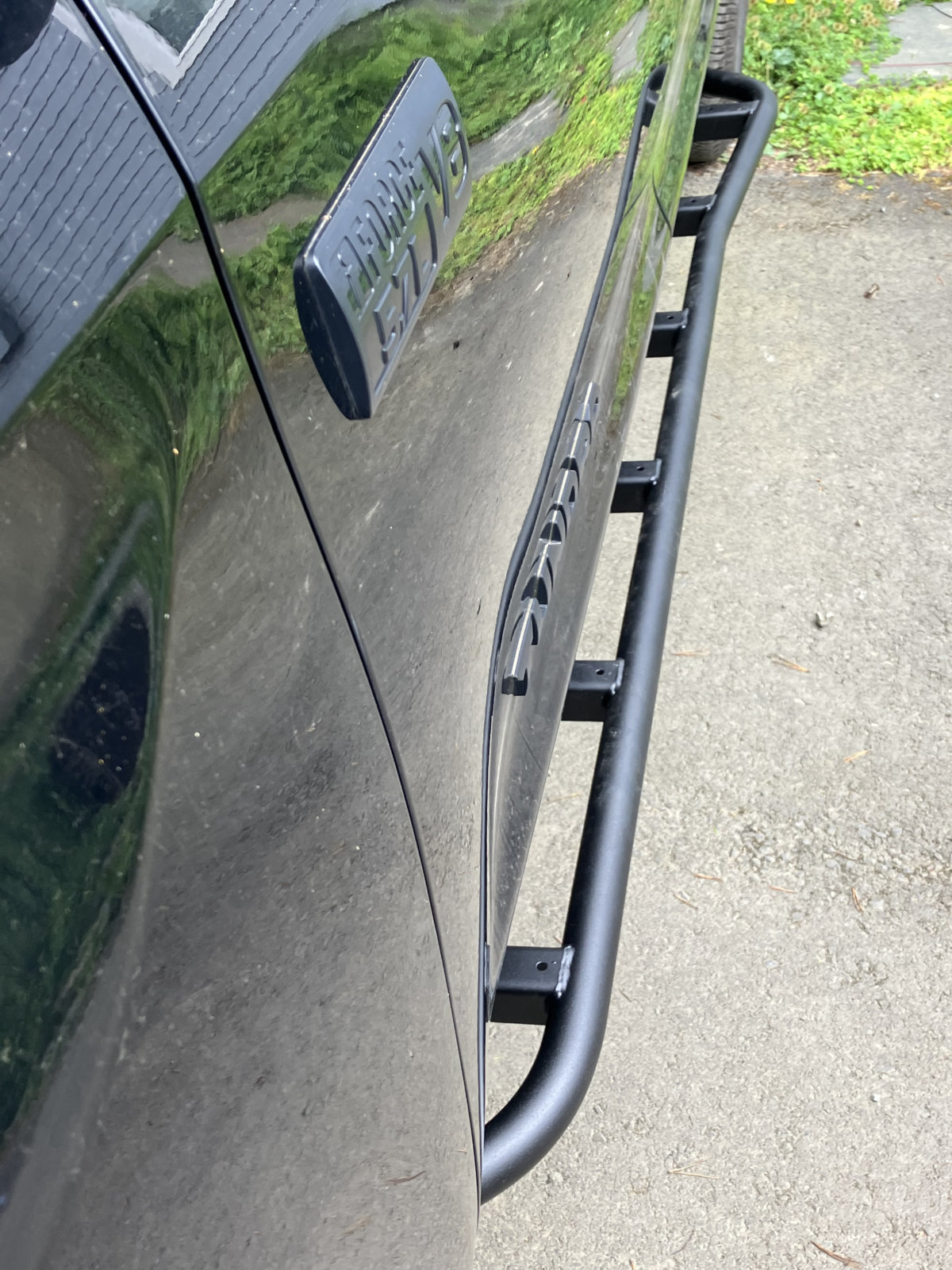

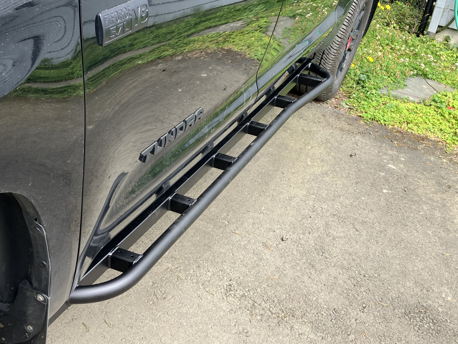

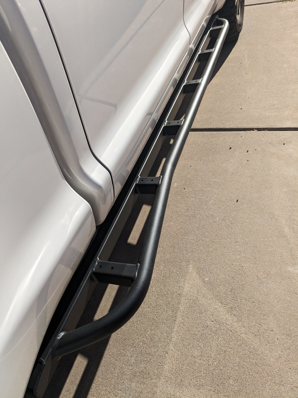

    In comparison to most vehicles (other than another lifted truck or such), you'll get very good protection from dings from other vehicle doors, shopping carts, etc... I've had no issues since installing mine :thumbsup:
    Tread plates are probably something you'll want if you're wanting little ones to have a clean step up at some point. I have no top plate on mine, and the wife still uses them as steps when getting in and out of the truck w/no issues.
    Here are a couple of photos to give you an idea of what the coverage looks like...
    A couple things to note:
    The 'kickout' sits at the back of the rear door and behind the door, so it's more helpful in dealing w/cargo in the bed and as an angle of deflection if being used off-road as an actual 'slider'...
    The sliders have a VERY slight upward angle which increases protection from dings and again offers a deflective angle off-road...
    When the doors are closed it appears that inner main tube/bar is tucked under the vehicle. However, when the door is open and from the following angle, you can see that the full width of the main inner bar and the outer tubes are available to use a step.
    As a caution, if you're somewhere w/freezing temps during the winter, without the top plates the powder coating on these things are super slick. If I lived somewhere that saw temps below freezing for any duration, I would've opted for top plates (I think you're already headed that direction in your thinking)...

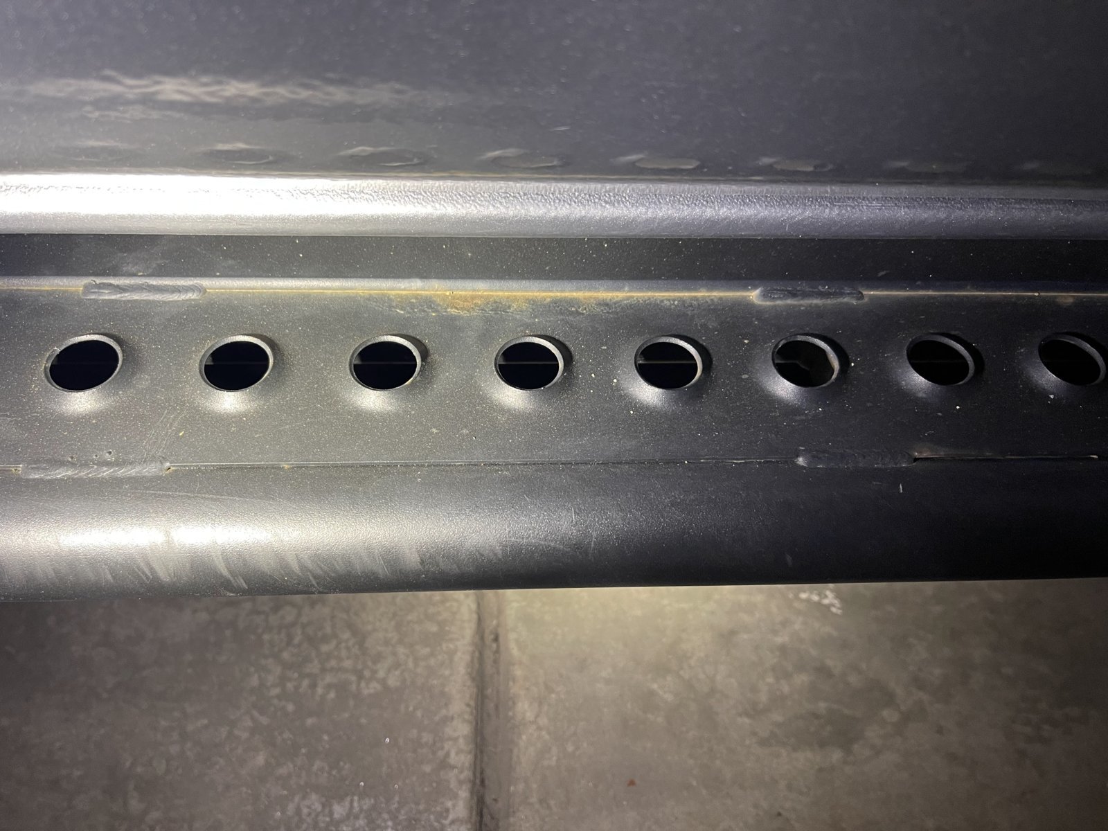

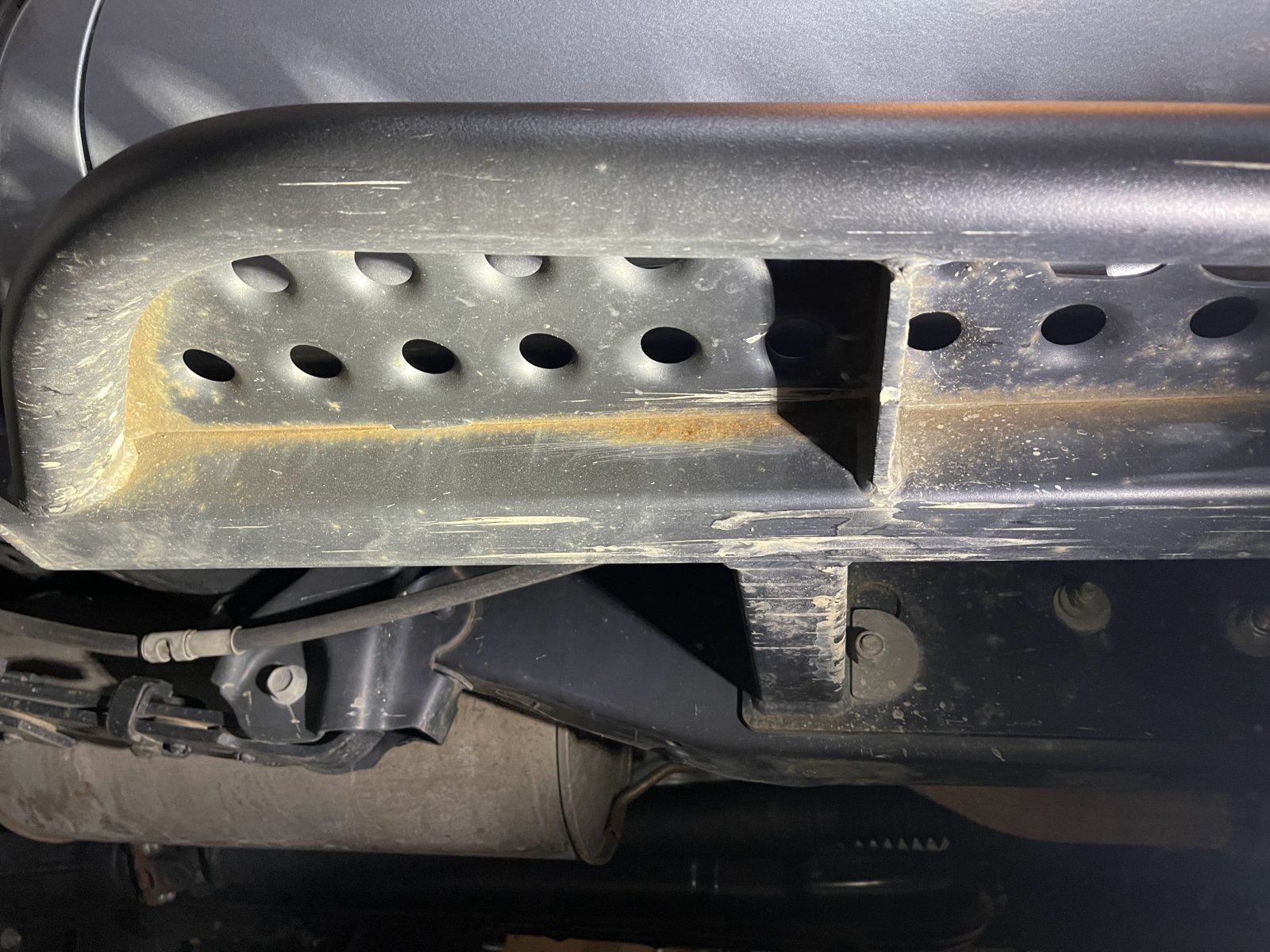

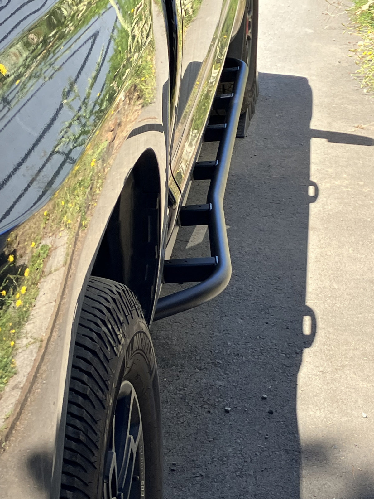

    Just a suggestion in case this helps -- spray the bottom of those RCIs with a rust protection spray if you get the top plate. RCI's powder coating is supposedly better than it used to be, but would suggest keeping an eye on it.

    That doesn't surprise me, given the geometries. It almost seems like a bolt-on treadplate solution would be better in this respect.

    Actually a member here told me today that they upgraded the design, and it’s now a bolt on top plate. Also the top plate doesn’t extend to the tip/tail now. There’s a gap on each end, so that helps with the debris that would get jammed in there. Good refinements!

    Those little mounting holes look like a good way to have water and debris enter the tubing... I hope you can seal them tightly. Definitely a good place to spray corrosion inhibitor.

    those crossmembers with the holes are c-channel exposed on the bottom and welded to the outside of the tubes, so there's no way for anything to enter those holes and get into the main tube ... if I'm understanding what you're saying correctly

    The tubing is not square framed. It's completely open on the bottom of those cross bars...

    Ok, copy that. My concern was that water could enter the (what looked like to my pre-4am brain) square tube crossmembers, not the main round tube.
