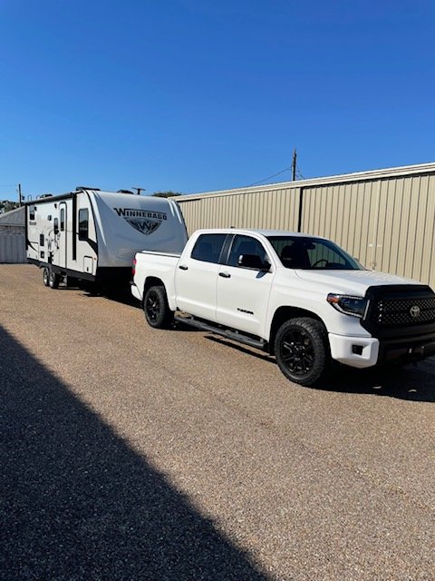

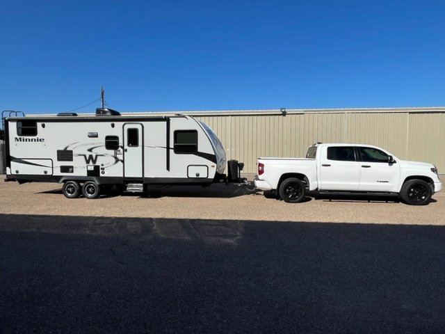

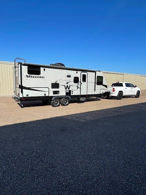

    I have the RAS-HD for the past year and regularly tow a 27' TT. I bought the HD because I'd rather "over do it" with the heavier loads I pull/ carry. I previously had Sumo Springs only but added the RAS-HD after their was still a bit of sag and I wanted true support for the suspension and leaf springs. Porpoising has disappeared since adding the RAS-HD and towing has been much more pleasurable.....I also always tow with a WDH.
