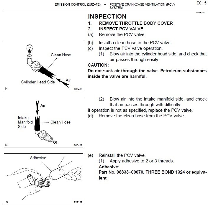

    How's the condition of you PCV ?
    Not that this will fix the problem but just a reminder that when a major component such as a MAF is cleaned,, especially in that condition, it's best to follow up with unplugging the battery for about 10 min. The ECU will then go thru a relearn process....idle speed, throttle position, fuel trim....etc

    PCV is original with the truck, I ought to give it a look

    Is this on your 03 w/110K in your profile or you also have this 05 ?
    ....and throw codes.
    As for PCV....pucker up or simply replace it if over 100K miles.
