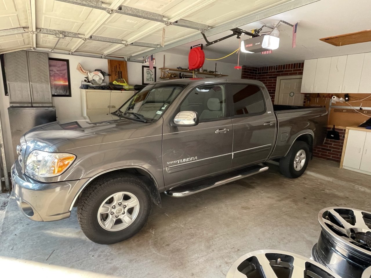

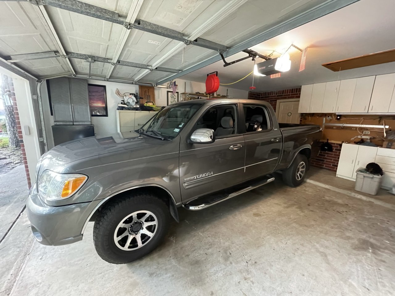

    I purchased my 2005 DC in February and am the second owner. I am extremely happy with the truck but the only drawback to me were the MB Wheels. The rims are nice but are not my style. I had been on the fence regarding a swap back to OEM wheels but I couldn't justify some of the prices that I was seeing. I have seen many Tundras with OEM rims that look really sharp in this forum, but I didn't want to pay the big dollar for them. I found a guy who had 4 rims for sale from his 2006 DC on Craigslist. On Monday, I went over to see the rims. They were dirty from being in his attic for the last five years, but I gave him $100 and took them home. I had the tires (265/70R16) swapped from the MB Wheels to the OEM rims on Tuesday. I cleaned up the OEMs and I couldn't be happier with the end result. The OEM rims are definitely for me. I like to see the Toyota emblem on the center caps.
    HBTundra, jimf909, Darkness and 2 others like this.

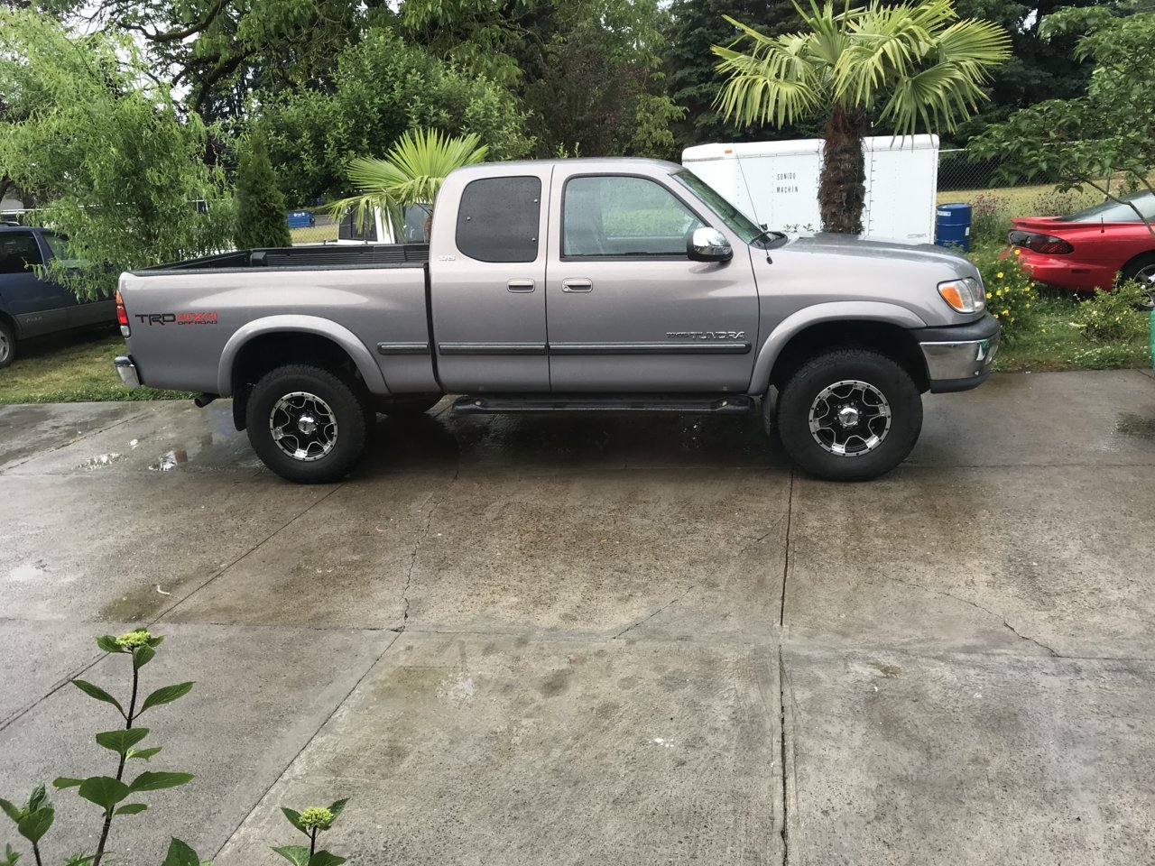

    On YouTube I see some tundra owners get Ultras. Mine came with the truck when I bought it so I haven’t been able to find which rims I have online. Ultra 6 spoke 16’ idk. Love how they look, but the only problem is I can’t get a conventional tire iron to fit in the lug slots.
