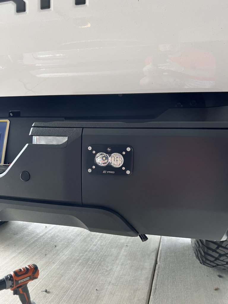

    Agreed with the above. Measure twice to ensure you don’t cut out a hole that puts the light where it won’t fit. I put BD S2s on my rear bumper.

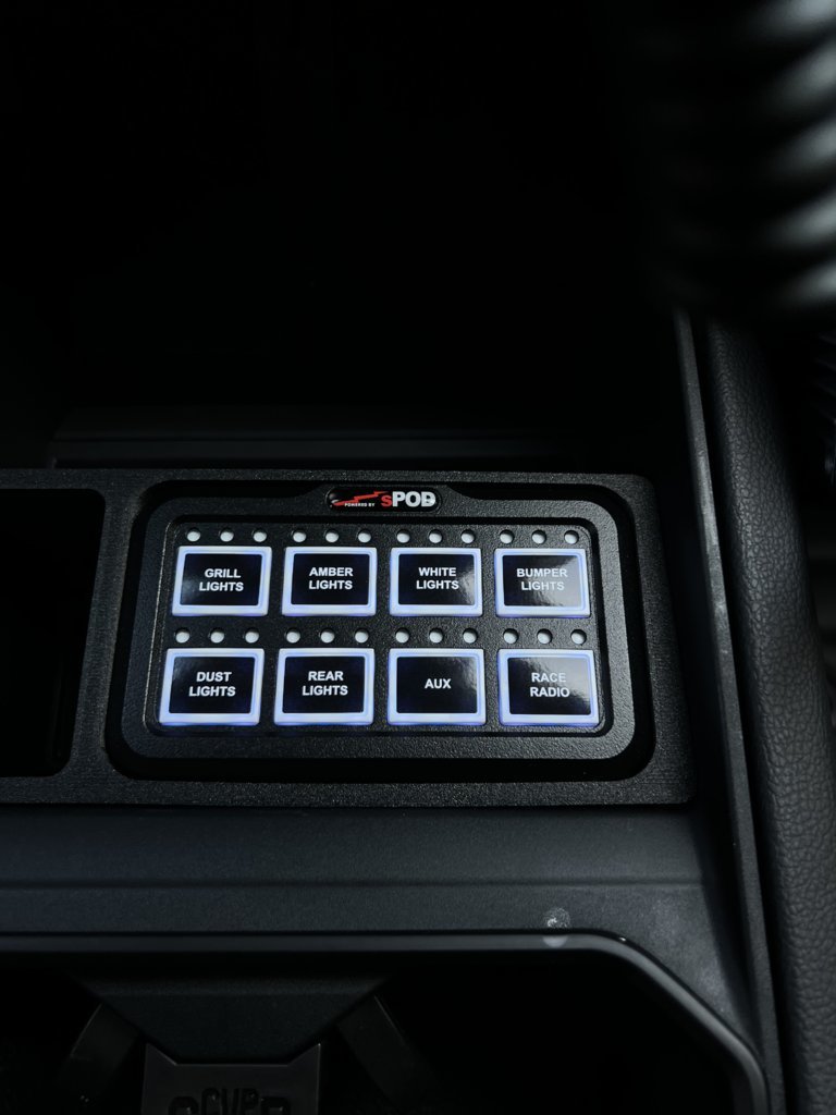

    I have all my lights wired to my sPOD. Made my own wiring harness and routed it forward to the engine compartment where the circuit board is located.

    Having a hard time seeing where you mounted is that near the cupholder?

    Yeah, in front of the cup holders. Had a flush mount 3D printed for it.

    Do you have a photo of where you mounted those rigid lights? I’m trying to find something tucked out of the way but bright.
