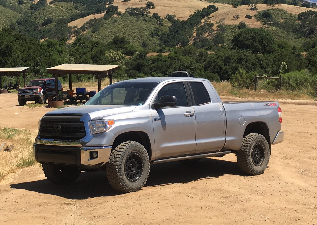

    Here’s 295/70/18 on 18x9 with +25 offset. This was on 3” Toytec Boss. Didn’t need a CMC but had to trim plastics.

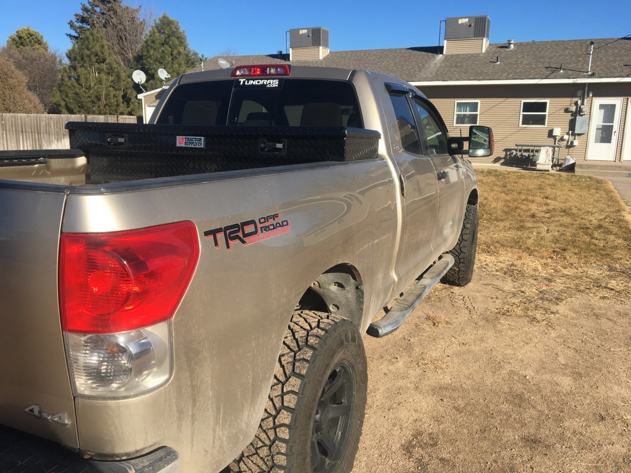

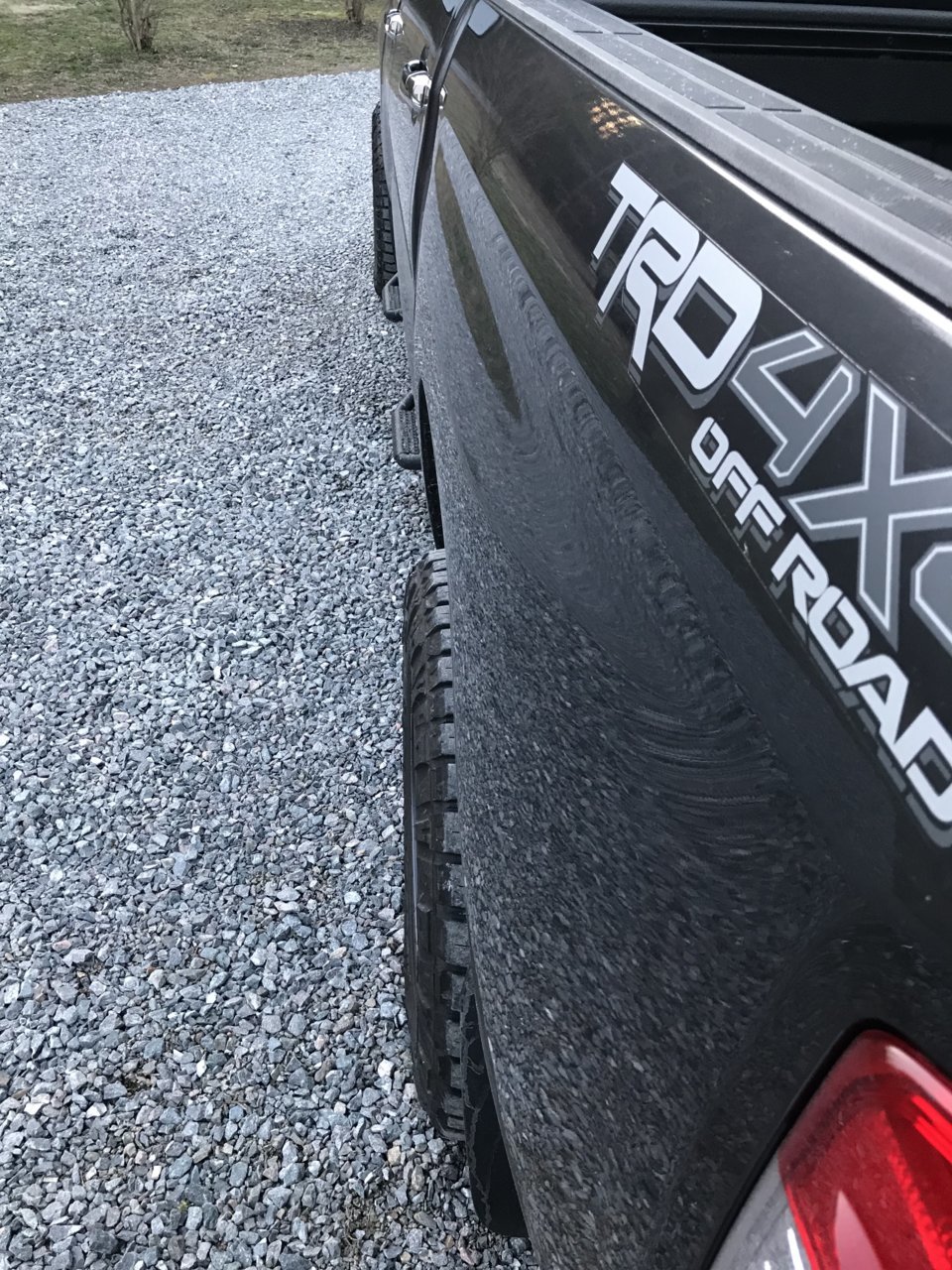

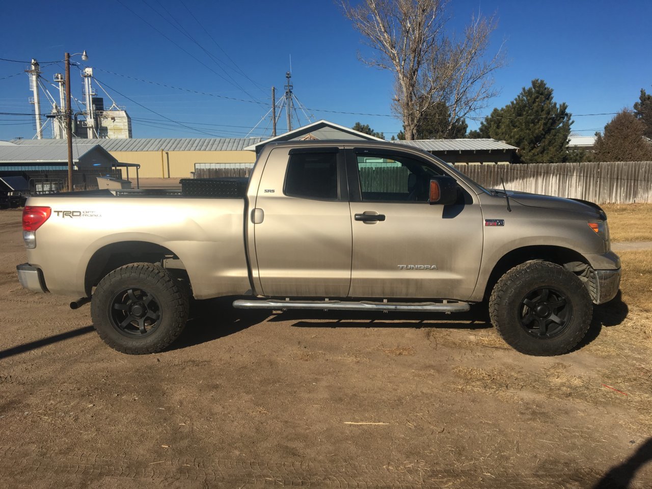

    You’re gonna have to do some serious trimming going with a -12. Stay in the +12 to +30 range for minor trimming, though your alignment figures do come into play as well. Here’s some crappy pics of mine, running a 3/1.5 suspension lift with 295/70R18’s on 18x9 FN BFD’s with a +12 offset.
    GNTundra, equin, 831Tun and 1 other person like this.

    Yes, zoom in on the second pic in my previous post. You can see how much a +12 will stick out on a 295/70.

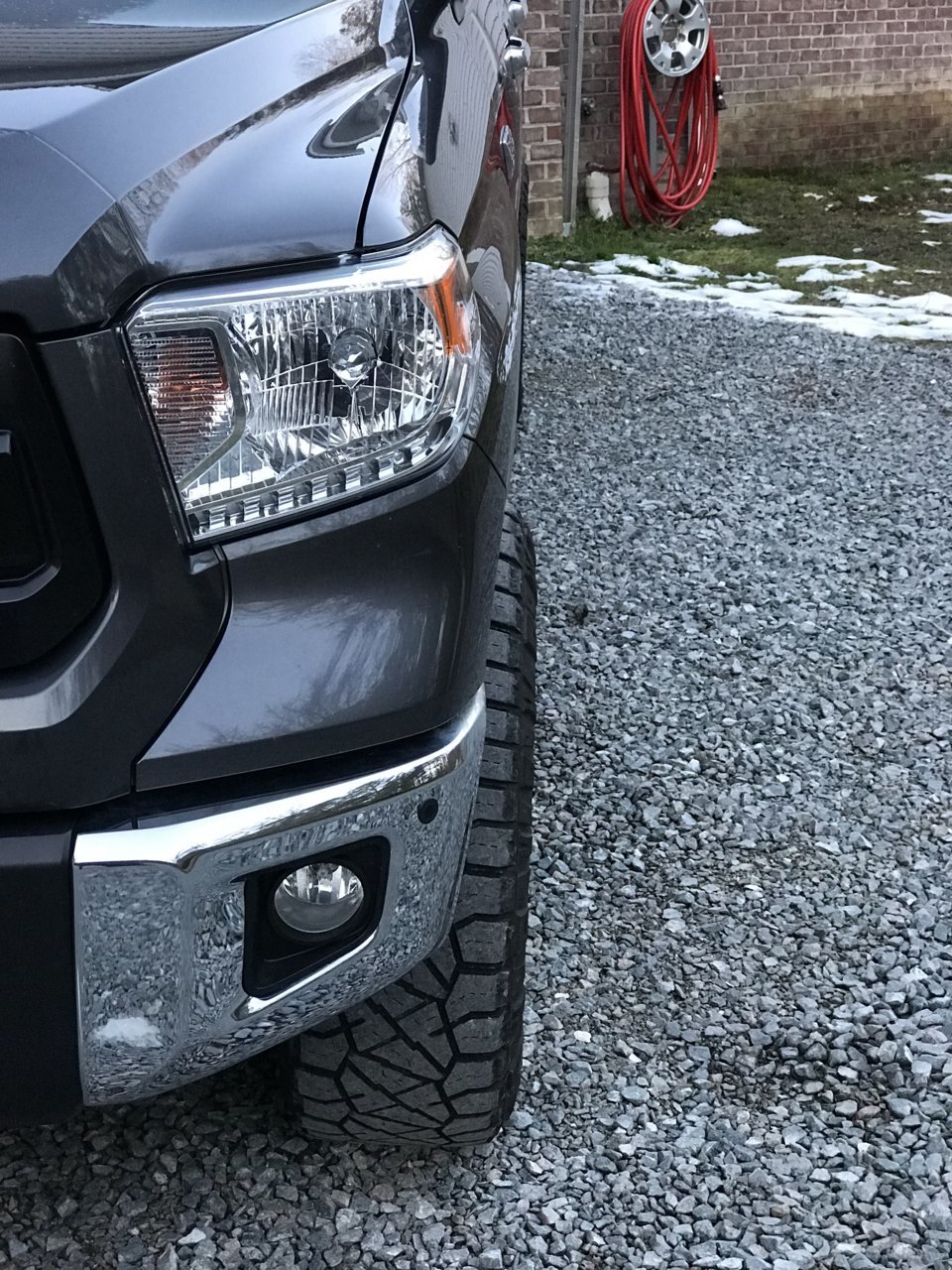

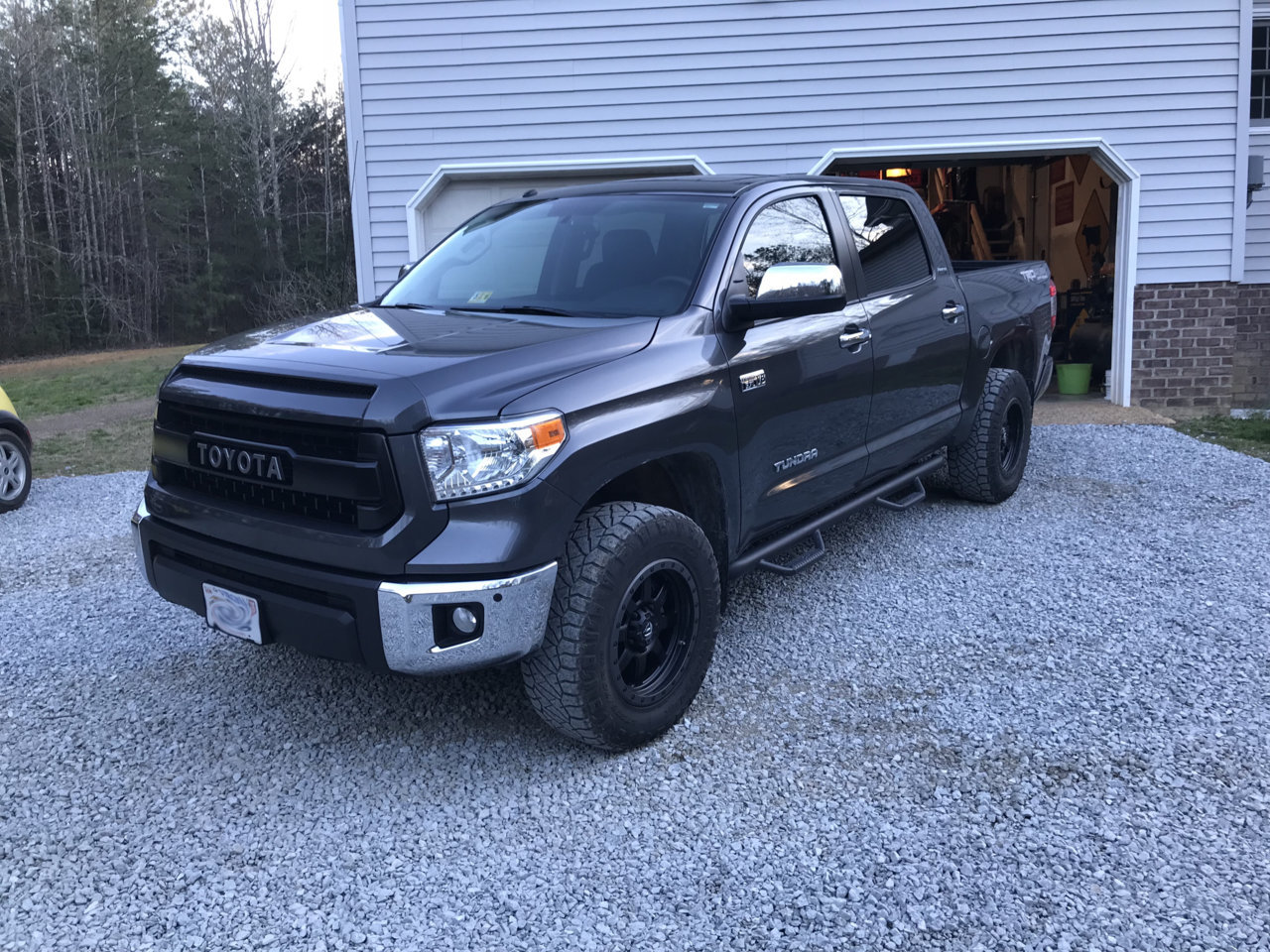

    Fuel Trophy +20 offset with 275/70 R18 Nitto RGs. (Bilstein 6112 @ 1.9) Not the greatest angle, but she's a little snow-covered at the moment. I get a little rub at full lock in reverse. Going to heat gun the fenderwells when the weather improves, but it all honesty, the rub isn't that bad. Anything bigger, and there might be a problem. The wheels stick out maybe a 1/2" from the fender.
    LawJ, equin and TssDriver21[OP] like this.

    That's a good looking set up man! I like it. Any way you could get a picture of the tires sticking out? If not no worries man, but i like it! Thank you for the help!

    Thank you! I'll get some profile pics and fender shots when the weather is a bit more agreeable. Right now it's a snowy mess outside.
    Hope this helps!
