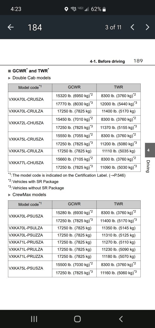

  10. Mar 14, 2023 at 2:34 PM
    GoFast157
    GoFast157 New Member
    Jul 7, 2022
    #80377
    70
    I'm guessing op's boat is less than 7k fully loaded with trailer. Still well within safety ratings.
    Pic from owners manual for reference.

  12. Mar 14, 2023 at 3:08 PM
    GoFast157
    Jul 7, 2022
    #80377
    70
    The more weight you add to the truck itself the lower the towing/weight capacity. I beleive this is the base load @Markysharky is referring to. For instance a 4wd crewmax with the 6.5 bed with all options will have a lower capacity (closer to the 8300 lbs rating) than a double cab 5.5 bed 2wd base model (closer to the 11000 lbs rating).
    In short no matter what option you pick with a Tundra you can tow that boat just fine. Of course adding passengers and gear you get closer to that number.
    And I believe the f150 has a slightly lower rating. :thumbsup:

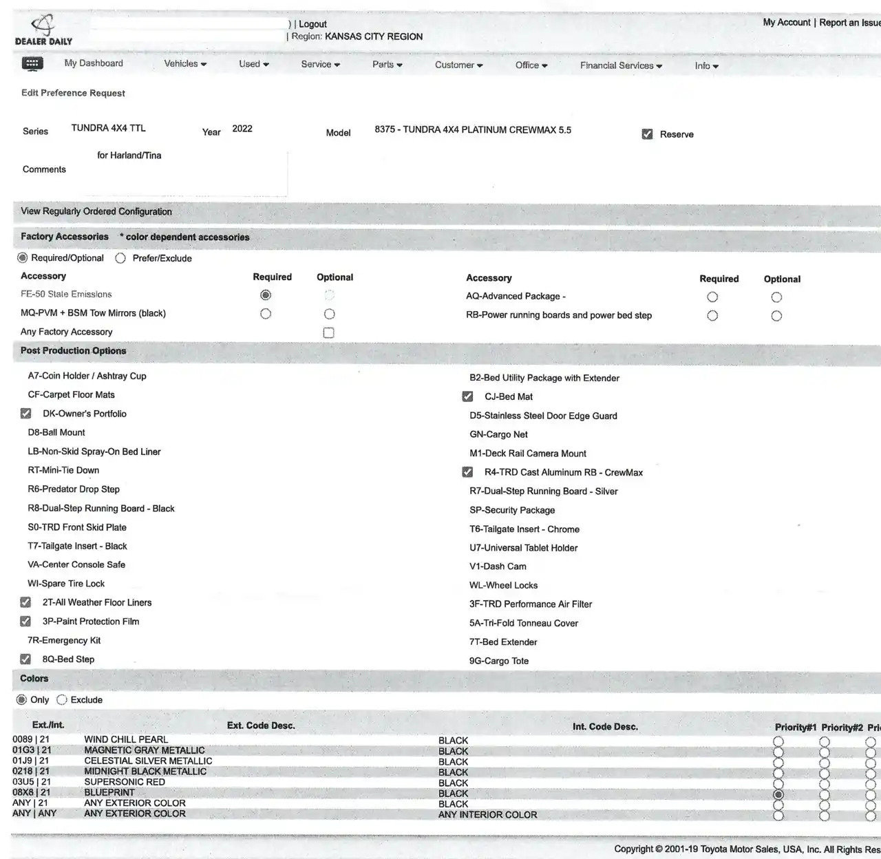

  19. Mar 14, 2023 at 3:26 PM
    nodak67
    nodak67 New Member
    Sep 7, 2017
    #9510
    3,282
    JR
    if you are looking for a platinum here are all the options for the toyota usa regions (excludes GST/SET) when the dealer selects your allocation reserve request check boxes
    post production is PIO (port installed options)
